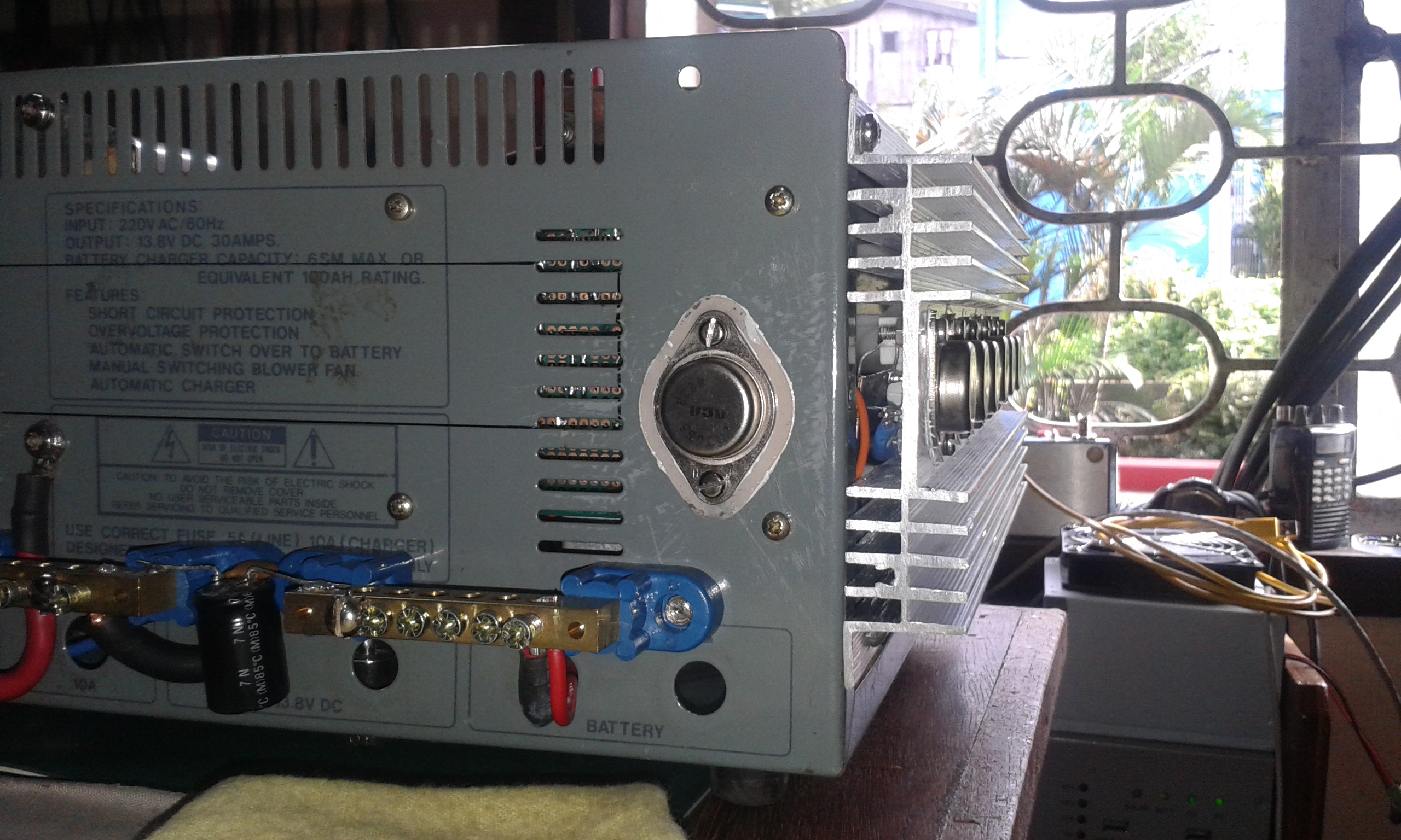

    I made a linear power supply for HAM Radio use. The transformer has a secondary voltage of 18-0-18 at 240VAC input. Transformer has no labels or markings except for the primary and secondary voltages. The secondary wire size is 3.5mm. The transformer core dimentions are 11mm(h)x 8mm(d)x13.5mm(w). So no idea how many amperes the transformer was. Anyway, I made a 13.8vdc psu base on an Astron RM-50M schematics. The only difference are the pass transistors as I can't source the 2n3771 so I used the 2N3055x6 with 0.1 5W emitter resistor. Power supply works ok except that the pass transistors gets pretty hot at 1min keydown at 100W. Heatsink with thermal paste applied. Heatsink thickness is 3mm with fins. Any advice, suggestions to improve is welcome.
    Thank you in advance.

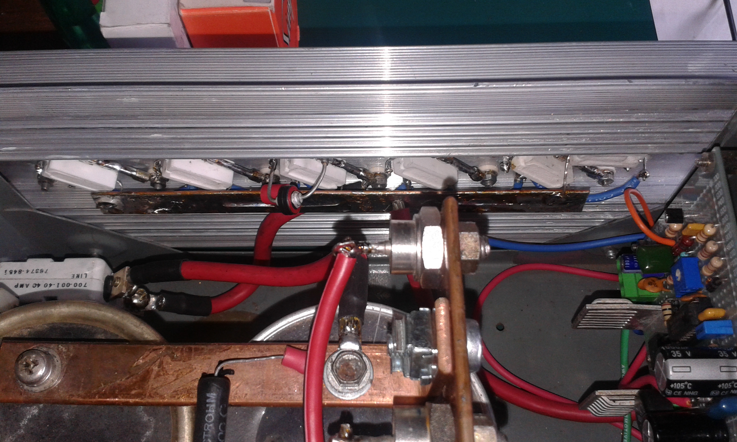

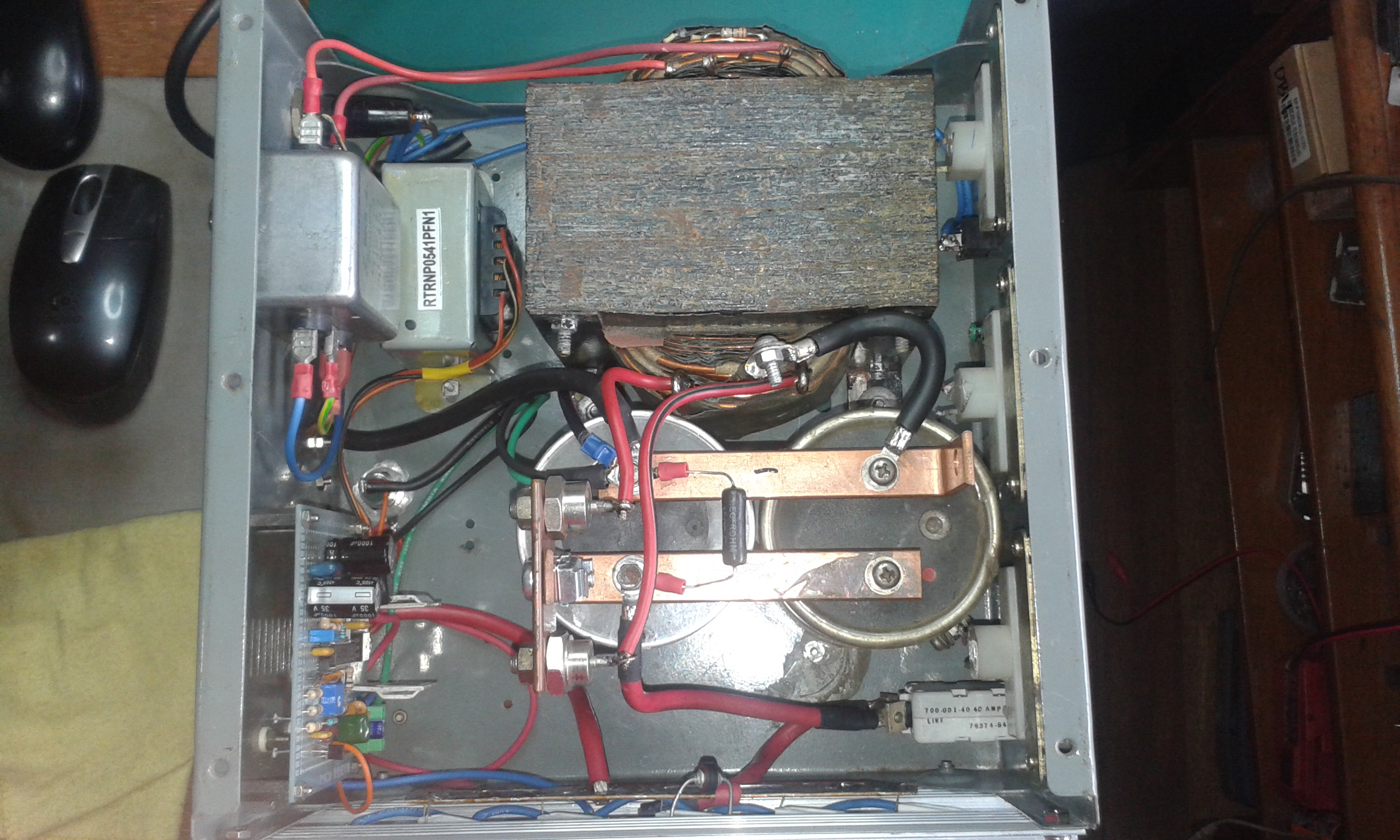

                  I used a Kenwood TM-281A at H power output of 65W into a dummy load. Here are some results of the measurements.
                  Between C and E: 10.2V with radio keyed, 12.5V unkeyed
                  Across the 0.1 Ohm resistor: 0.15 with radio keyed.
                  Temperature taken with a Fluke 287 meter and a Fluke 80BK-A probe: 140F 1min keyed.
                  Pictures of my homebrew power supply attached.

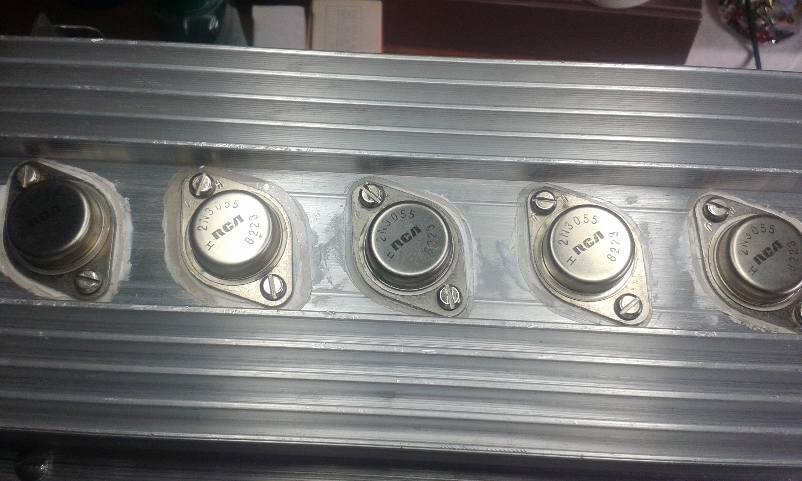

                    Let me first say that your PSU looks nice. Much better than my homemade PSU (and my PSU isn't nearly as powerful either, only 2A!).
                    That poor transistor on the back is going to hurt, as that one is the worst cooled of them all! Is it just that one that's heating up badly? Is it just the steel part of the transistors heating up or is the heatsink also heating up with the transistors?

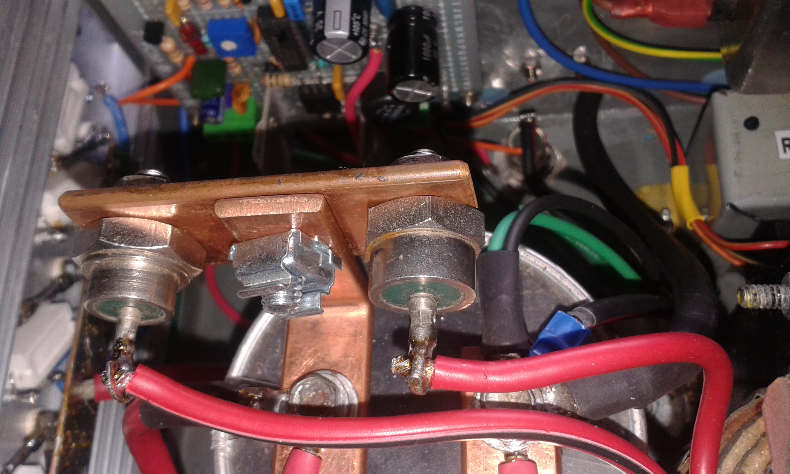

                    I also wonder if the diodes are hurting too, they would also be dissipating many watts too, but not as many as the transistors.
                    140°F is definitely in the concern zone but sort of expected with the current that's being passed. At 0.15V = I*0.1 I=1.5 amperes per transistor, dropping 10.2V =>15.3 watts (plus base current which adds another ~3%, so say 16W).
                    16W is a considerable amount of heat, and you have 6 of these transistors dumping 16W. Not sure if you've ever touched a CPU with the fan removed, they get quite warm too!

                      You must be referring the the single transistor at the back just above the output terminals. It warms up a bit but not much. This transistor is the Q100 that drives the base of the pass transistors. It is not part of the 6 pass transistors. The heatsink and pass transistors has almost the same temps when measued. The rectifiers are just warm being fitted on those copper bus bars.
                      Oh yes, I have been repairing computers before and have seen a cpu really smoking without the heatsink and fan.
