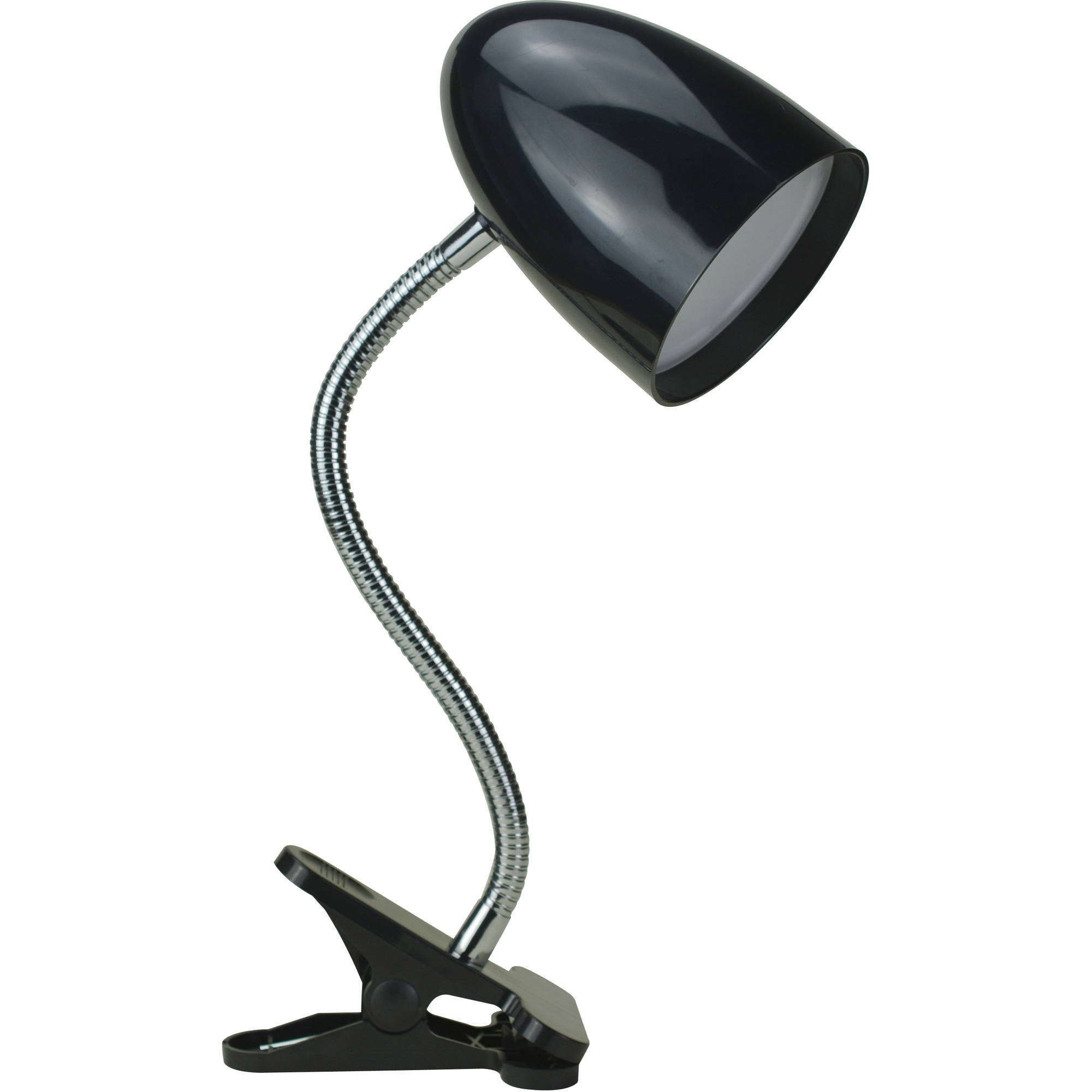

    I found these LED lights at Walmart for $3.50 Clearance priced
    I know ( I have to hit the Clearance items just about every time I am in this store )

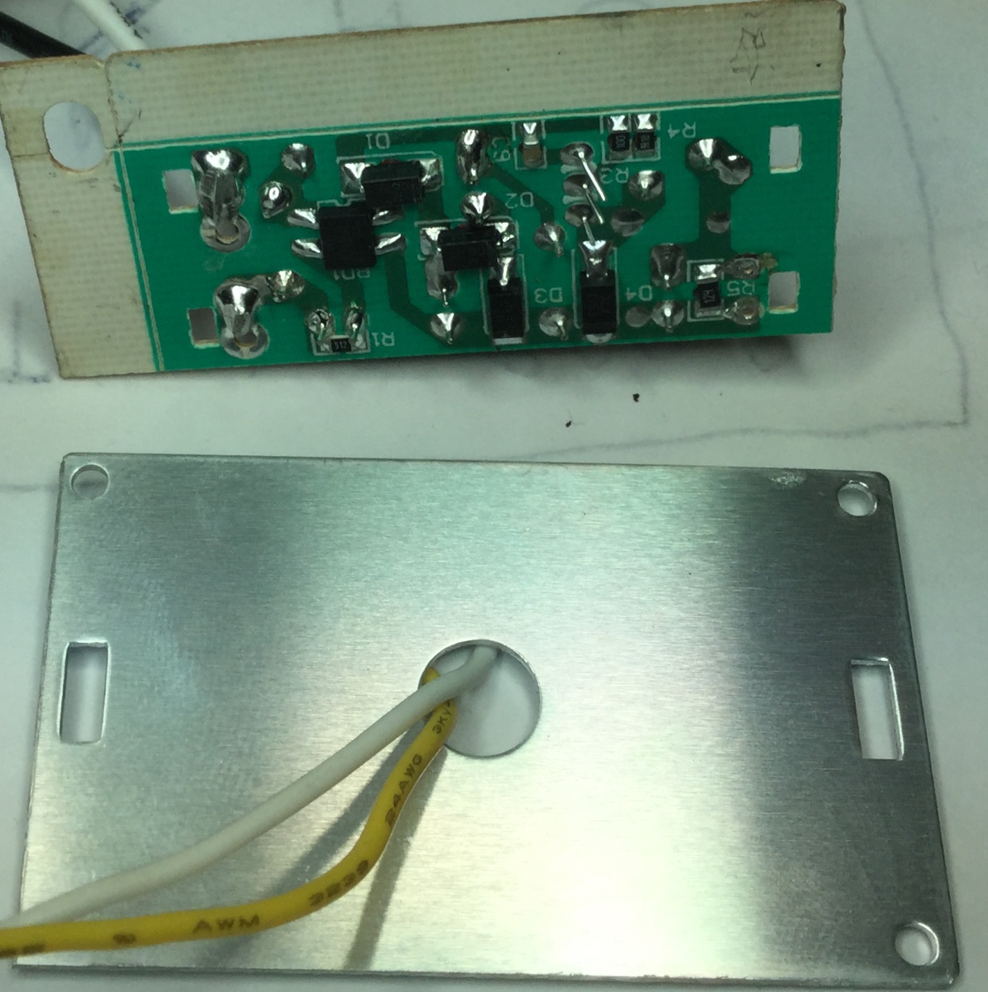

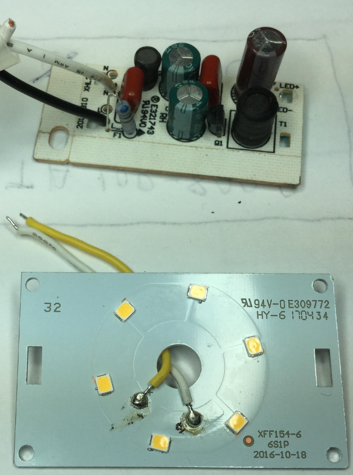

    I took one apart it does not have the best power supply board but the LED module is very nice with heat a sink
    I bought 11 of them for a lighting project I going to do very soon
    The bendable flex rod is very nice the biggest complain is that the clamping clip is made of plastic
    Which probably only for a little while the plastic cover for the LED module and switching power supply is made from same cheap plastic
    The plastic that on this item is crap to say it nicely

    It looks like line operate non-isolate single transistor buck converter, fusible resistor for the AC inout protection, since the 6 LEDs are connected in series, the output is around 18V or so.

      BTW, since those LEDs are mounted on the heatsink, if there is insulation breakdown on that heat sink, the heat sink will be at Line Voltage so be careful on how you handle the heatsink.
      I wonder what AC V you have if you measure between safety GND and the heatsink.

        No the operating voltage is 49 to 51 or so volts not 18 volts
        The ( LED module ) has 3 small LED in one module is my guess
        The out put cap is rated for 160 volts DC on the power supply board

          Here is a photo of the box
          I have a correction to make on the voltage for the LED module at 48 volts it is than 10 milliamperes at 51 volts the milliamperes is about 20 and dose start to get warm
          The power supply that I am using only goes to 51.5 volts
            Here are the results of this test
            At 48 volts to run the LED module one lead of the meter to the heat sink and the other lead to the positive terminal of LED module there is a little over 12.5 volts
            This is a good reason not run this LED module on this type of buck converter
            When I look at this power supply module I had not seen this setup before and decided not to use them for my lighting project
            Thank you for pointing out what type of power supply this is and the part about leaking voltage to the heat sink from the LED module
            Now if you were to use it way it build it might not be a problem
            But I am going to mount these LED modules in a metal housing
            this would a problem
            I going to a insulation disk that are used in mounting t220 devices to heat sinks
            to keep from having problems with voltage feed back to the power supply

              Testing the AC Voltage as in original power supply you want to test is between heatsink and AC outlet safety GND, not to the LED connection.
              If you are going to mount in the metal case then you need safety GND which will be 3-prong AC plug unless your power supply is well made.
              Use current limiter of some sort, do not connect the LED to the power supply directly, the current draw of the LED is not linear, it will not take much Forward bias Voltage increase to shoot up the LED current draw.
              You should measure the current draw of the LEDs as they are with its power supply to find out what it is first since we do not know the spec of the LED.

                  power it up with the original supply, and read the voltage across one led.
                  then multiply it by 6.
                  then set your meter to current and put the probes across one led - see how hard they get driven.

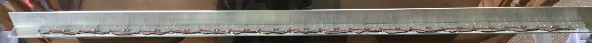

                          I have made a light bar with these LED modules that I got from Walmart for $3.50 each there 18 LED modules
                          This light bar is for my new table that I made for my shed

                                Here are the results of the LED module has
                                The following
                                51 volts @ 62 milliamperes
                                51/6=8.5 volts @ 62 milliamperes
                                So if the Individual LED has 3 small LEDs in it 8.5/3=2.333 I have seen some white LEDs that there work voltage is 2.3 to 2.5 volts these are not normal
                                Which really does not make sense at all 62 milliamperes for one single LED on this module the heat sink could not handle that heat it gets warm very quickly I checked
                                I will be running at 48 volts @ 20 milliamperes which more realistic for this heat sink
                                I was going to use one of these for a night light but now I do not think so with out modificating the power supply or something

                                    What does the DC meter show when you measure the DCV right between the two legs of each LED?

                                        You can easily see the solder joint of the LED, especially the one that is connected directly to the input wire.
