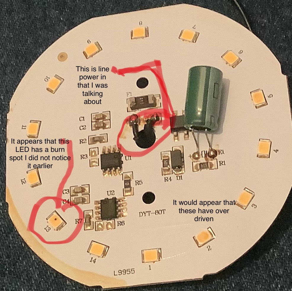

Light that has a bug zapper in bottom section of light fixture the LED light module took a crap but the zapper still works
    • Jul 2011
    • 6070
    So I got the bright idea to remove the LED light module from the fixture and put it on top of another enclosure and keep using the zapper
    The removal of light module was a successful and now I just have to cut a hole in the enclosure and put a power cord that has an on and off switch on it
    You are lucky to get about two years of service out of one before the LED module starts flicking and just stops working because it is mounted on an aluminum plate and these are hard to solder on it and it is not worth messing around with them and especially this one because it has line voltage on it and I am not in favor of messing around with it for this particular reason
    I have bought several of them in the past and the way it fails is all ways the same it first it just blinking every once in a while and as time goes on it flicker every once in awhile then it just flickering all time and then it just refuses to come back on
    Now what is interesting about the LED light module on the bottom does not have this issue it always works fine with no issues
    I will post some pictures of it when I finish the enclosure and put the power cord with the on and off switch

      It could be but what I do not like about this particular one is that the section where the line voltage goes to the board and these wires are too close to each I guess I could screw around with it with the use of a incandescent light as a current limiting device but these LED light bulb module is crap because everyone of has failed the same way there are several surfaces mount ic chips on this board I would not be surprised if the part number have been removed so they can not be read
      I will take some close up pictures of this board and make sure that it can be read
      One note these LED light/bug zapper are around $20.00 when on sale and around $25.00 when they are not on sale so they are so cheap they they are not worth spending much time on these LED light module one note it does not appear that these are being over driven because it is not extremely bright so what I am leaning towards is the LED light bulbs must be very low quality ones or the aluminum heat sink is not thick enough for the surface mount LEDs or a combination of both

          Here is the picture that I promised to post on this LED light module it appears that these LEDs have over driven because one of them has a black spot on one end of it see in the picture and it has text on the picture
            • 31316
            thats the guts from an led lamp,
            those only last 6-9months for cheap ones.
            so what colour did it light?
            that is normally on an aluminium cone to disperse the heat

              Warm white is the color
              I have had LED modules last longer than this on aluminum plate then this must be crape LED surface mount modules or they are driving them to hard
              I know that the aluminum plate is to dissipate the heat but this is very thin I have seen thicker aluminum plates for aluminum plate heat sinks I guess when you only pay $20.00 when they are on sale you get what you paid for which is not much life
