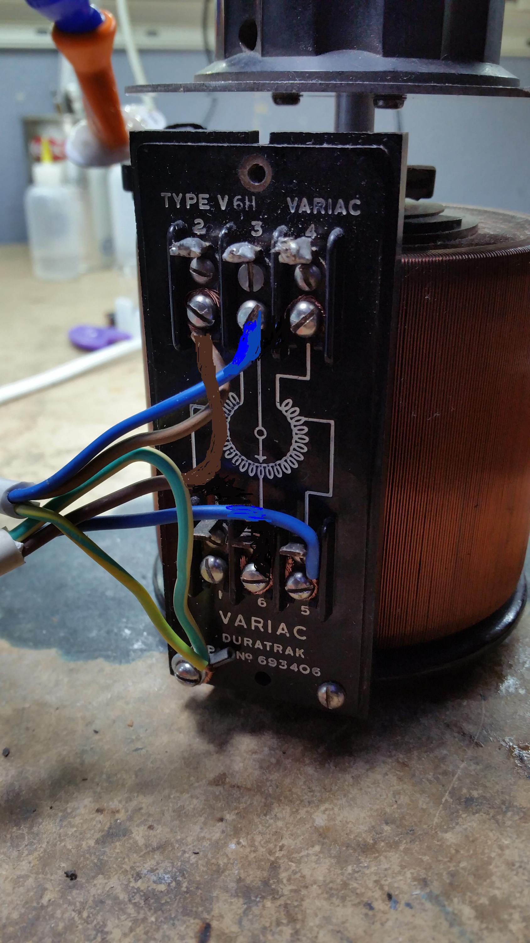

    Wiring up a variac.
    I have bought a variac and have wired it up as per instructions given but I'm only getting 90v output wherever the wiper is. Clearly I've wired it up wrong, but I can't see how. Can someone point out what I'm missing please. Thank you.
    I was instructed power comes in at the top and out at the bottom, but looking at the cover i'm not so sure this is correct.

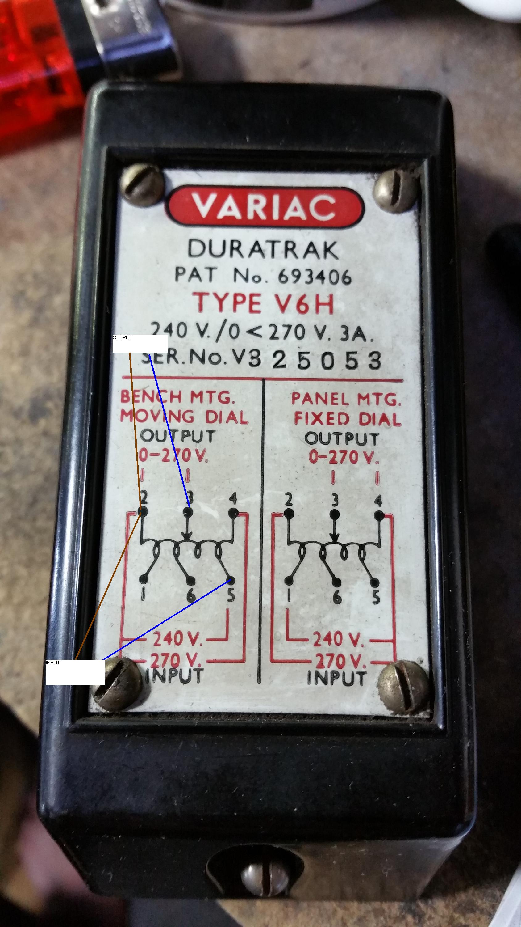

    Look at the diagram, you have nothing connected to the wiper screw (3) You don't have the primary connected to screw (1) either. LOOK AT THE DIAGRAM
    INPUT: across 2 and 5
    OUTPUT: across 2 and 3
    Why did you connect to 6 and 5 ?
    Wired like this and with 240v input you might get close to 270v at the output if you turn it right up
    Also remember this is an auto transformer, not an isolation transformer
    The way you had it connected it was acting as a step down auto transformer, 240 in 90 out

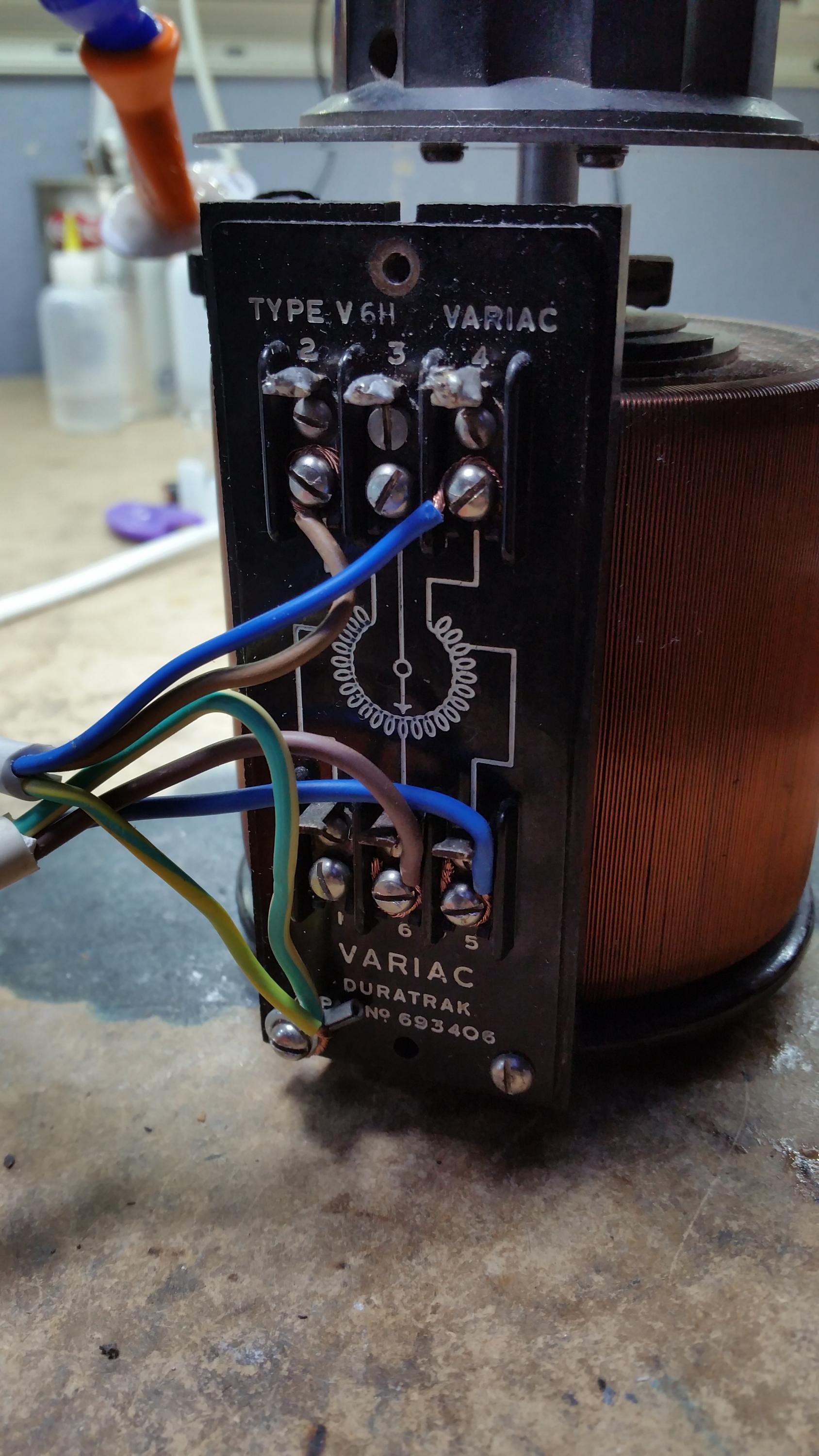

        Thanks RJ, once you point it out, it's obvious, thank you, re-reading the provided instructions I see where my confusion about the centre pin occurred.
        The vendor mentioned it wasn't an isolation transformer also, but I have one of those.
        That was the buyer I bought from vinceroger69, it confused me a little as the instructions didn't align with what I was seeing. looking at it now I understand what's going on, it was wired up for 270v before.
