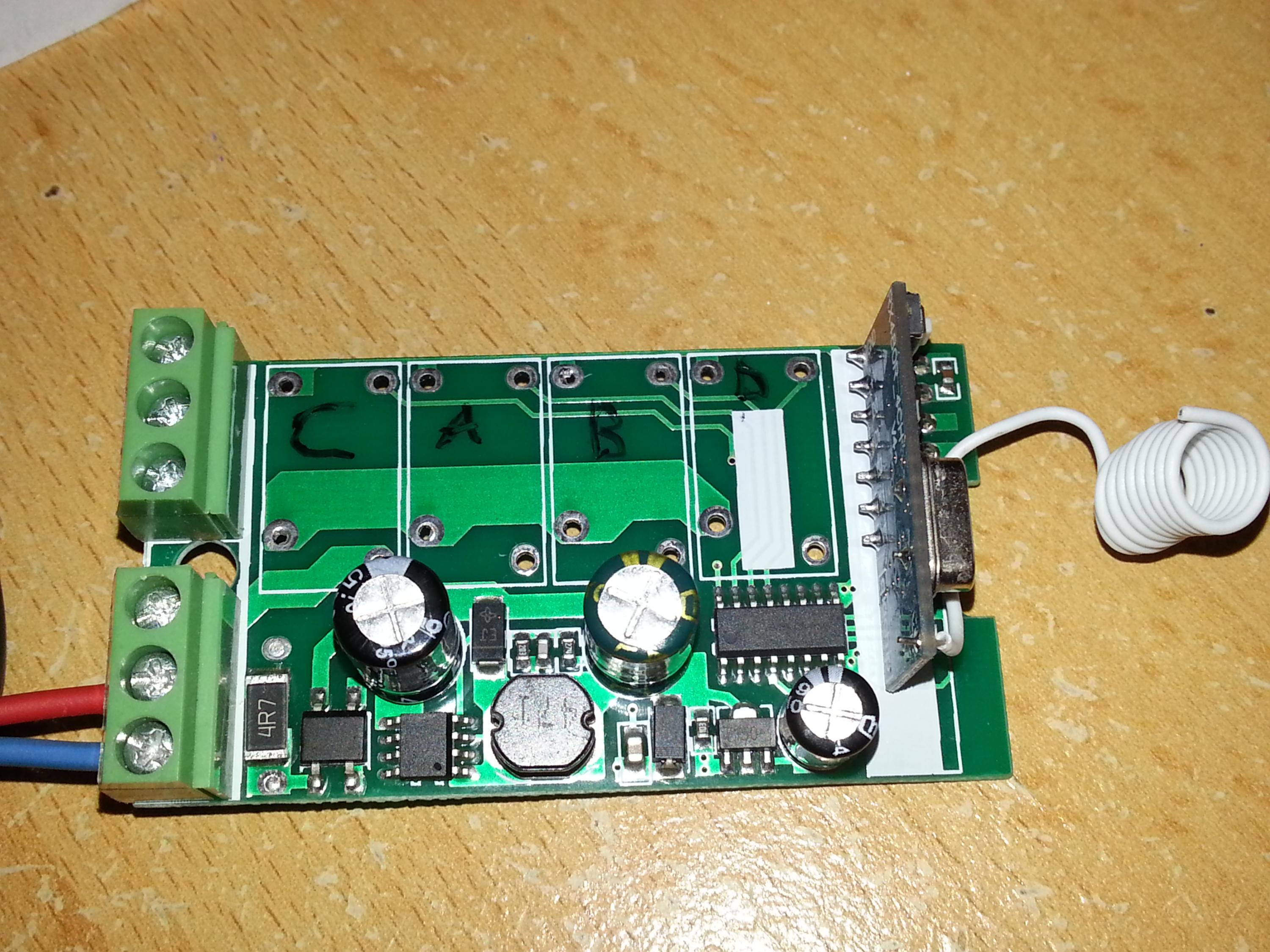

                  • Dannyx
                    CertifiedAxhole
                    • Aug 2016
                    • 3912
                    • Romania
                    #29
                    Re: 555 countdown timer design question
                    Originally posted by stj
                    what's the end product?
                    is this related to the remote controlled corridor illumination thing?
                    Yes it is. For this reason, it doesn't have to be uber-precise (just in the ballpark as they say). We're not building a time server here - just switching on/off a lamp. It certainly helps if it IS precise while still keeping a minimum of parts and complexity....though it's probably not possible

                        the reason i asked, you can get a microcontroller module with built-in wifi for a few $ and just add a 5v psu and a solid-state relay.
                        then control the light from a fone.
