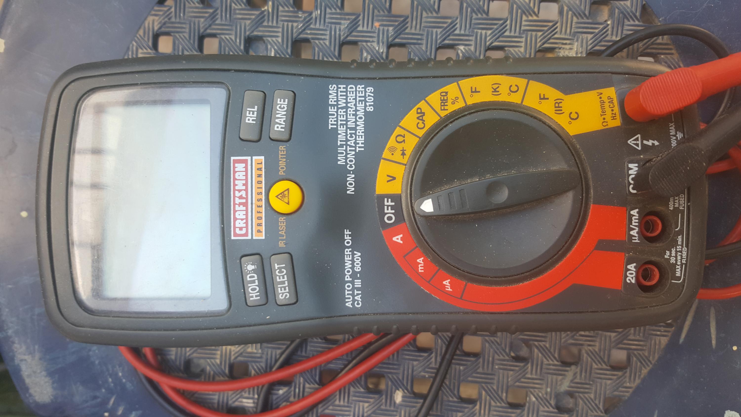

    How to test/check ic chip?
    Is there any way to test/check an ic chips?
    I have only AVO meter, no scope or anything like that.
    Thanks in advance.

      Re: How to test/check ic chip?
      So the only way is to replace them and see if the circuit board is working?
        you could check voltages against schematic
          My simple answer is also no.
          Sometime you may be able to test for internal shorted circuit of the IC if you know what are inside the IC.
          For example: the SMPS IC with integrated power MOSFET, you can check to see if the MOSFET is shorted or not with meter.
          Voltage testing also help in verification of the IC.
