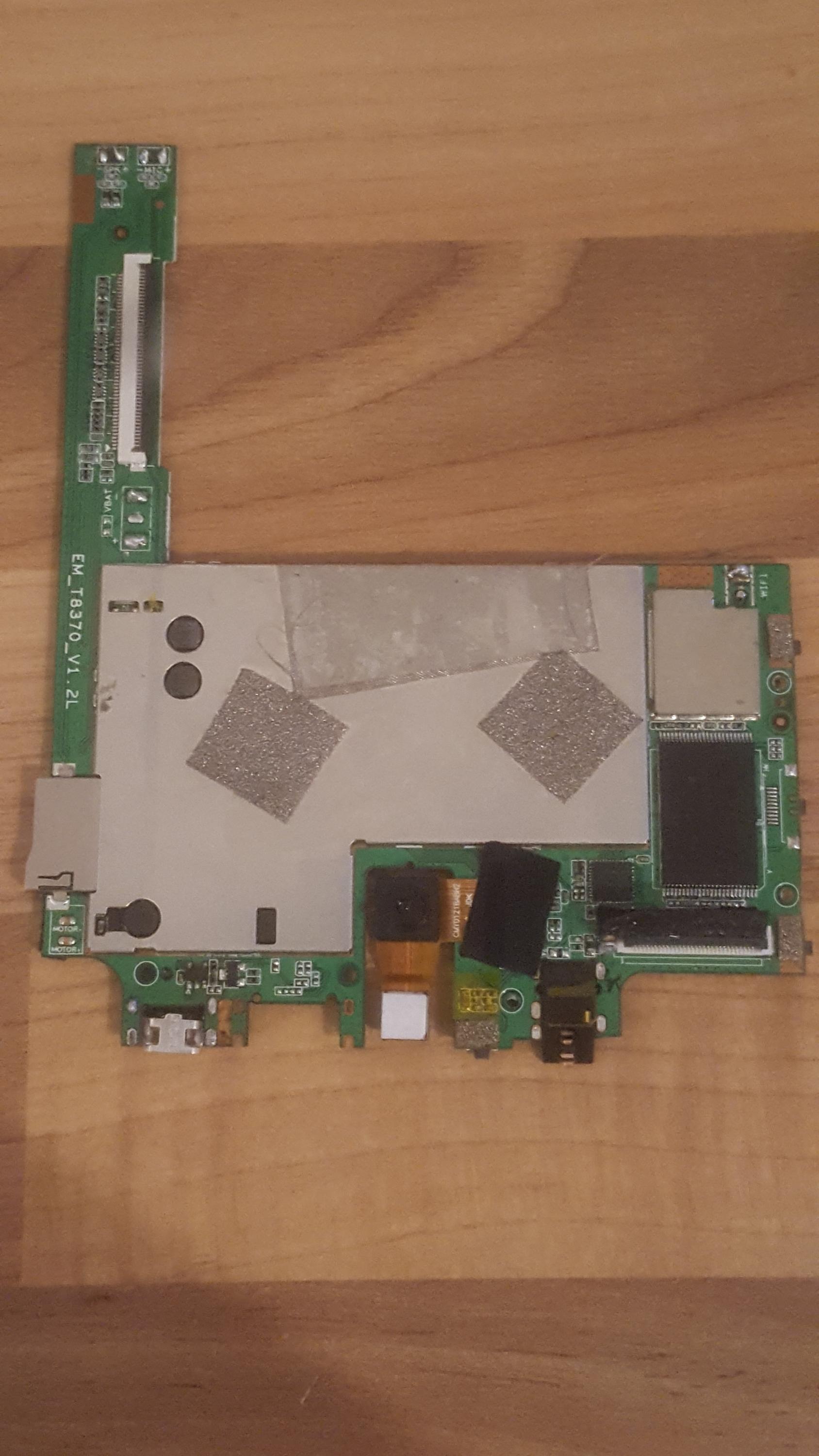

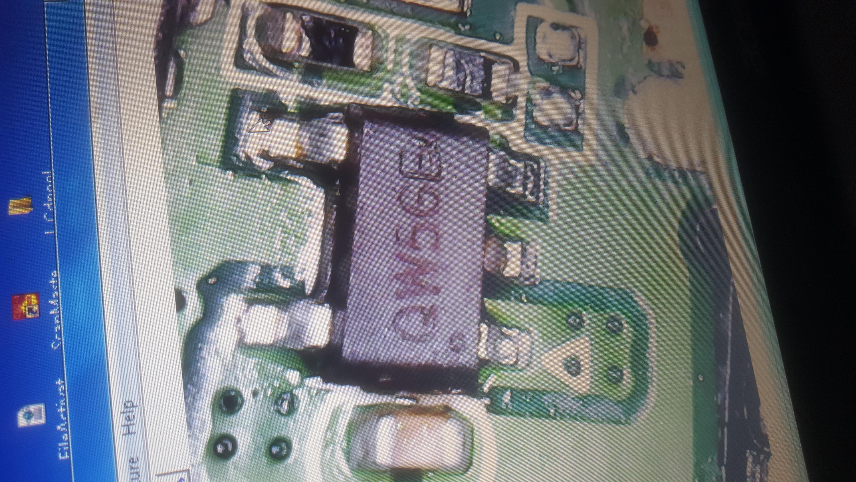

    Hi there im trying to identify this chip but i cant identify it or find any datasheets on it..its on a tablet charging circuit and it heats up so im trying to replace it but cant identify it.
    any help would be much appreciated
    image attached

        It means your photo is still in someone's server , with some restrictions for non members like us . You should download your photo to your system first .
        Can you highlight what's written on the chip ?

          it says qw5ge or possible qw5gf

            Very difficult to locate , but it's a Sot-23-5 package , most probable a low DC-DC converter .
            I'll keep searching anyway .
            Usually the qw is the product code and 5ge is the date code , not much of help without a schematic or previous encounter .

                May be you should zoom out the picture to show more of the board then we may figure out what its function is.
                What is the product and what board does it come from?

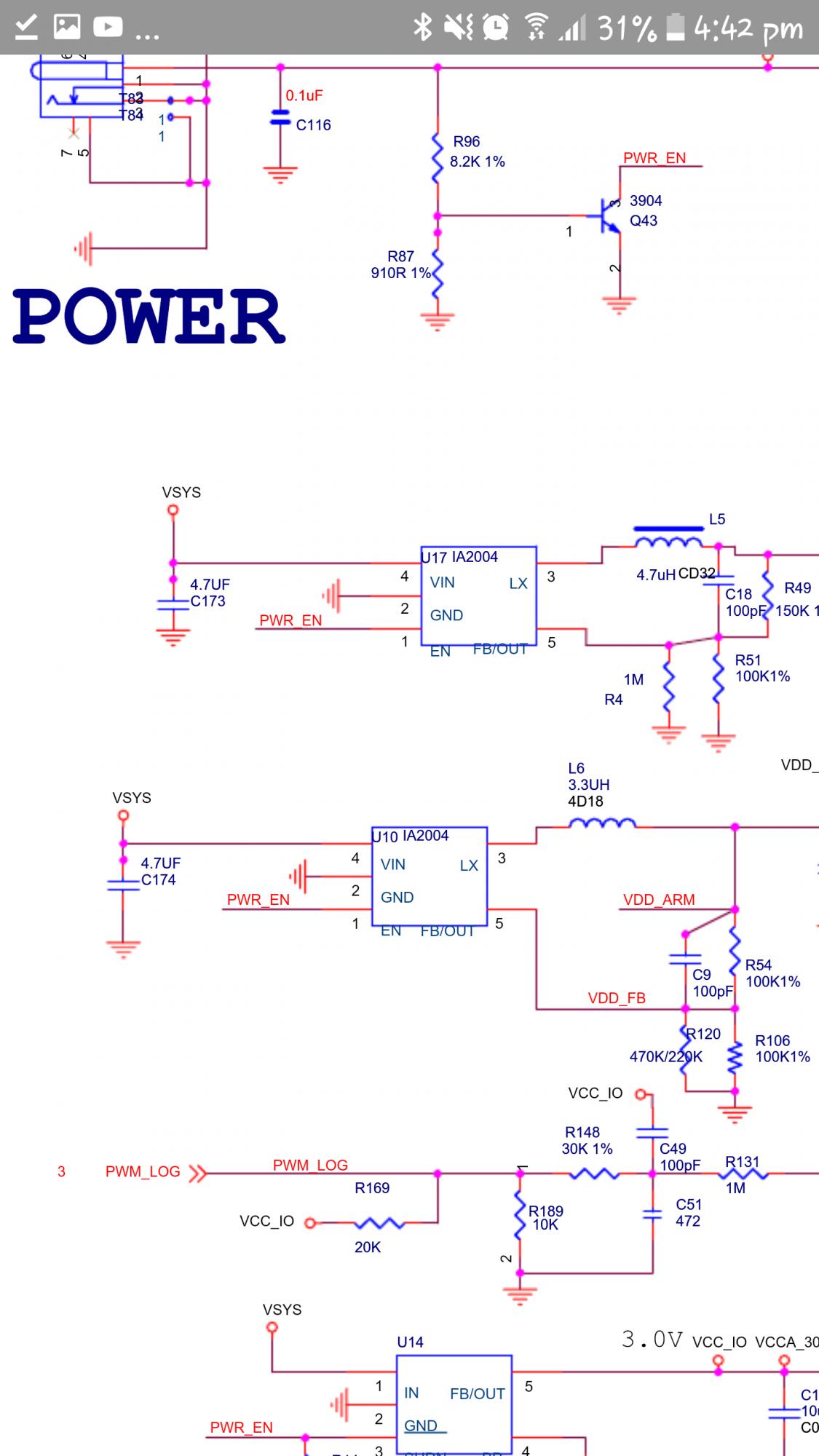

                  i found schematic for it
                  Your never to old to learn
                    Re: Cant Identify chip ( help)
                    So which U is it?
                    How about showing the whole schematic or upload it?

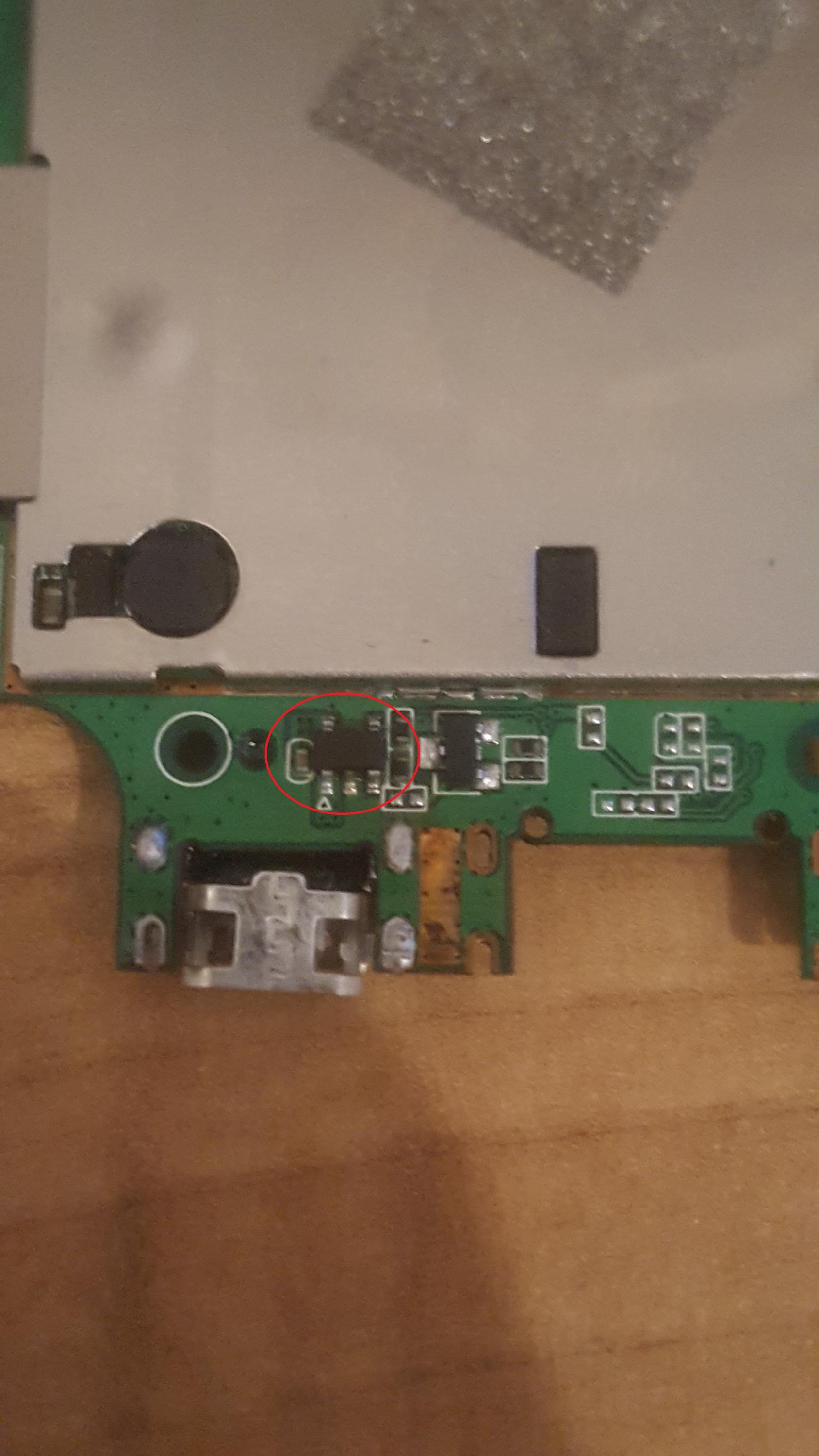

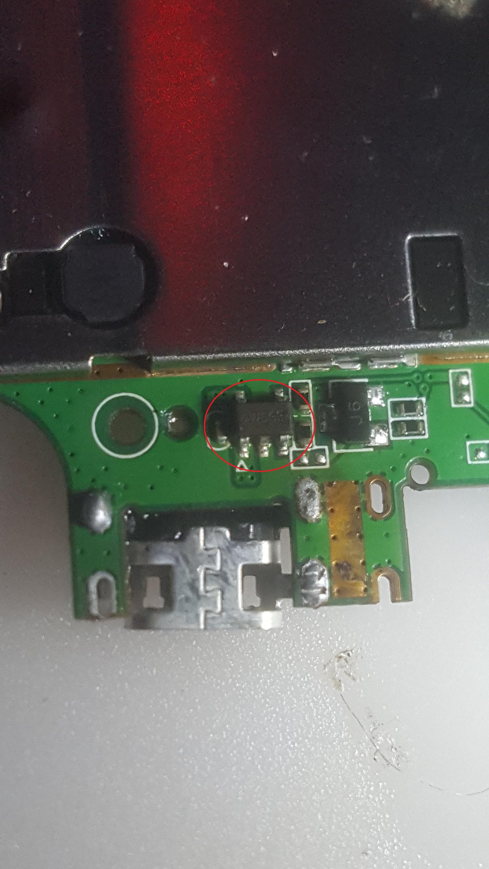

                      sorry it was the wrong schematic iv attached more pics and its from a alba 7" tablet model no ac7oplv4.

                        this site talk about QW5DA, could be the same part https://translate.google.com/transla...50&prev=search
                        R1210N351C
