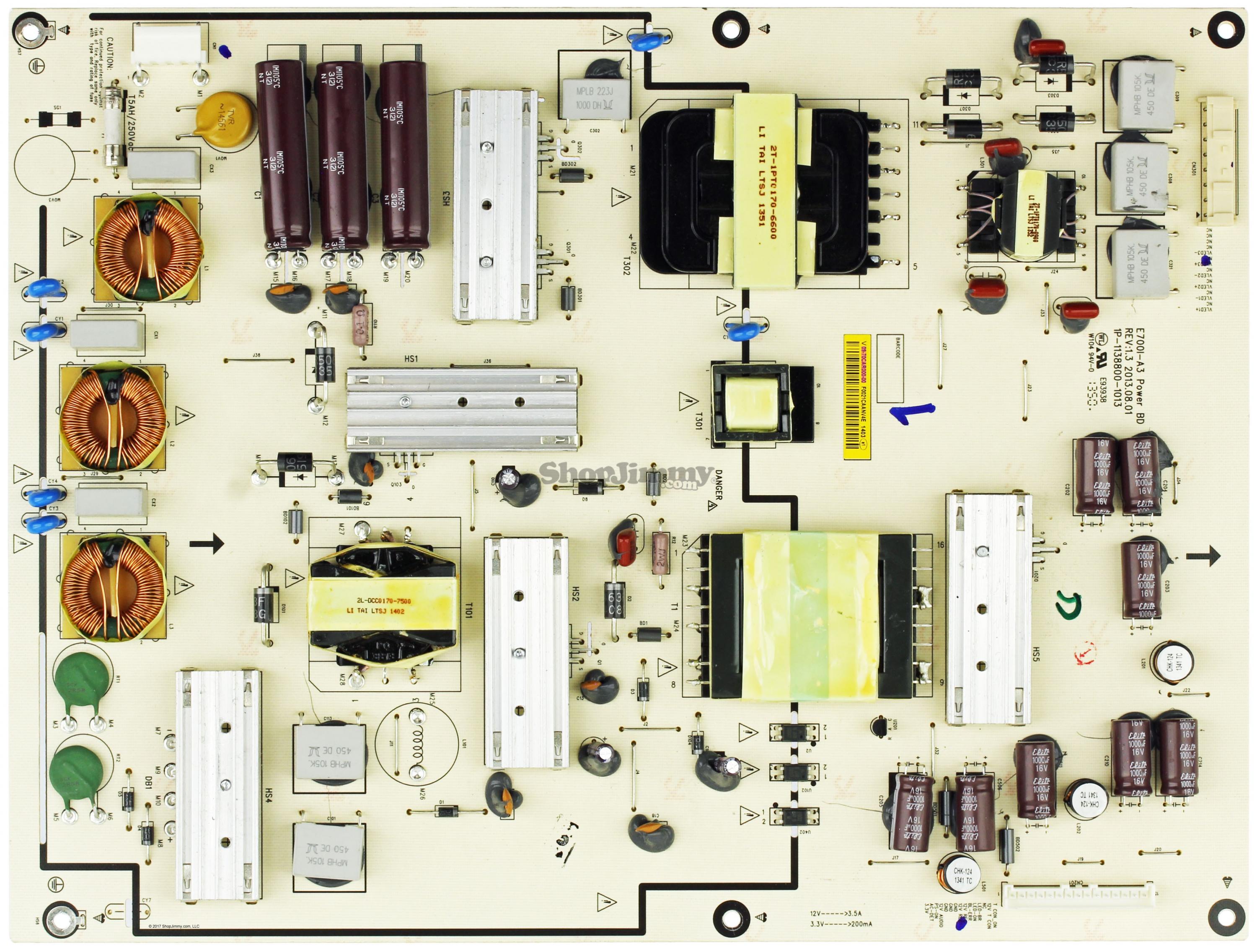

    I was putting the power supply board from a Vizio e701i-a3 in a box and got one heck of a tickle from something. I don't know exactly what i touched but am wondering how much power is present where and how long should I expect the board to be charged after removing the power plug? Attached images of the board.

    maybe from the three long primary side capacitors not sure how long they store a charge for but i always check these with a multi meter to make sure there discharged

      Re: Oh that tickled... how long till complete power discharge?
      Most SMPS have a discharge resistor, but if that discharge resistor is open, then the large filter capacitor will be charged.
      Always use a multimeter to check and never assume that even unplugging the device for several hours or days is enough to discharge.
          Power line filter circuits are supposed to have resistors that discharge those X-caps in a few seconds. I don't see resistors that would serve that function on that PCB.
              +1
              Always check high-voltage caps with a multimeter before handling the board. If there is no way to measure the voltage on the caps (i.e. on a board where you don't have access to any test points, then only try and hold the board by the edges or corners, and preferably where there are no solder joints and exposed traces.
              That said, as far as how long the caps will hold a charger - that really depends on the PSU. Pretty much all modern PSUs have discharge resistors for those caps, but it can take at least a few minutes for them to fully discharge the caps. However, beware that some older PSUs may not have those resistors and can hold a full charge even for weeks. I had a CRT monitor like that myself. The primary cap sat charged for over 2 weeks. It had only about 120-130V in it, and I didn't get zapped at all (I was careful and knew better). However, I thought about discharging the cap with a screw driver just so I can check resistances on the primary side and.... BAD IDEA. When I shorted the cap, it made a huge pop. Scared the crap out of me. Ever since then, I know better and use a 1 to 10 KOhm resistor to discharge the cap.
                  momaka is not exaggerating about film dielectric X-caps holding a charge. They are REALLY low leakage parts. I got lazy one time building a prototype power line filter, and left out the bleeder resistors. Each phase had three 2.2uF X-caps to neutral. An hour or two after performing a conducted noise test I was visited by a very upset EMI engineer ...
                    Originally posted by goontron
                    Ive done that.... It was a CRT monitor and the primary DC filter cap was charged 3 days after removing power.
                    Yep, quite common for CRT monitors when they have a PSU fault, actually.
                    But it is not just CRTs, though. I also repaired a family friends' Panasonic 5.1 surround sound system, which had a shorted multi-layer ceramic cap on one of the PSU outputs. As such, the PSU would shut down and crowbar as soon as it was plugged in. The primary cap remained charged to full 160V even 2 days after they gave it to me.
                    Well, my story was about a primary electrolytic cap... but you are right about the film X2 caps too - while they won't hold enough energy to make a huge pop, they can still sting you a bit and destroy unprotected equipment.
                    But in SMPS PSUs, these will usually get discharged, even if there is no resistor across them (through the bridge rectifier and main filter cap).
                    That's funny! I can only imagine two reasons why that is: either he got bit or destroyed some test equipment.
                    On that note, microwave ovens and modern washers tend to have power line filters with big X-caps like that as well - typically 1 to 4.7 uF. So be careful with those.
                    ... though when it comes to microwave ovens, I think any line filter X-caps will be the least of your problem if you are not careful with the main cap on the inverter/high-voltage side for the magnetron - those are actually lethal when charged.
                          Modern safety standards like IEC 61010 allow 10 seconds for caps to discharge.
                          After disconnecting power, exposed terminals to be less than 70VDC.

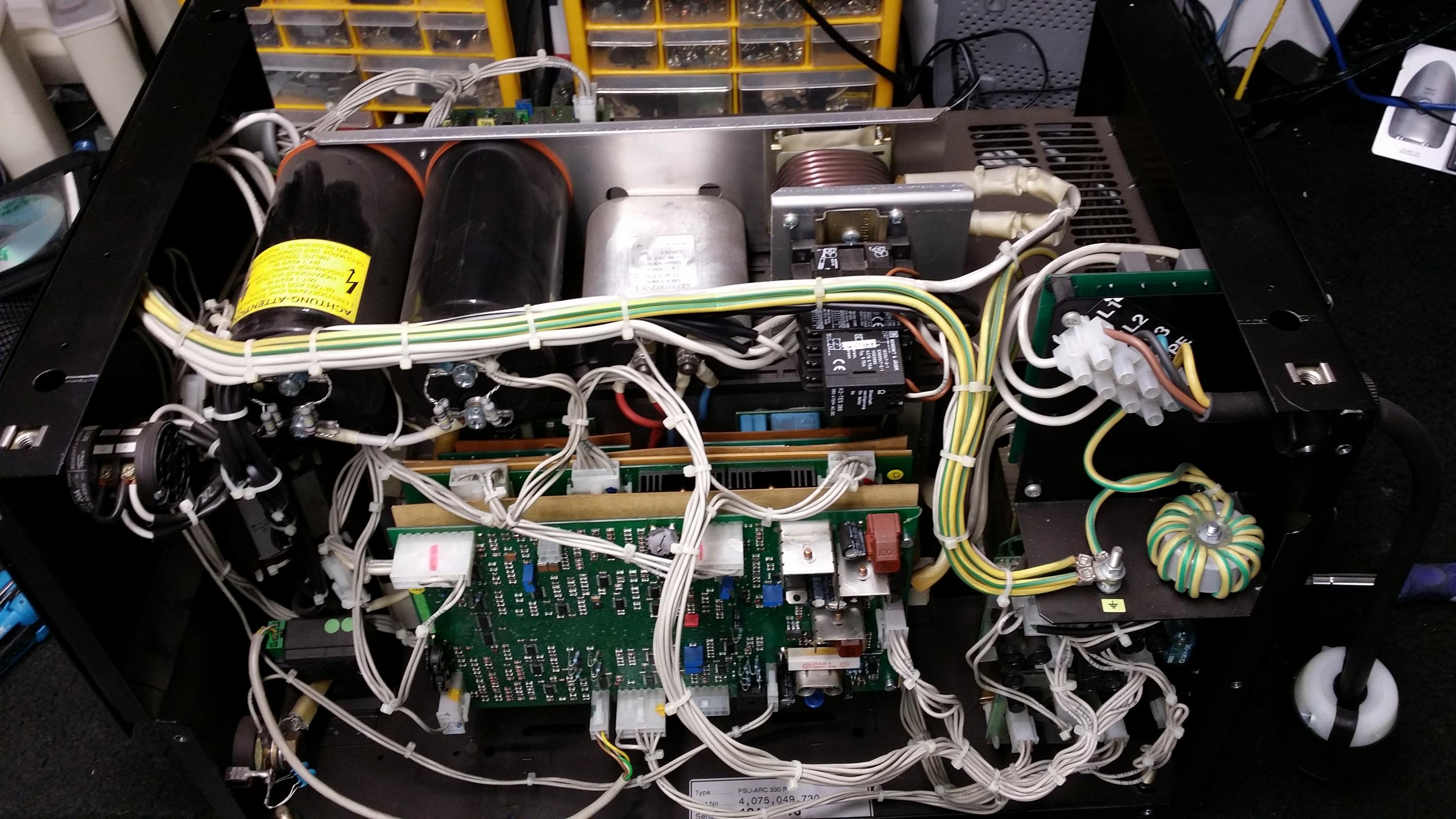

                                    stick your fingers on these caps and report back...
                                      • 31066
                                      i think when you see 4 discharge resistors in parallel, it's not a good place to be.
