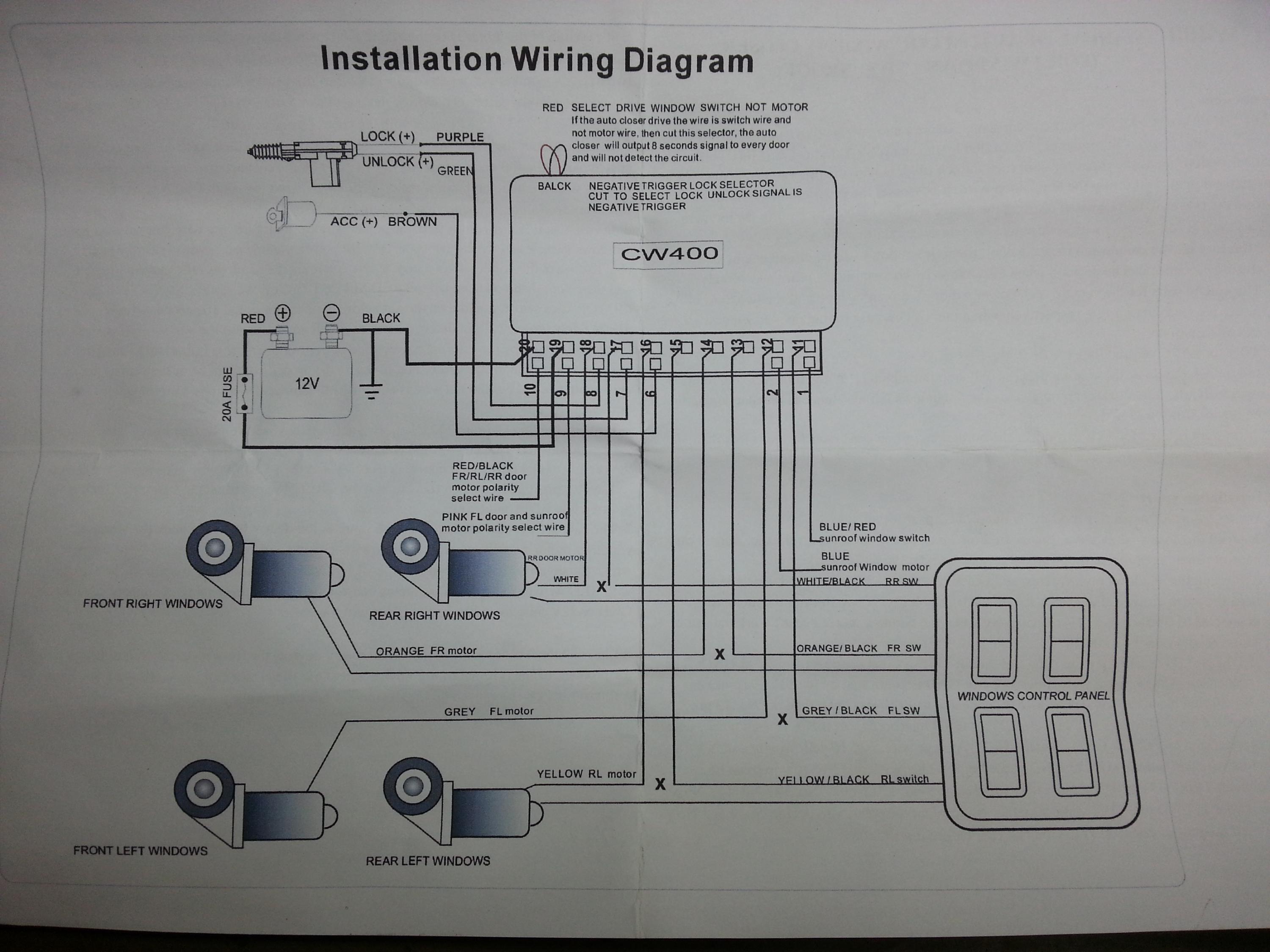

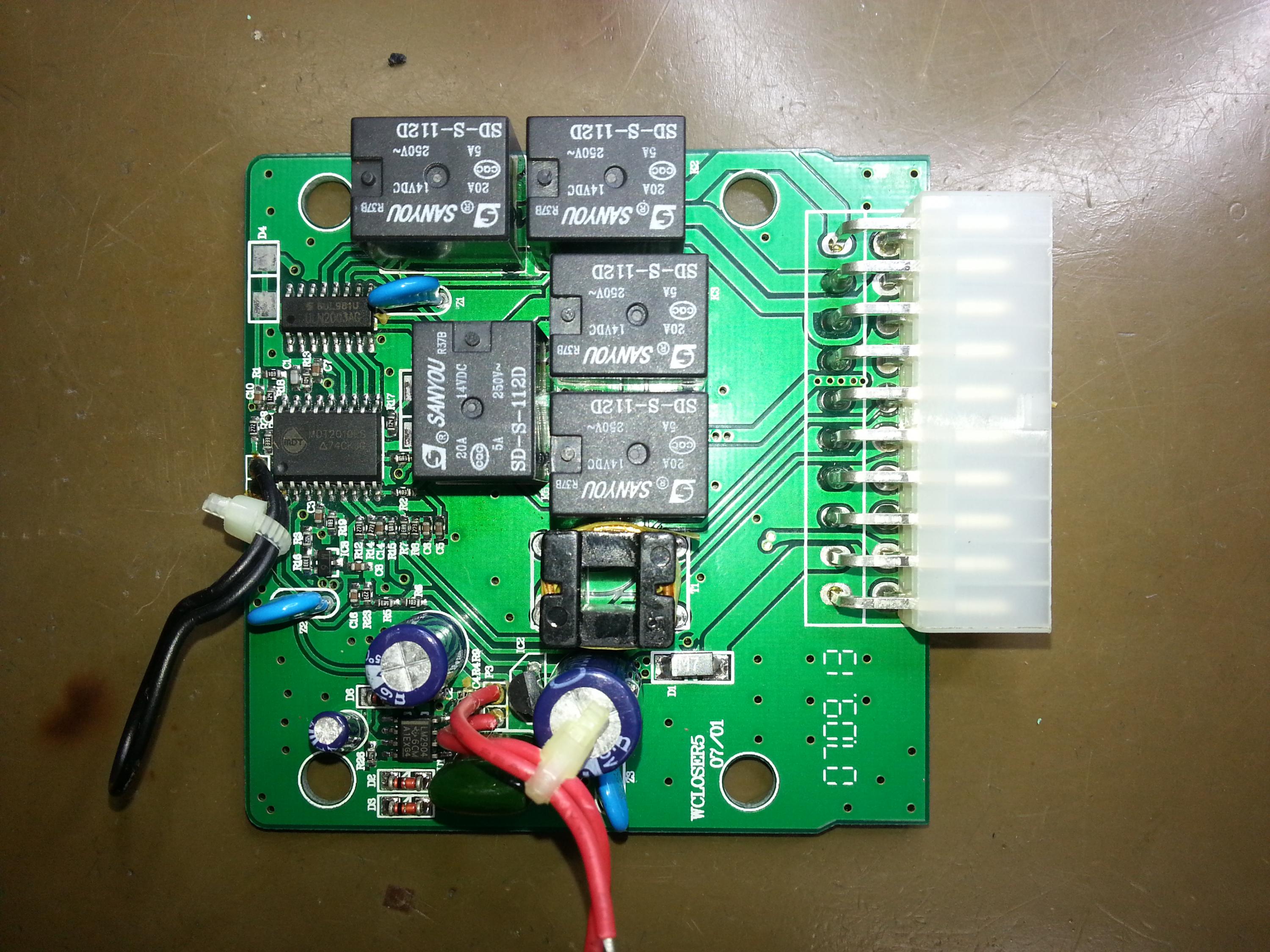

I found something which is interesting, but I don't think it's too much of an improvement over what I already have installed. I found this little doohickey at a flea market which claims to be a window roll-up device that supposedly does what I'm trying to build here. The price on this thing I gotta be honest was zero, because the chap gave it away as "non-functional". See, it didn't come with the wire harness (must've been pulled out of a car, who knows) and the guy said I wouldn't be able to find the exact connector to match, so he gave it away for nothing. Little did he know it's actually a standard 20p ATX connector, so I just said "sure whatever, hand it over"....he was also kind enough to include the instruction leaflet, which is mandatory for China stuff, since you'd have no way of figuring out what it is or how to use it. Anyway, enough chit-chat.
I took an ATX connector with stripped ends and wired the thing on the bench to see what it does: it behaves exactly like the one I currently have installed, except this one gives you the option of either "pulsed" operation or timed operation. If you cut the red wire, each of the relays engage for 10 seconds when it receives a lock signal and if you close that wire, each relay is pulsed very briefly, supposedly for cars which already have latching switches which only require a brief action for the window to go all the way up/down.

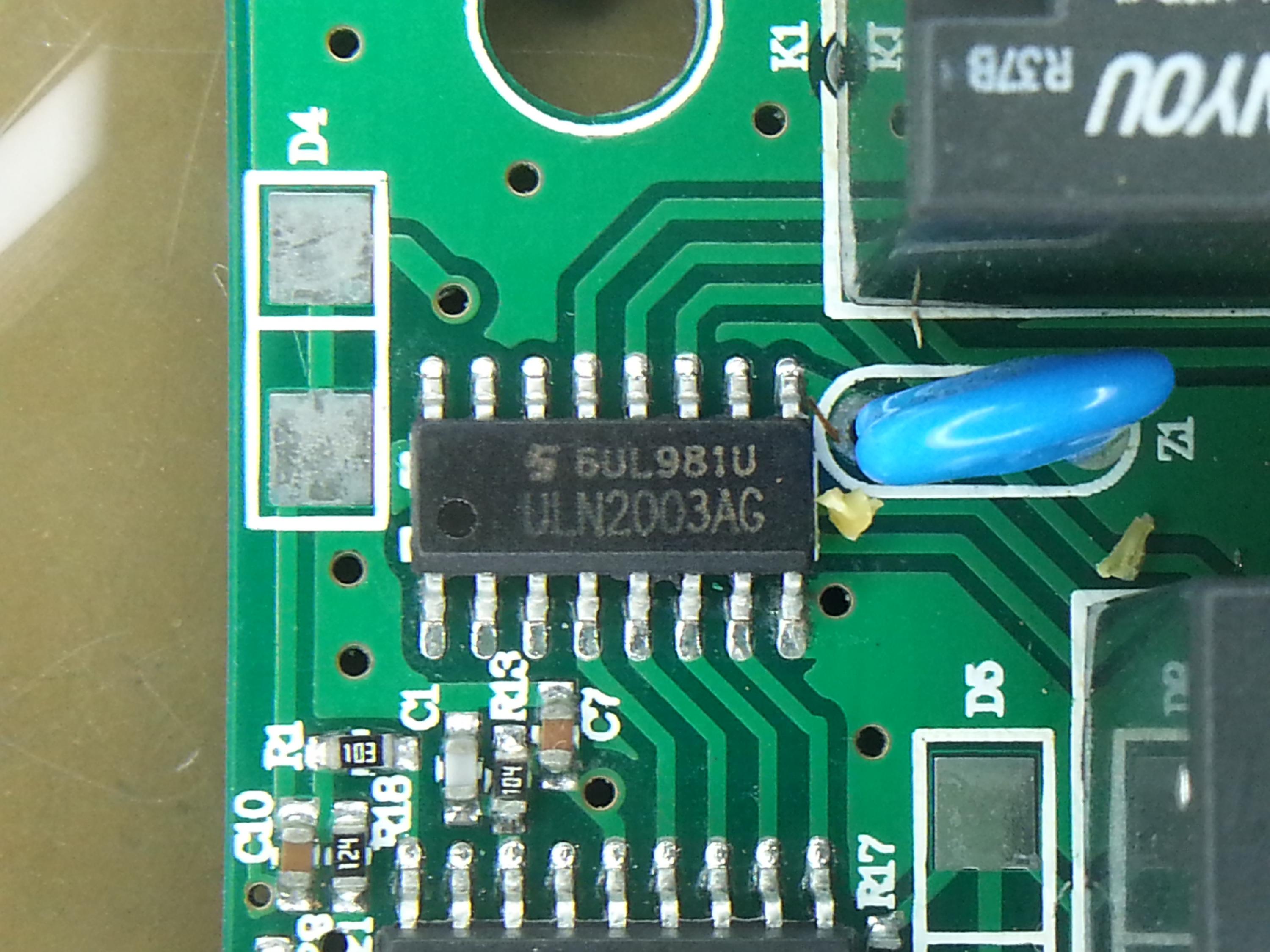

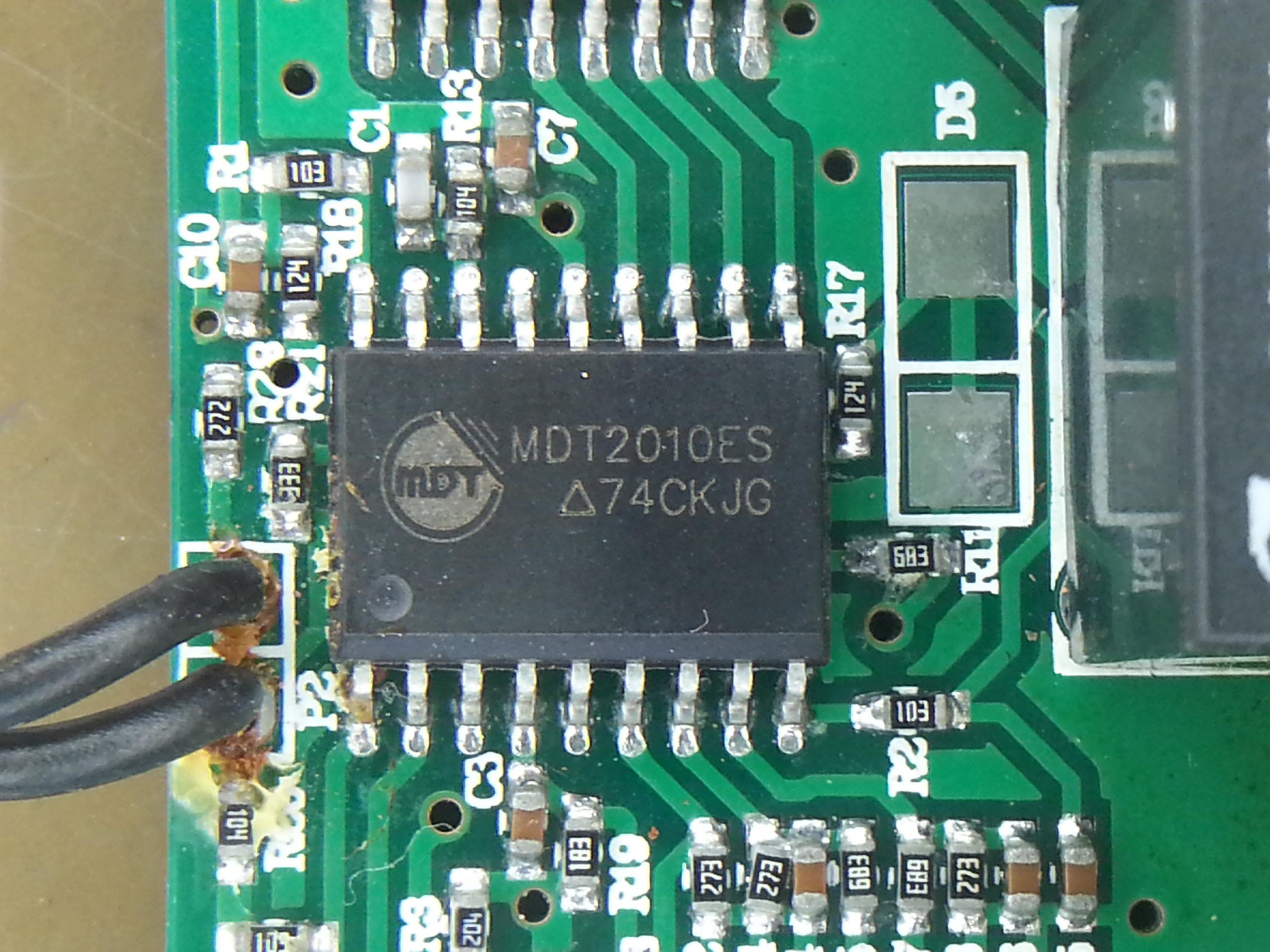

I was mostly interested in the control logic, I thought perhaps it has some sort of current sensing which I could hack into, but unfortunately no, it doesn't seem to do this: in "timed" mode, regardless of the load, it keeps running until the time elapses. I'm actually surprised they left the markings on the chips intact, since chinese products usually have them scratched out or use blank chips. The brains of the thing seems to be that MDT2010 chip which I couldn't find much about. The first few searches revealed a datasheet for an 8-bit microcontroller here. I thought for sure there's no way it would be the right thing, despite the model being an exact match, so I searched high and low, but all I got was this 8-bit micro....Is this thing that intelligent ? :| I mean the stuff that datasheet discusses is...intimidating to say the least :| Extremely complex stuff, so it's way over my head to try and hack this if it really IS micro-based and uses that chip indeed. The highest I'd dare to aim for at my level is Arduino
There will hopefully be some engineering mavericks around here who will look at that stuff and go "oh, elementary...", so if so, please feel free to share you thoughts. Sometimes complex electronics stuff is instantly made easy when properly explained...

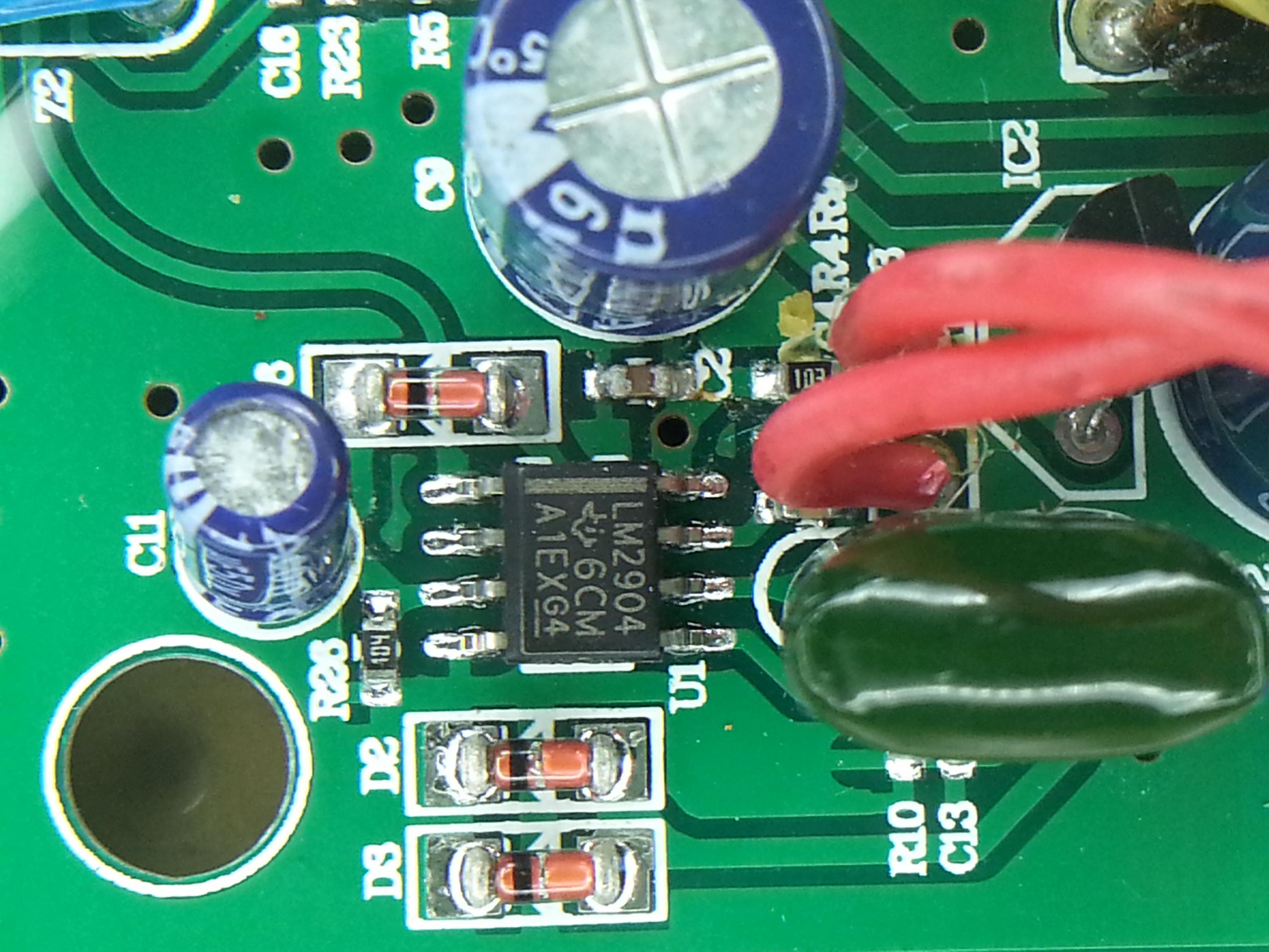

The other two ICs are an LM2904 op-amp and an ULN2003 relay driver, for both of which I managed to find the "correct" datasheets (I put that in quotes assuming the MDT one is indeed not right and these last ones are
). A very quick look at the circuit made me believe the op-amp is a current sense amplifier connected to that coil. I thought for sure that coil does some sort of current sensing, since it's in series with the battery input, but either I'm doing something wrong, or it's indeed not designed to do that. I also attached the instructions sheet in case you're curious or perhaps spot something that I don't. It's in "chinglish" of course, but you only really need the schematic - the other side is not that important.
What do you guys think ? Would this thing be of any use or is it going in the bin ? Cheers.Wattevah...Comment
Re: Non inverting Schmitt Trigger question
You do not use coil for DC current sensing, that coil at the B+ is for filtering noise from alternator just like one you have in car stereo to get rid of the whining sound from alternator.Last edited by budm; 07-20-2017, 09:09 AM.Never stop learning

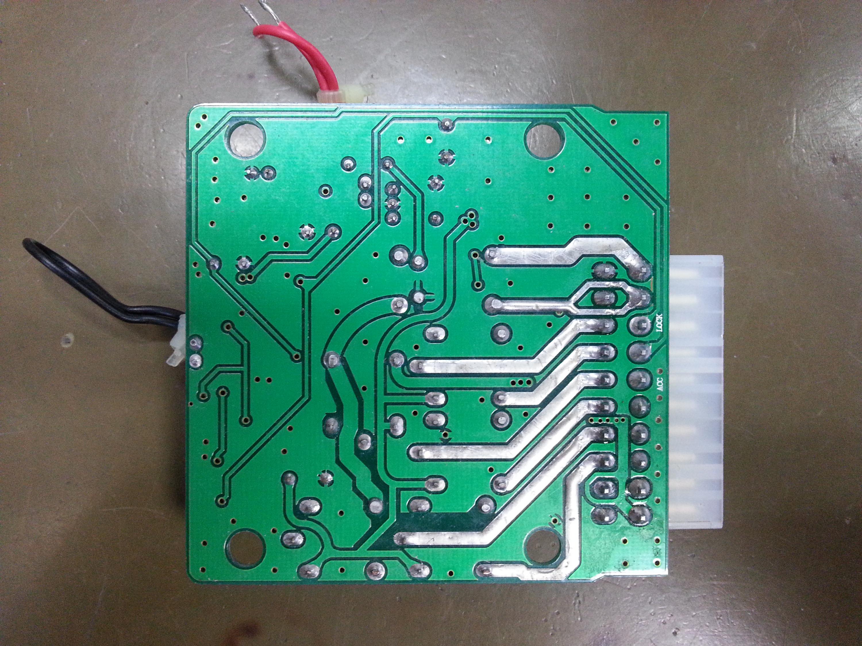

So it seems it does not do current sensing at all, since I don't see any other large shunt element in there...Wattevah...Comment
Any good clear hi-res straight shot of the bottom side of the board?Never stop learning
