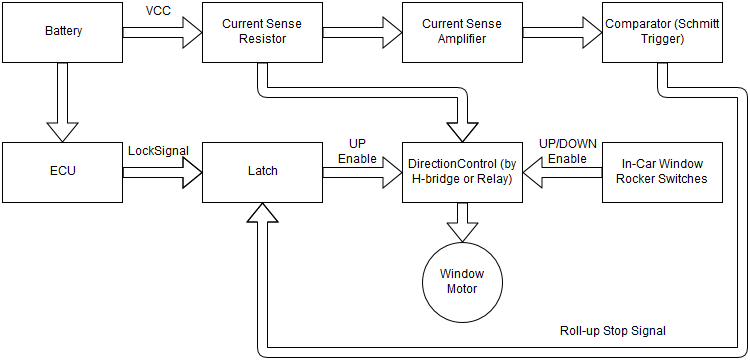

          #44
          Re: Non inverting Schmitt Trigger question
          I put together a diagram to simplify the project a bit....or at least I HOPE it does, as I'm not very good at drawing schematics and junk - I just keep everything in my noggin
          So: current comes from the battery (obviously) through the current sense circuit. I imagine the current sensing resistor can be placed either on the positive or the negative wire (for high-side or low-side sensing), because neither of the 2 terminals of the motor are connected to chassis ground, since they are supposed to switch polarity and they would short out in one direction if they were grounded (to get my point, by contrast, the starter motor for instance, has its negative terminal permanently connected to the chassis, so low-side current sensing would be impossible).
          I figured it's easiest to place the current sensing circuit before the direction control, which can be either an H-bridge (which is difficult and probably not space/cost effective) or a DPDT relay which simply reverses polarity (I have done this many times with small projects so I know it works). It is this part that does most of the work: it runs the motor in the UP direction when the ECU sends the lock signal to it through a latching circuit which I have not yet designed but kinda know how it should operate (props to Dave once again ), or of course, when the rocker switches are used like normal, in which case it can also run in the DOWN direction. It seems easier to incorporate the rockers in the circuit as well, rather than trying to wire them separately which can lead to shorts.
          Again, there are no other electronics involved in running the motors, that being said, YES: if you just keep your finger on the button, you'll probably eventually kill the motor and battery (unless it has a thermal overload inside it). Right now, I'm working on the current sensing part. Cheers and as always thanks for putting up with my madness

            #45
            Here is an interesting paper on the design of d.c. actuators (the actual term for these things). In this case, the motors operate a vehicle's HVAC blend doors, but the same theory would apply to operating windows. I have nothing against designing a digital unit from scratch, but be prepared for a major science project. To me, the most interesting part of this subject is going to be detection of the motor stall condition, and the implementation of limit or position sensing (2 different things in many cases). You can see the applications are nearly universal. Controlling the rudder position of a ship, for example. Sensing and driving circuits would be very complex servos, with PID software tweaked for individual systems. Its the same thing on a larger scale.

              #46
              Interesting article, though it's a bit too complex for what I'm trying to accomplish I keep saying I'll actually rig up something on the bench just to see what happens, but I've yet to do that yet due to lack of time/patience. Yes, I too expect detecting the stalling of the motor to be the most complex part, since latching the thing on and then turning it off SHOULD be easier. The direction control can also be easily achieved with a relay (in theory at least, because right now I'm having so much trouble finding a bloody DPDT relay, it's surreal ! )

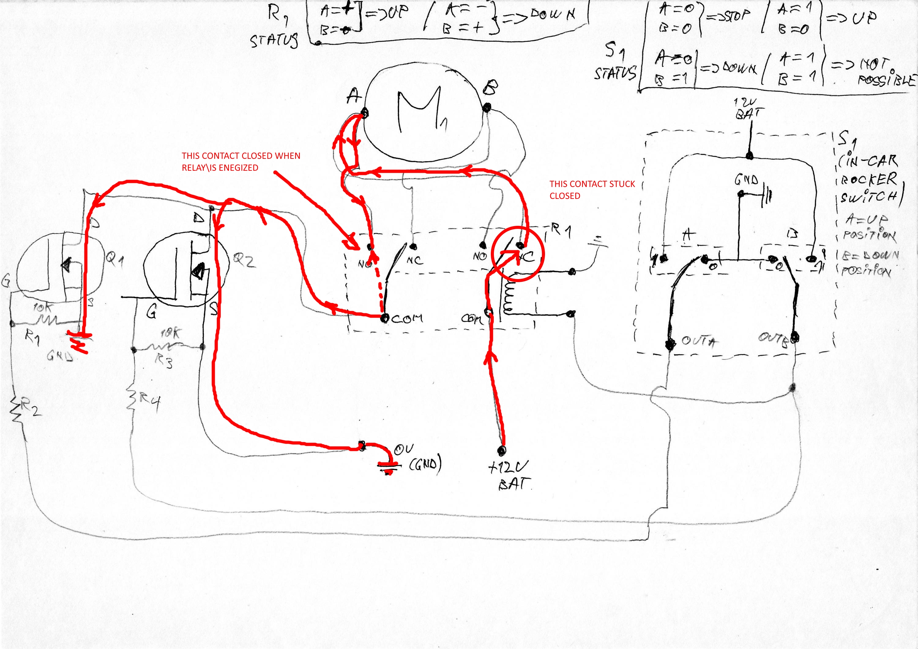

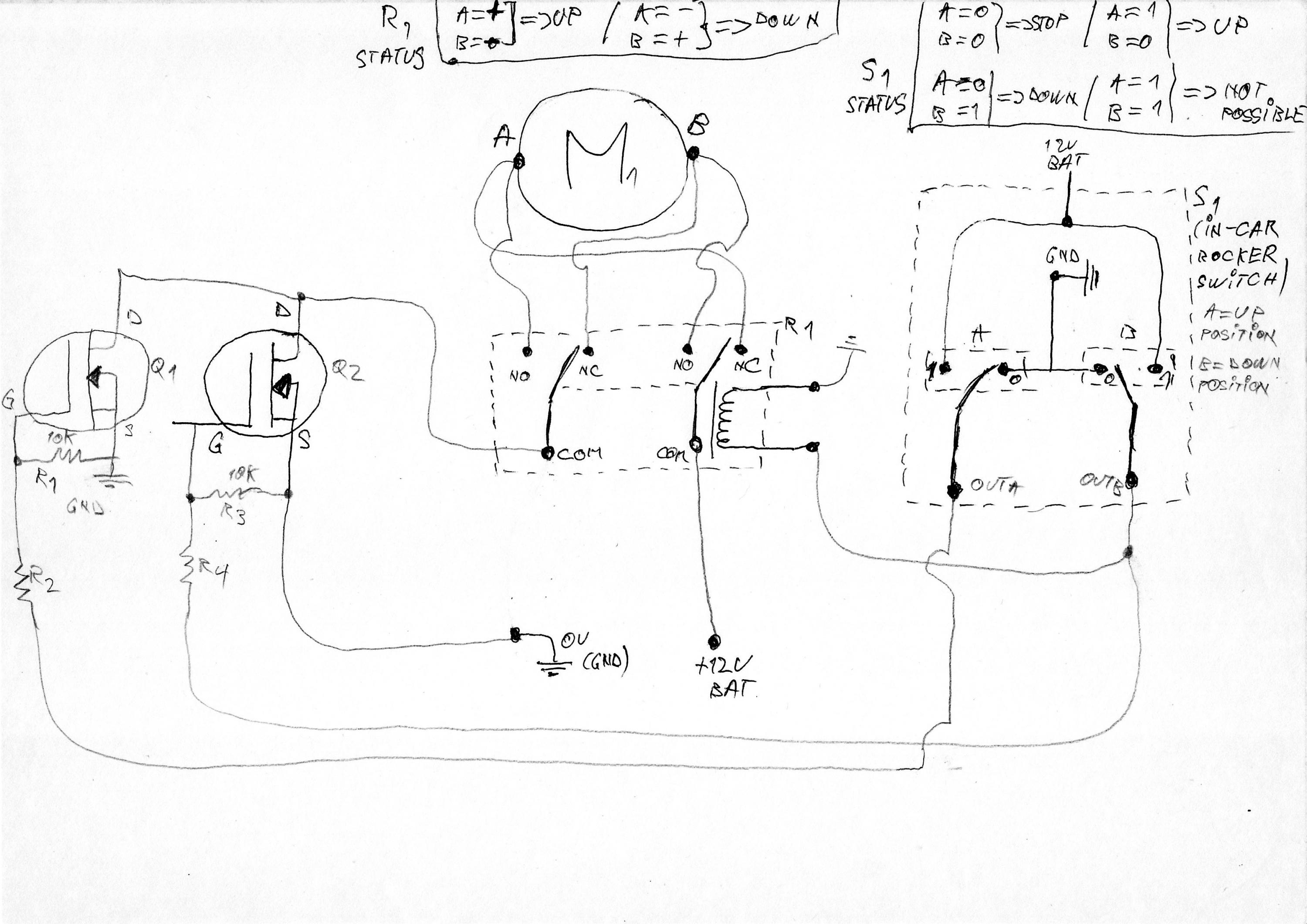

                              #54
                              I did as instructed and put together a (bad) schematic of how I imagine the direction control for the motor. However, in doing so I encountered a couple of issues that I didn't see coming beforehand, which might make the H bridge the best solution STILL. Just for the sake of it I pushed on with the relay method on paper anyway. Please bare with me, as I KNOW this is the wrong way of doing it, but Longbow was right: no way to spot issues in your design until you sit down and draw.
                              Let me walk you through, since I know it's clear as mud: R1 in the middle is in charge of setting the direction: when it's off, sending power to the COM terminals runs the motor up. When the relay switches over, the motor goes up since polarity is now reversed....seems simple and effective for now.
                              S1 on the right is the internal diagram of the rocker switch inside the car: it's basically 2 SPDT switches, A and B, in one package, operating in opposite directions. In the middle position, both the out terminals are grounded in the middle (marked 0). When rocked to one side, the switch on that side goes to VCC (marked 1), while the other remains grounded and vice versa. By design, it's impossible to have both sides onto 1 at the same time.
                              Since the relay has no OFF position (where the H-bridge has the first advantage), I initially thought of using a FET as a switch in series with the power going to the COM terminals of the relay to cut the power when the motor is not in use. This is the second issue I didn't see coming and quickly became apparent as I was drawing: the FET would need to come on for BOTH the up and down positions of the relay (since the motor needs power for both directions), which I thought I'd achieve by connecting the gate of the FET to the outputs of the switch - HUGE error: because the outputs automatically revert back to GND, the moment I rock the switch in any direction, I'd have a dead-short between OUTa and OUTb, since one is VCC while the other is still GND....NOT gonna work, so don't even mind those resistors I put on the gates, since that's the least of our worries right now.
                              I thought I'd work around it by adding another FET so I'd have 1 for each position of the switch and wired the gates separately - this isn't any better either, because the gates would always be grounded when the switch is in its neutral position, so driving the gates with any other signal becomes impossible, since anything I'd apply to them would be directly sunk to GND through the switch. To push this failed idea even further, I'd need yet another FET to allow power to go to the motor when the circuit receives the lock signal, so by this point I already have 3 power FETs AND a relay, so hell: might as well add a fourth relay, get rid of the bulky and possibly expensive relay and build a H-bridge...looks like it's back to the drawing board, but I thought I'd share my thoughts anyway Practice, practice, practice.....I know. Cheers.
                              Wattevah...
                                #55
                                Did you think about the failure mode of the relay contacts, I.E. one of the Contact welded closed? Nice big sparks!
                                Analyze, analyze......
                                • Dannyx
                                  CertifiedAxhole
                                  • Aug 2016
                                  • 3912
                                  • Romania
                                  #56
                                  If one of them got stuck, the motor would just have both its terminals connected to the same potential (GND or VCC), assuming the other contact DOES spring loose like it's supposed to. This holds true only for the schematic you just posted, since in my flawed application, there would indeed be a short and a blown fuse. This does not necessarily mean that an H-bridge is bullet proof and can't short out, but at least there's no mechanical failure caused by arcing.
                                  Wattevah...

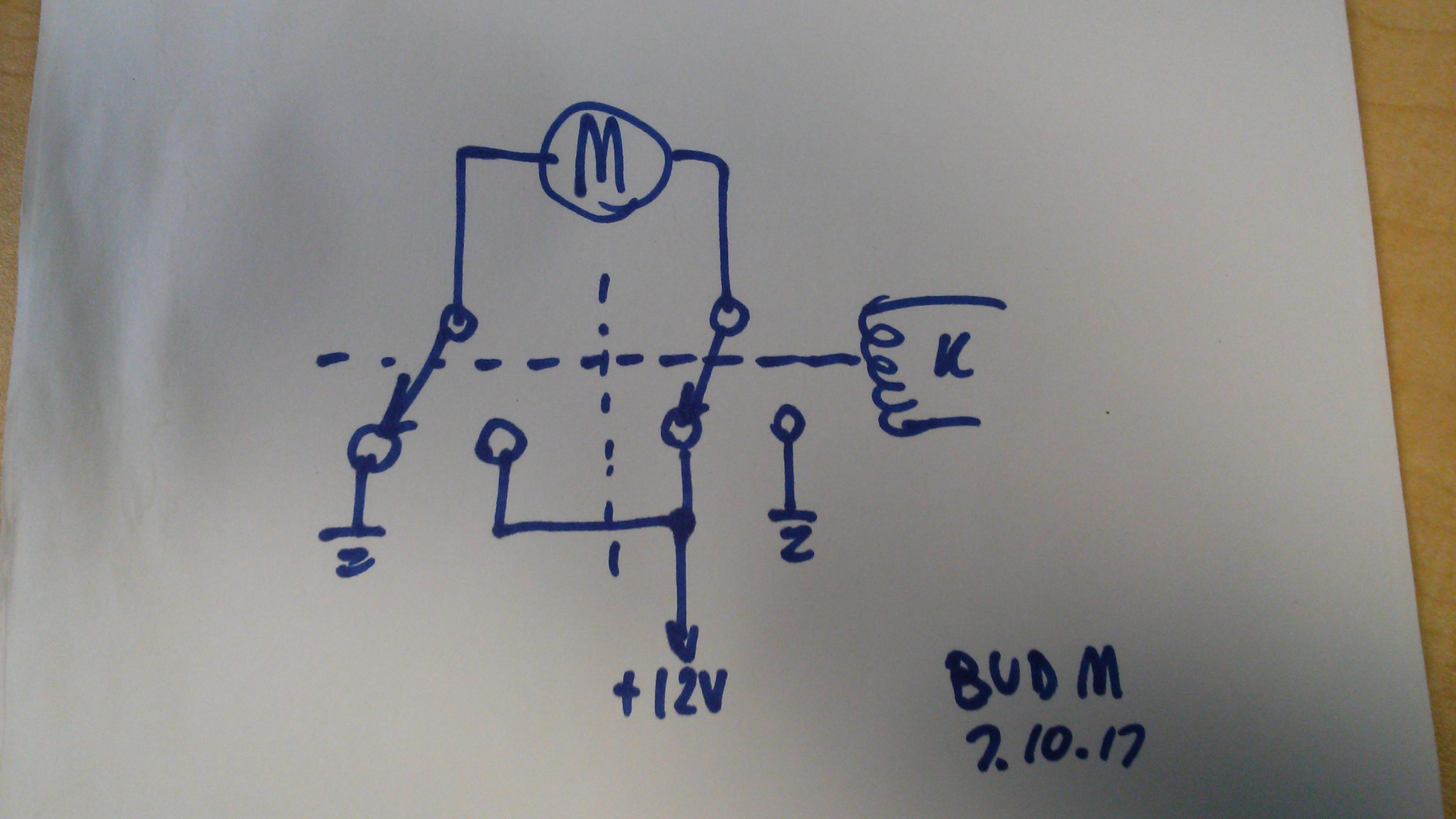

                                    #57
                                    You do not see it?
                                    https://www.badcaps.net/forum/attach...0&d=1499710455
                                    Look at your diagram, if the relay contact on the right is stcuk on normally closed, and when the relay is energized, the Com left contact will make contact with the N.O. contact so you will have current flowing through the relay contacts to one stuck contact and the N.O. contact through MOSFET to GND!
                                    Not the same as my schematic, so if you hook the motor as shown, nothing will be damaged.

                                      #58
                                      You do not see it?
                                      Not the same as my schematic.
                                      I believe that's exactly what I just replied, just under different words
                                      Wattevah...
