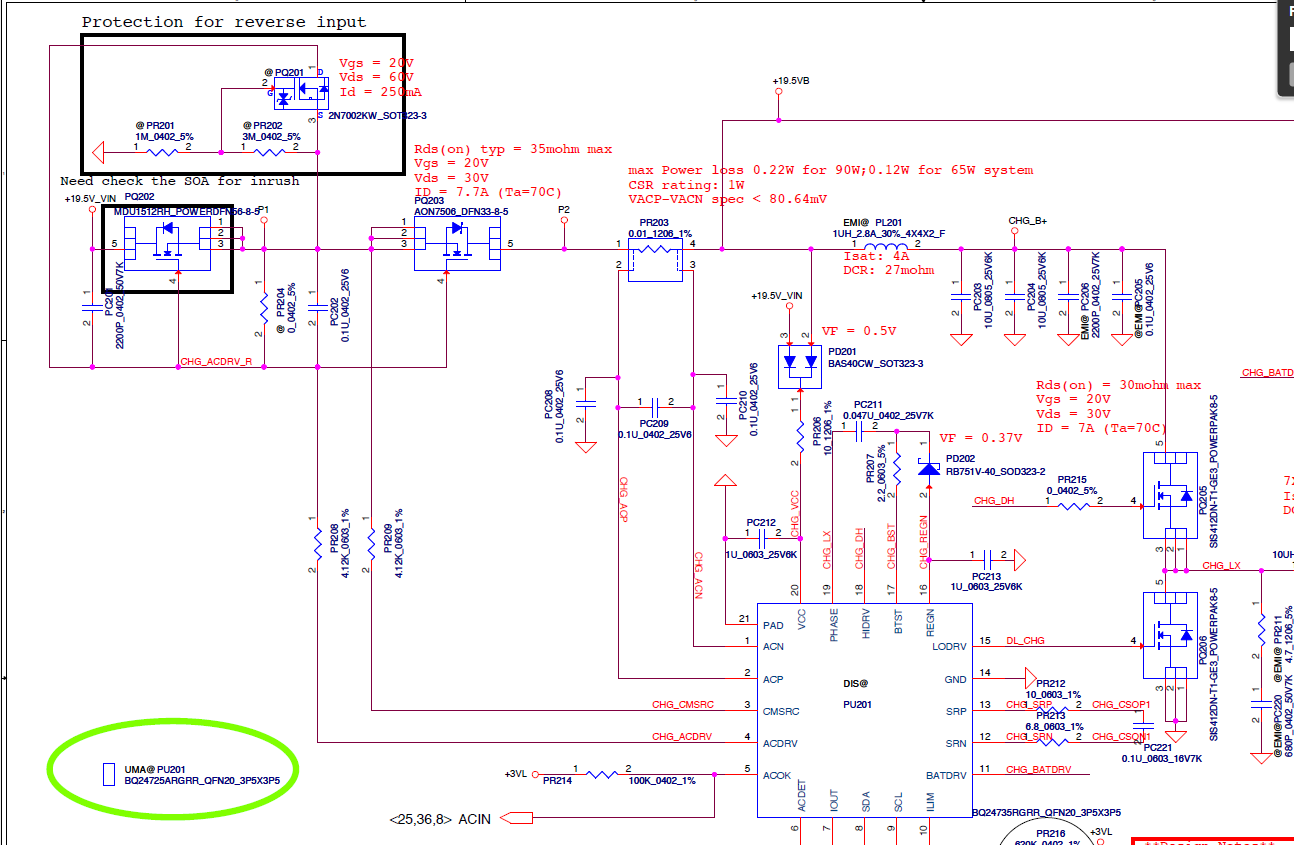

1) is the power adapter the original and recommended model for this unit ?
2) see attached -> measure the voltage on the 2 x DCin mosfets used by the charger IC to power the logic board.
Meter in DC volts mode (30v or higher is ok).
Red meter on each pin to test; black to ground.
Check source (1-2-3); gate (4); drain (5-6-7-8) of each mosfet @ PQ202 & PQ203.
Post each measurement for a review. -
