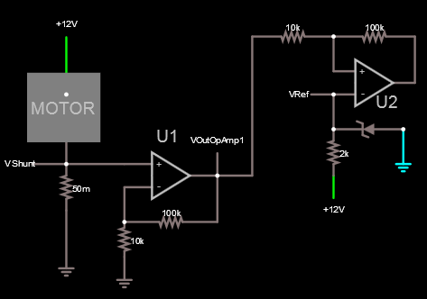

                                Re: Non inverting Schmitt Trigger question (+circuit)
                                Here is the (still crude schematic) of the current sensing circuit I envision. You can simulate it here. Just go to "file", select "import from local file" and load the TXT file I provided (let me know if it works). Now please bare with me as I'm sure it lacks a lot of things and there are probably many others wrong with it and my idea (no filter caps anywhere for example - I know), but that's precisely the point: to polish it and make it work
                                This is just the current sense part - I'm still working on the latch and stop circuits which will turn on the circuit when the car is locked, latch it on (since the lock signal is only present for a brief moment) for as long as necessary and then stop it once the window is closed.
                                I'll walk you through: in lack of a proper motor piece, I simulated it using a potentiometer on the left: as the motor halts, it will draw more and more current, which can be simulated with that pot....FAR from ideal, but it got the job done in the simulator. The current shunt resistor is a 0.05 Ohm (50 mOhm) resistor, which I imagine is STILL too high for a motor that draws as much as 20-25A when locked, but I chose it because I'm planning to test this out on the bench and the only thing I have handy are some 100 mOhm resistors which I'm going to parallel to drop to 50 mOhms and see if I at least get a reading with that drill motor I told you about.
                                Anyway, regardless of what this resistor is going to be, its output will be far too low to drive anything, so it MUST go through the non-inverting op-amp amplifier represented by U1. Here's where the math starts: I've also included that excel calculator with the actual values used in the simulation. The numbers (and Dave from EEV ) tell me that amp has a gain of 11 in this configuration...which it does: 0.1v in results in 1.1v out (the graphs at the bottom of the simulator also show this pretty well: if you move the pot around, as the "load" increases, so does the output of U1).
                                The output then goes to the main event: the schmitt trigger represented by U2. After MANY hours spent calculating and researching, I put together the excel calculator to simplify my work and played around with the values to get them as round as possible and used them in the simulator. It works to a degree, but the upper threshold is off: the numbers tell me it should be 2.2v, however I need to crank much higher than that (to around 3v) to get U2 to trip over. The lower threshold works fine though: when current drops enough, the non inverting input of U2 also drops down and when it reaches around 1v, U2 turns off like it should. It could be a simulation error though...let me know what you think and by all means feel free to play around with it and post it back Cheers

                                  http://www.analog.com/en/analog-dial...mic-range.html
                                    #37
                                    So you're suggesting I should go with high-side current sensing rather than low side ? Math ahoy !
                                      You also get common mode rejection too. Car is noisy environment for electronics.
                                        How's this sound ? Seems I'd be better off with an off-the-shelf solution.
                                        Wattevah...
                                          #40
                                          This might be a stupid question, but I don't understand in the article budm provided why the negative supply rail (VSS let's call it) of the op-amp is not connected to GND, but instead to the zener diode and resistor. I know how that zener operates - it regulates to 5.1v and the resistor prevents too much current from flowing and burning the zener (though I would've placed the resistor at the cathode, correct me if I'm wrong). Now let's If I have 12v as "Bus voltage" and the zener is 5.1v as the article says, what would the supply for the op-amp be ? 7v ? The article DOES explain the purpose of the zener further down, but it throws some pretty fancy terms around, mainly common-mode voltage which I can't possibly grasp for some reason Other than that, it's just "simple" math
