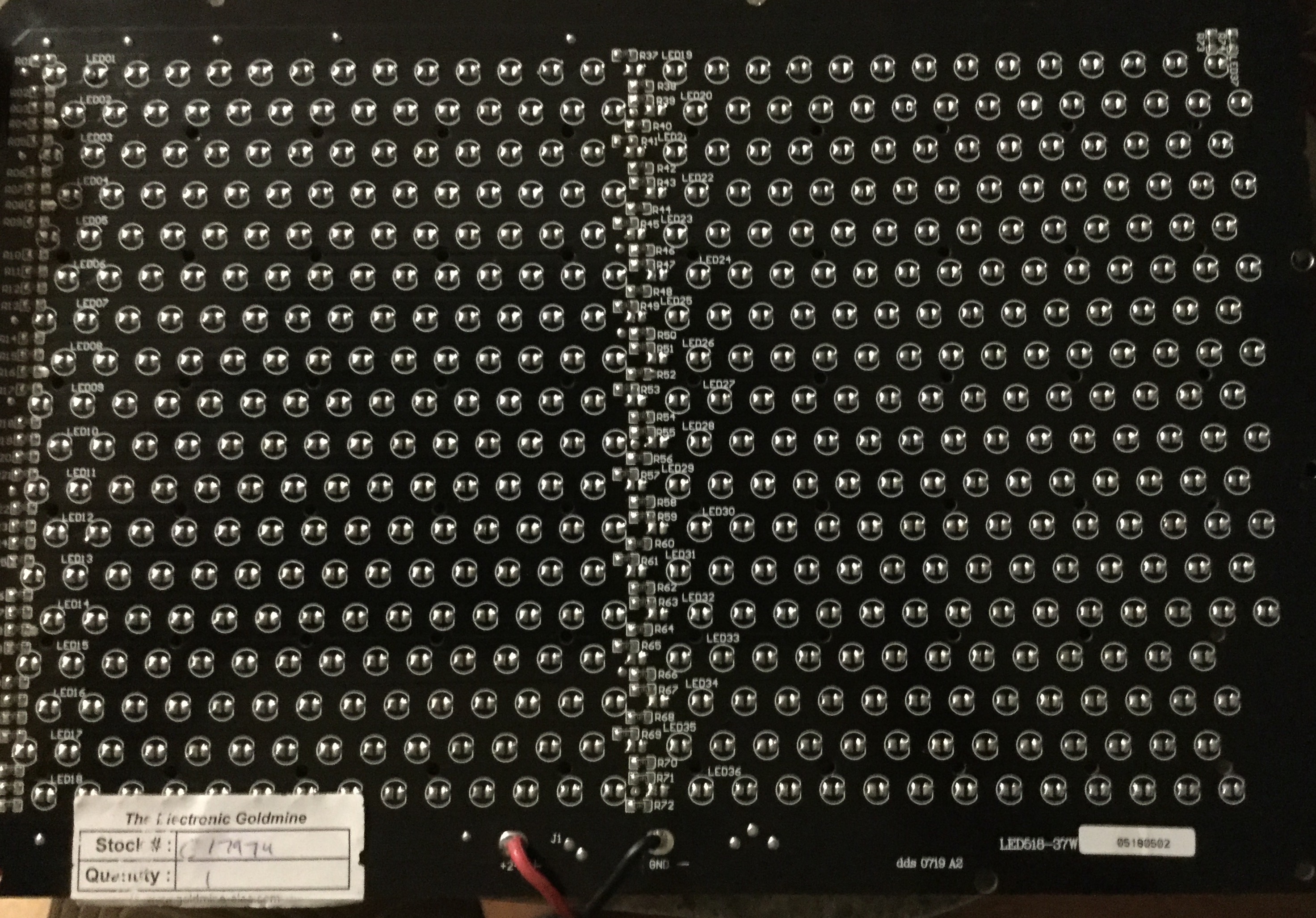

        It came in the mail today--------->>>>>>>
        I have tried this unit and a couple of comments about how it works------->
        One thing I have seen with unit it works real good if it only has one row another words
        Series string
        But it dose not work as well if there are in parallel then LEDs do not get very bright you can see if all LEDs are working or not which is good thing
        Are there any LED testers that would do parallel LED strings ---->>>> just asking

              Re: What do you think of TV LED tester eBay
              Can you show me the parallel connected LED strings? If they use more than one strings and they are not connected in series to form one big long string each string will have its own MOSFET and current sensor for each string so it this the case to you to locate the Cathode return side of the each string of LED so you can just light up just one string only, it will be very bad design to have the LED strings connected directly in parallel, if one goes open circuit the current on the working string will go up and it is also hard to get the match the total Vf of each string to get each string to have equal current flow.
                • Jul 2011
                • 6070
                Here is the board in question as you can see there only drop down resistor
                So is there any kind of tester that would work this kind of board
                The way this board is set this see a lot of LED board set up
                  Those LEDS are not connected directly in parallel, each set has its own limiter resistors so this kind of the set the total current draw will be higher than that LED tester can deliver.
                  You will have to put the Red probe of the tester on the Anode of the second LED of the string you want to test, the black probe on the Cathode of the last LED in that string, then you can test the first LED of that string by itself.
                      BTW, if you check the current draw of that LED panel then you will see why that tester cannot drive that LED panel.
