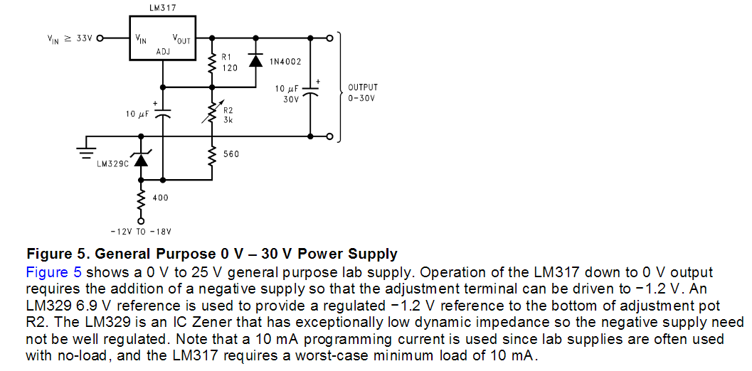

                                    Re: The LM317 is quite the hot head ...
                                    LM317 is not made to go down to 0V output, 1.25V is the min output, look at the spec sheet, and if you want it to be 0 then look at the Apps notes.
                                    https://cdn.badcaps-static.com/pdfs/...4077910403.pdf
                                      Yes, as said, with a RRIO LM6142 and a negative supply will give a negative output, which will get the LM317 down to 0V.
                                      Or a LM741 with a negative ~3V supply which will both deal with the 741 not reaching negative rail plus get negative enough for the LM317. Either way, a negative supply is necessary.
                                      But that edn article seems to have a design error.

                                        Another trick I've seen often used is to use a diode in front of the linear regulator, or the classic use of a voltage reference/zener diode and a negative power supply :
                                        TI: AN-181 3-Terminal Regulator is Adjustable
                                        Here you have a 6.9v voltage reference - you can probably find some cheaper or more common zener diode or a lower voltage one ... you basically need anything above 1.25v to make it possible to output 0v
