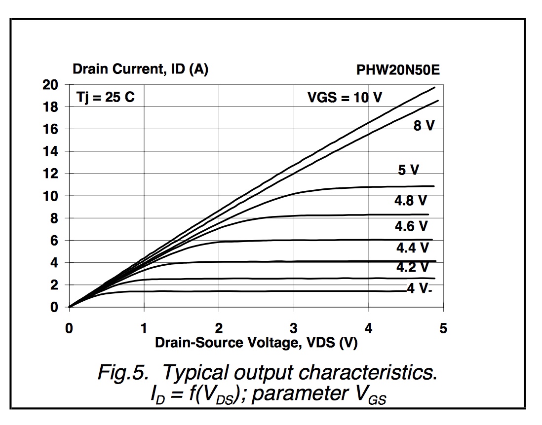

        May have found a better solution ... was scouring through my regulators / mosfets and found an IRFP460 ... look at the graph on this bad boy...
        I think we might have a winner...

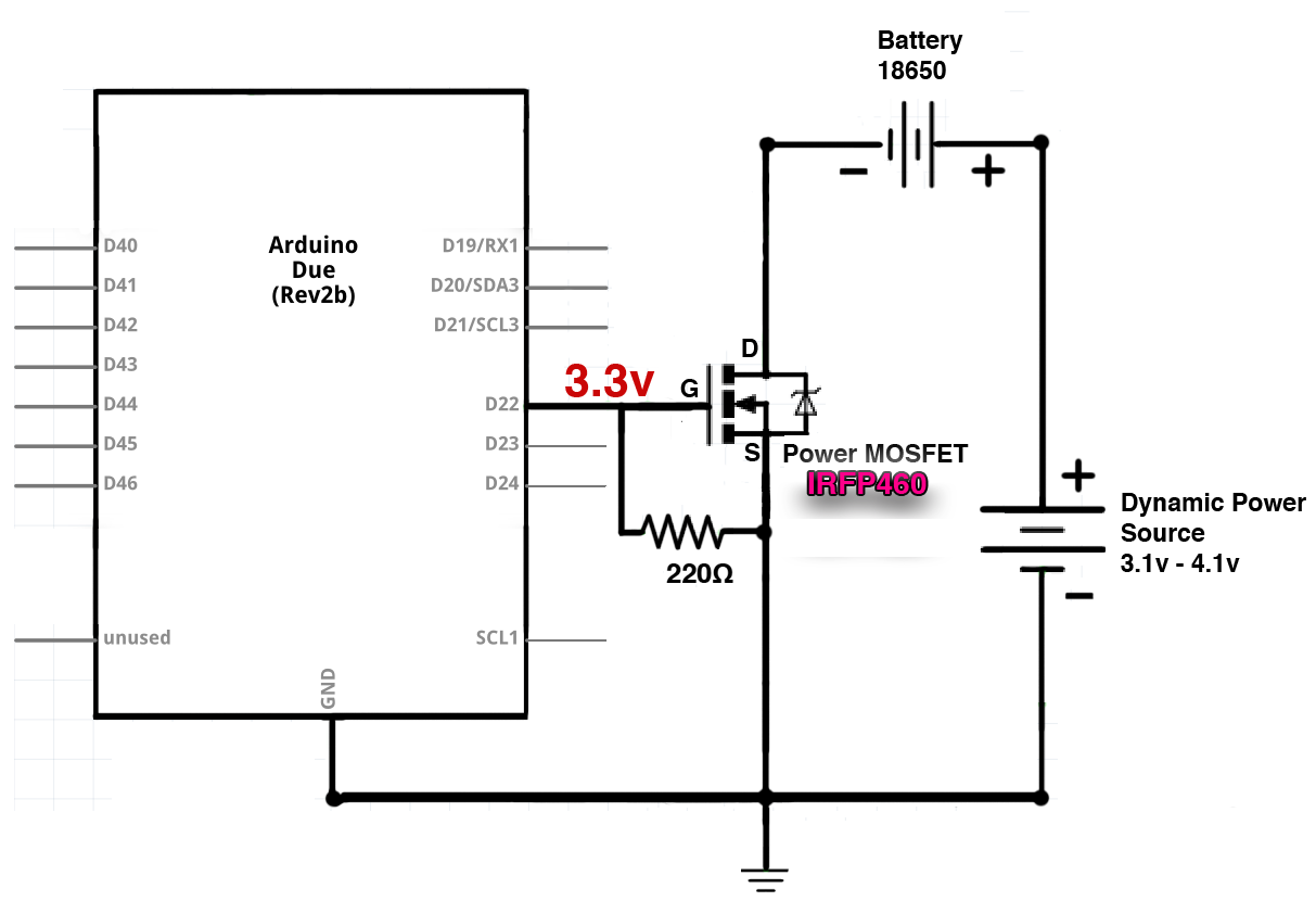

          So with that, I'm thinking this is how its gonna work... maybe?

            Will 1A be sufficient? At 3.3V it's below the rated threshold though slightly above the minimum spec (used for Ids leakage estimates). You'll need a level shifter or find another FET. Or you could use a power darlington but the characteristics might not be sufficient...

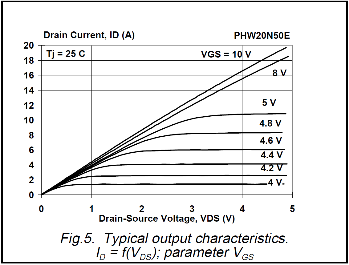

              The way I read the graph, its good for 10 amps at 3 volts
              See?
                  See?
                  Vgs are those lines, the graph shows only Vgs starting from 4v, your 3.3v Vgs isn't even in that graph picture.
                  something cheap and good for around 5A continuously : https://www.digikey.com/product-deta...ICT-ND/2052800

                    This is what I was using

                        3.3V Vgs is not going to cut it based on your graph in post 66. BTW, how did you come up with 220 Ohms GS resistor? You know what Vds, Vgs are, right?
                            I just arbitrarily chose 220 because from what I’ve read, the only thing that matters, is that the gate be able to go ground should the arduino pin ever float for whatever reason. Because from my experimentation, you can apply a voltage to the gate and if you take it away, the mosfet stays ON ...

                                You need to understand the device a bit and think about what that graph tells you. And remember that ohm's law still applies. Each curve on that graph tells you what a typical device will do with a particular Gate-source voltage applied with a junction temperature of 25C. If you apply 4V G-S, the Drain current will never be greater than about 1.5A, no matter how high your Drain voltage is. The 10A, 3V D-S point you picked is with 5V G-S, if the silicon inside that nice TO-247 package is 25C. Well with 3V across the D-S and 10A Drain current, that silicon is going to be much warmer than that, even with a massive heatsink and a lot of air.
                                Now, if your available G-S voltage is just 3.3V, you're going to need a logic level MOSFET, which may turn with 3.3V
                                      How did you determine that at 4 Vgs, there will never be a Drain current larger than 1.5 amps?
                                      25C is 77F ... and if it can sustain 10 amps and remain at that temperature, then I can't see why it would be improbable for it to sustain 3 amps at room temperature, unless the amount of current it can handle significantly decreases with each degree of temperature increase, but in most cases, the temperature that the device will be in (in this case anyways) wont be much higher than 77F.

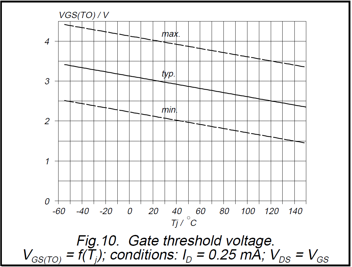

                                          Open your datasheet:
                                          Determine your Vgs value.
                                          Page 2, in the Electrical Characteristics (note above the table it says Tj = 25C unless otherwise specified) :
                                          Vgs (to) GATE THRESHOLD VOLTAGE : min 2.0v , typ 3.0v , max 4.0v
                                          This tells you that typically , the mosfets will turn on fully at 3.0v but they don't guarantee ALL will turn on at 3.0v or that the ones that turn on at 3.0v will turn on at 3.0v under all circumstances.
                                          Basically, if you buy 100 of them, some won't turn on fully with 3.0v, but all should turn on fully with a voltage above 4.0v (the maximum value in that table).
                                          Also, note again that all values are for Tj = 25C. The mosfet has some internal resistance so as soon as there's some current flow through it, it will slowly warm up.
                                          The mosfet has some mass to it so it won't heat up instantly, it will slowly warm up and some heat will be radiated to the air around it, and some heat will also be radiated through the leads in the circuit board ... but basically you know that if you started the circuit with the circuit board and the mosfet at a temperature of 25 C, after a while that mosfet won't be at 25 C

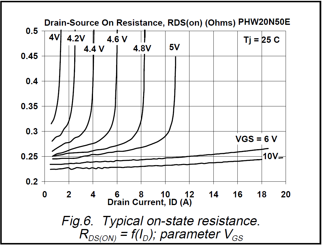

                                          Now go down in the datasheet and look at Fig.5. Typical output characteristics. on page 3 :
                                          Here's how you read this chart :
                                          On vertical (left side) you have the maximum current that will flow through the mosfet (in amps)
                                          On horizontal (bottom) you have the Vds (voltage between drain and source pins)
                                          Each of those lines (curves, whatever) tells you how the mosfet behaves for a specific Vgs value. Note that they don't even bother to use the typical Vgs of 3.0v, they use the 4v value as minimum because that's the one guaranteed to work for any transistor at the default 25c temperature (see chart corner)
                                          So with a Vgs of only 4v, you're looking at the most bottom line: regardless of how much the Vds will be, the mosfet will only allow less than 2A of current to flow through it
                                          With a Vgs of 5v, you're looking at the top line from the set of 6 lines. So you can see that with a Vds of only 1v, the mosfet may only allow up to about 5A to flow through it, but if you design the circuit properly to allow at least 3v between Drain and Source pins, then the mosfet will allow up to 10A. For anything above Vds of 3v, you can see that mosfet will basically "stabilize" itself to somewhere below 10.5A of current flow.
                                          If you want more than 10.5A you need to have a Vgs higher than 5v - for the maximum of 10v (top line) you can see the mosfet scales almost linearly with the Vds voltage : it can do over 12A with a Vds of 3v and almost 20A with a Vds of 5v
                                          Now I have to note again that values are valid only for 25 C : think of the chart being made with the mosfet at 25c , then power the circuit for 1-2 seconds (so that the mosfet won't have time to heat) and literally take a snapshot of the values and power off the circuit. As the mosfet and the circuit board will heat up, those lines will drift a bit (but overall the numbers should still be "in the ballpark"
                                          You can scroll down in the datasheet some more and see how the mosfet will behave with heat (on page 4, Figure 9 and Figure 10 in the picture below) :
                                          So you can see that the warmer the mosfet will be, the easier it will turn on fully.
                                          It's important to know these, because for example you may say "oh, i'll just use 4v and then I'll know for sure the mosfet will turn on fully" but what if your project/design will be outside in a winter when the ambient temperature will be -20c .. 0c ? You can see that the 4v max is only guaranteed at 25 C - at 0C you already need about 4.2v for the mosfet to turn on fully.
                                          The other way is also important .. for example you may say "I'll use Vgs of 4v because then according to the chart above I'll know for sure the current between drain and source will be limited to less than 2A so basically my mosfet will limit the current through the LEDs and I won't need a led driver or a resistor to limit the current"
                                          BUT as the mosfet heats up, you can imagine it behaving like having 5v on the gate, it will basically let more than 2A flow between drain and source pins so in the theoretical example above you'd damage your leds.
                                          Also you can see in figure 9 how with Vgs of 4v, it barely lets 2A at Tj of 25c but at 150c it almost crosses the 5A threshold.
                                          Something else you can see from the datasheet, scroll up to page 3 and look at Figure 6 Typical on-state resistance :
                                          You can see that with a Vgs of 4v even with as little as 1A of current between drain and source, the internal resistance will be somewhere around 0.4 ohms
                                          So you have P = IxIxR = 1x1x0.4 = 0.4 watts of heat dissipated in the mosfet.
                                          But if you use a Vgs of 5v then even with as much as 10A of current between drain and source, the Rds (on) resistance will be below 0.3 ohm and at 1A it will be below 0.25 ohm ... basically with higher Vgs, the mosfet will heat less.
                                          So basically, this mosfet is really designed for a Vgs of around 5v, even though it says it typically can turn on at 3v... if you want the advertised currents and rds(on), you drive it with at least 5v.
