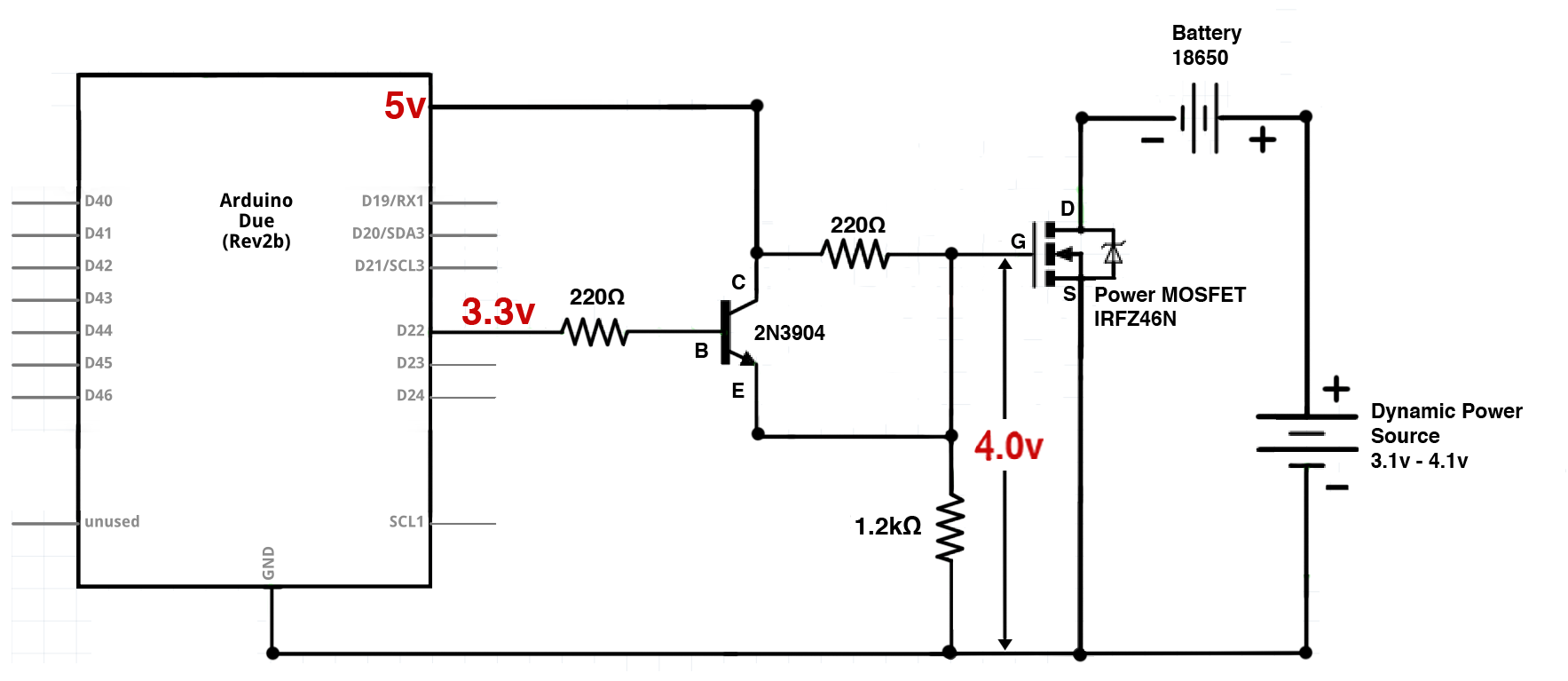

                    Do you think that this layout would work CONCEPTUALLY???
                    Since my Arduino can only output 3.3v, and the power MOSFET that I have is fully on at 4 volts, I thought maybe controlling the mosfet using a 3904 off of a 5v source with a voltage divider might be a sensible way to go about it... ???

                      Where did you get that circuit?Look at the Voltage divider of the 220 Ohms and the 1200 Ohms resistor and how that transistor is connected and the effect of the Voltage on the Gate will be when the transistor is turned on which it will never be on since the Emitter Voltage is higher than the Base Voltage so the Transistor is in reverse bias if the output of the iC in high state is only 3.3V.
                        I made it from scratch.
                        That confirms my readings after building it just now...
                        I was thinking that I wanted to get 4 volts to the gate of the MOSFET using a 3.3v pin on the Arduino ... let me re-think it and see what I can come up with.

                          What are you trying to accomplish? Turning the MOSFET fully on when its needed and fully off when its needed, or PWM? I think you need to understand how to bias transistor on and how to turn it off, if you understand that then you will see why that transistor is off with the Voltage as shown in your diagram, need to understand the basic first.
                            What about this ... though I think I need to re-calc the resistors ...
                              I want the MOSFET fully on when it’s needed and fully OFF when its not needed ... and that state I want to control with by turning the 3.3v pin from the Arduino on or off.
                              AND the MOSFET that I have is not fully on until there is 4 volts at the gate.

                                  Can't you pick a better mosfet?
                                  The one you chose has quite big gate capacitance and high gate threshold voltage (4v)... why not pick one that is guaranteed to turn on at less than 3.3v and simply connect it directly to an output pin.
                                  Use a decent resistor between gate and ground to discharge the gate to quickly turn it off when needed.
                                    Cause I have like ... 15 of these ... ill see if I have any others....
                                    What about this layout?

                                      Well, ask yourself this: I have 1VDC between circuit GND and the BASE of the NPN Transistor 2N3904, what will my DCV at the Emitter and circuit GND of the Transistor has to be so it will be biased ON?
                                      Look up Emitter follower.
                                      http://fourier.eng.hmc.edu/e84/lectures/ch4/node9.html
                                        According to the data sheet, it has to be like .9 volts ..

                                          So if the Vbe is around 0.9V then what do you think the Voltage will be at the Emitter of that Transistor based on your last diagram?
