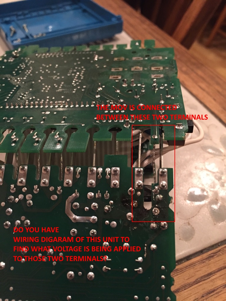

          Upon further inspection it seems that there are a few more suspicious caps I didn't see, could one of these be the culprit?

            I was able to power up the panel with the case off, turns out it's not the transformer that's overheating but rather the cap circled in this picture, which is on a separate board. The cap was cracked open and burnt so I replaced it but the new one is getting just as hot, and it happens much quicker than I previously thought.

              More shots of the board...
              This picture is of a donor board, the cap shown is the one that's overheating on the actual board

                        Are you sure thats a cap. and not a ntc thermistor or maybe a MOV is it marked RV? next to the removed RV2 If its a thermistor it will get warm, if its a mov it is most likley bad

                          It is marked RV1 on the board, here's the specs: http://www.alliedelec.com/m/d/2f6776...201ab01eb3.pdf
                          I'd understand it getting warm but it's getting burning hot within seconds while the one right next to it is completely cool

                            Which value/part number did you install

                              EZRV20D241 - V20241U
                              It was an exact replacement from another board

                                Its a Transient/Surge Absorber, If its getting hot its getting more than 150v a/c or more than 200v dc according to the specs, It is across the 120v a/c line?

                                  Do you have the wiring diagram to find out what kind of Voltage is supposed to be applied to those two terminals?

                                    If you're looking at the picture, the terminal farthest to the right is ground and the other one is 120VAC

                                      So that MOV is across the LINE which how it is used, in normal condition it should not be conducting any current at all. It is for protection, not for the operation of the circuit.
                                      So for it to get really hot like that, I would remove it and see what kind of resistance you are getting.

                                          Thanks bud, it's interesting because once I changed it out the same thing happened, you want me to measure the resistance of the MOV? Surely I didn't replace the bad one with another bad one........that current must be coming from somewhere it shouldn't be, maybe I'll test that with a working panel.....
