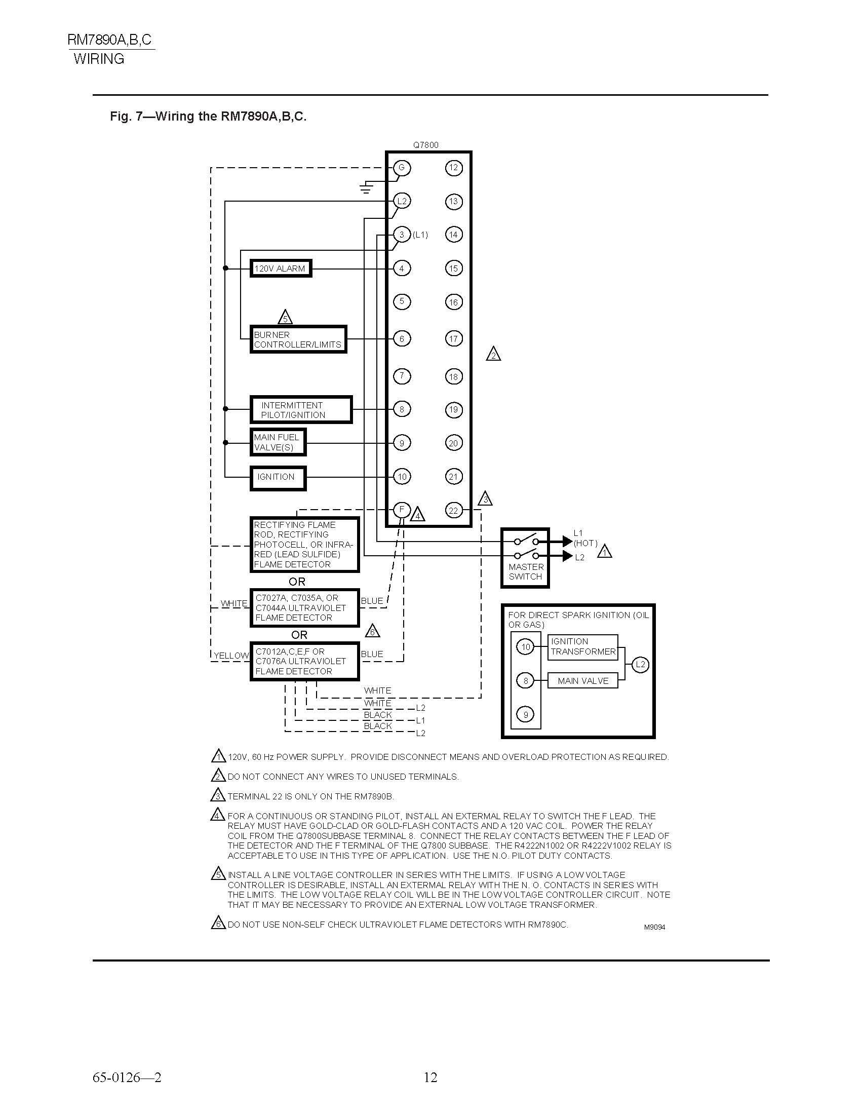

    Re: Can anyone help me identify this transformer?
    So you are using two wires and no safety GND ground wire at all. Are you sure that brown wire connected to L2 (N) is actually Neutral not HOT (LINE/PHASE) wire?
    And if you check the AC Voltage between GND terminal of the outlet and the NEUTRAL of the OUTLET what do you get?
    What do you get between The Hot of the outlet and GND of the outlet?
    Your wiring looks confusing with all those red wires and the way one of the brown wire is connected to pin 6. and it does not seem to match your user manual.

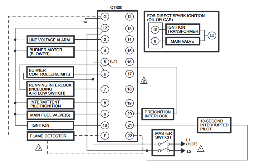

        So how in the world did you get 230VAC between NEUTRAL and GND that you reported then.
        Pin 5 is HOT per the picture of your label.

          #64
          My apologies, I guess that manual is generic, there are slight variations in the models, this one is a 7897 C.
          I'm sure the wiring is correct as I've tested quite a few of them on that panel and they've all worked fine without overheating

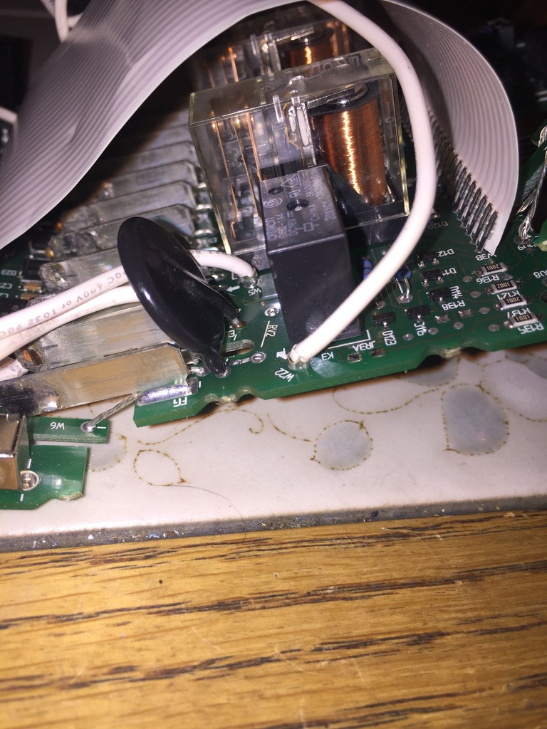

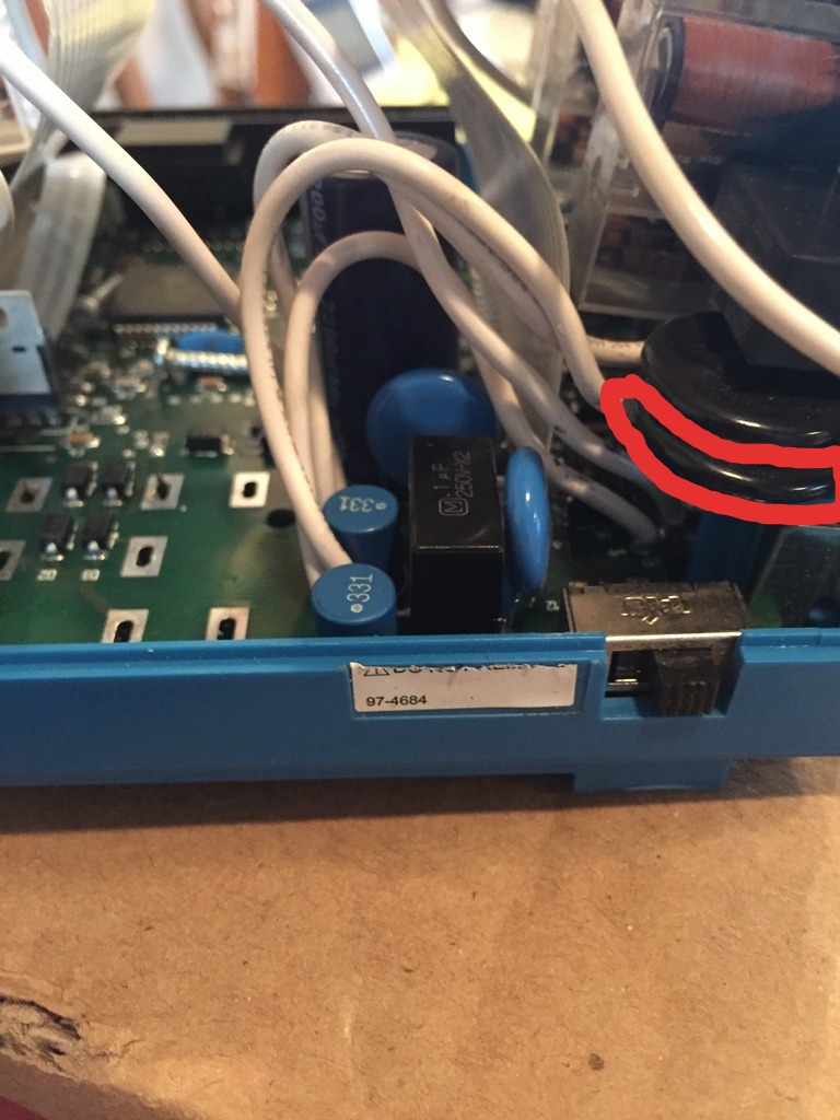

                Are we talking about the same MOV? I only see one Black MOV in that picture which is connected to those two terminals.
                • WHaThEFLuX
                  • Feb 2015
                  • 277
                  #68
                  the black piece outlined in red in post 25 is what I'm referring to, are we talking about the same thing?
                  "You can only learn so much doing simple recapping and fixes. Ideally you want a really hard one to fix where you end up with a lot of dead ends and frustration. Then, and only then, do you learn how things really work."
                  -retiredcaps
                    #69
                    Is this the one we are dealing with?
                    That one with red marking I cannot tell what that is, it does not look like MOV but cannot really tell by the picture.

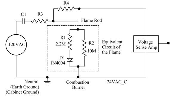

                      There's a few ways this could be happening. First, I'm selling stock in a new company (Mr. Fusion) that can power the world...
                      I think it's the flame-sense HV backfeeding because this is running with no safety ground. This controller probably uses old crappy flame-sense high voltage generator that uses mains? like in this pic.
                      I could see a X-cap and relay/transformer or the ignitor getting resonant and making more than 120VAC. But this doesn't have enough current to heat up a MOV.

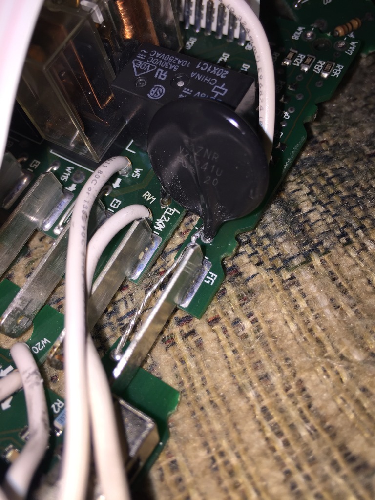

                        Redwire I agree, but that thing is definitely getting burning hot almost instantly, with that much current going through it it makes sense.
                        The component I'm referring to and have been testing is the black circular ceramic cap looking thing with the red marking in the picture.
                        Bud, if that's not the MOV, where is it and what does it look like?
                        -retiredcaps
                          #72
                          Let us see good clear pictures of this thing that is getting hot. Now I do not think it is MOV. I cannot tell looking at that picture.
                          It looks like there are two black discs, but another picture shows just one black disc.
                          I wonder the one that gets hot is the NTC, not MOV. Need to really verify the printing on both devices from WORKING BOARD.

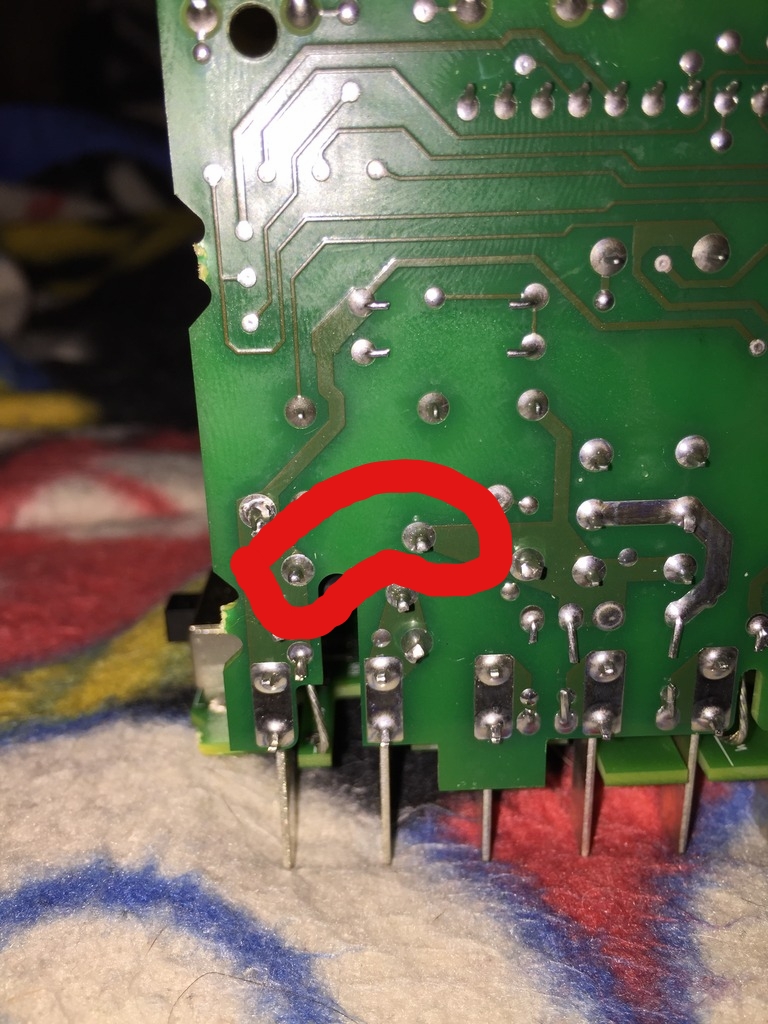

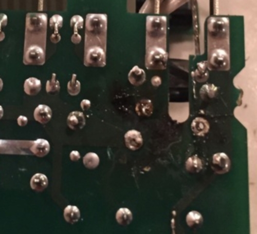

                              Ok lets get this straightened out......
                              This is a picture of the component, NOT the one that is overheating. there is no way to get a clear shot of it, but the two black discs are identical:
                              (In this pic, the black disc in the location I'm referring to has been removed)
                              This is a pic of where the component that IS overheating attaches to the board:
                              -retiredcaps
                              • WHaThEFLuX
                                • Feb 2015
                                • 277
                                #75
                                The overheating component is not actually connected to L2(N) at all, although the one in the picture is.
                                I had to take pictures from two other donor boards but they are exactly the same, my sincerest apologies, I'm making this so much more confusing than it actually is.....
                                -retiredcaps
                                  #76
                                  Picture is showing only ONE disc,
                                  So RV1 is the one that is NOT getting hot.
                                  RV2 is the one is getting hot and it is not installed on the board per the pictures right?
                                  Your red marker is so big so I cannot tell how HOT RV2 is connected to what.
                                  RV2 has the same exact printing on the body as RV1?
                                  It looks like one leg of RV2 is connected to one pin of that black relay contact.

                                      #78
                                      OK, so do you have RV2 from working board that we can see the printing on the body of RV2?
                                      One leg of the RV2 goes to the same terminal that one of RV1's leg is connected to, another leg of RV2 goes to the relay contact.
