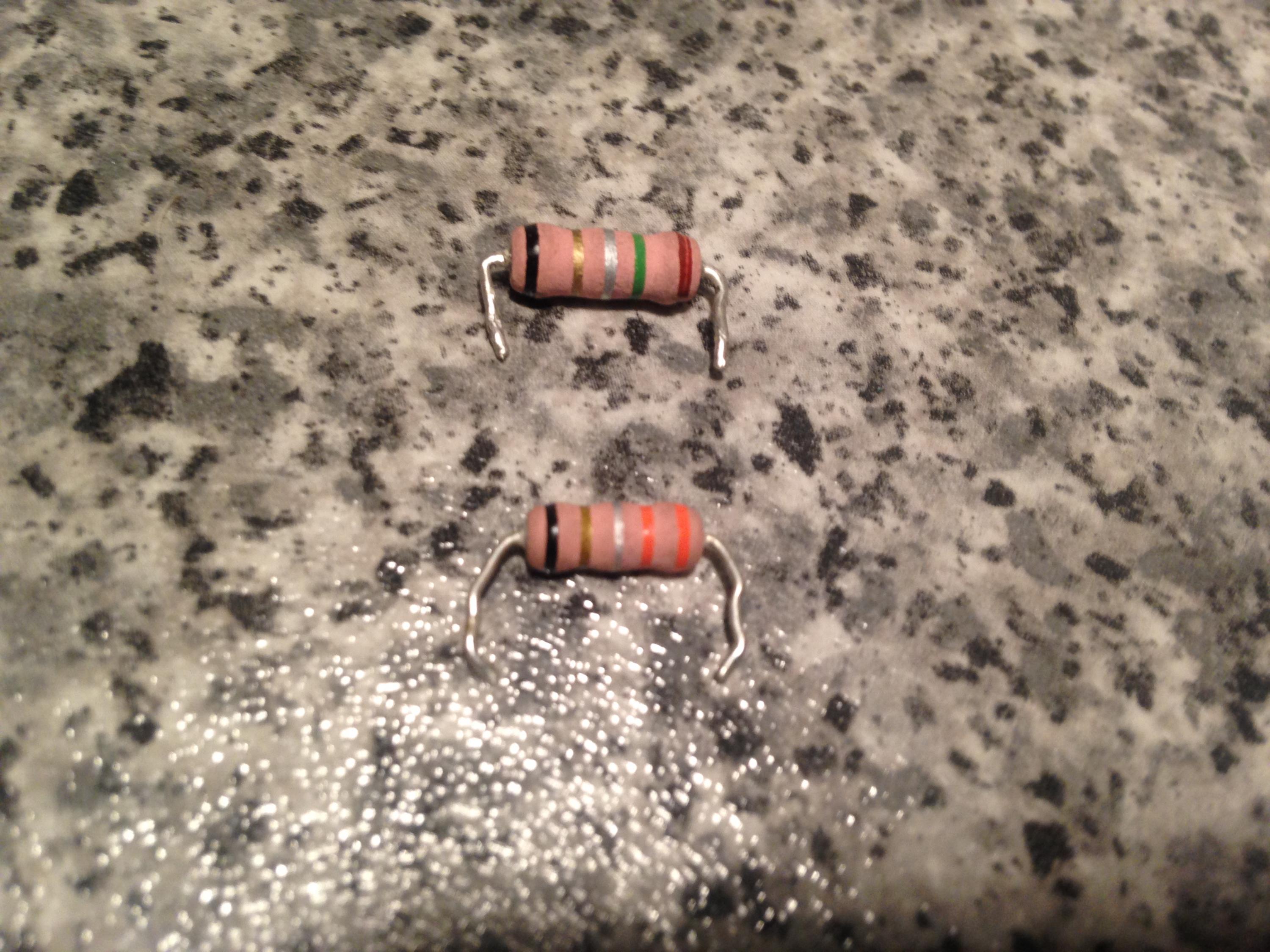

Help me read these resistor colours please?
  • reessi
    • Jan 2016
    • 334
    • uk
    I would like to clarify if I'm reading these correctly, I always thought there was a gap before the tolerance band. Should these be read starting with black as there is no black tolerance band.
    So the top one could be black, yellow or brown?, grey, red, red. So 0, 1 0r 4, 8, 2x0 so either 1.8k or 4.8k?
    The second:
    black, red, purple, grey, gold - 0,2,7,8x0 = 2700,000,000 so 2700Mohm.
    They both measure dead short.
    Also the red bands could be orange?
    The yellow/brown actually looks gold!
    Cheers.

    The first could be
    black - red|orange - violet|blue - silver - gold = 0 - 2|3 - 6|7 - x 0.01 - 5% .. probably 0.27 ohm 5% 1w-ish?
    The other is weird... no idea.

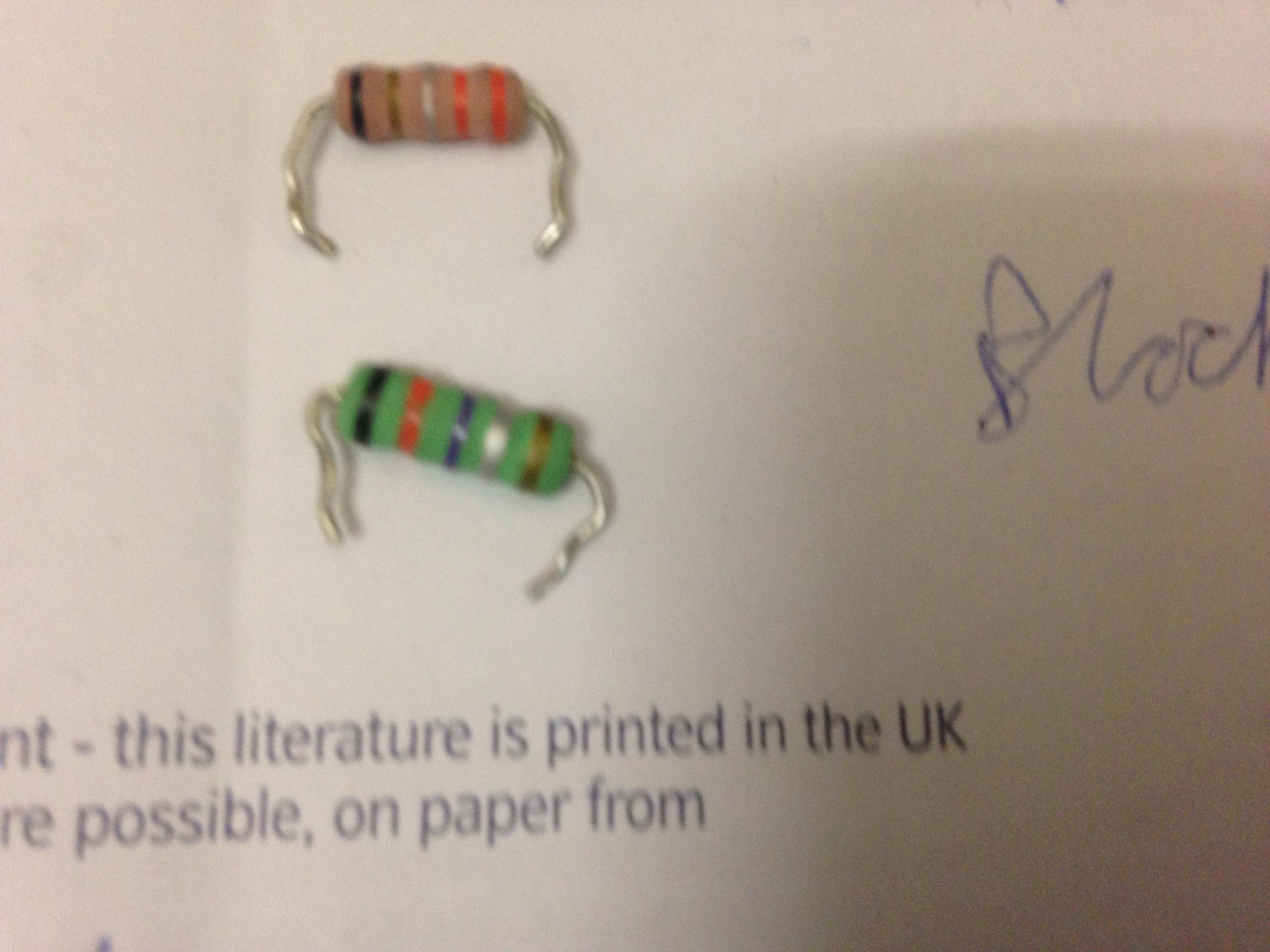

        Ah thanks, that looks right for that one. Anyone solve the other one and a third one I am mythed by. I took another photo of these 2.
        Top looks like - brown, gold, silver, green, red.
        Bottom one looks like - black, gold, silver, orange, orange!
        Both test short but I was already wrong about one, maybe really small again?!
        Cheers.

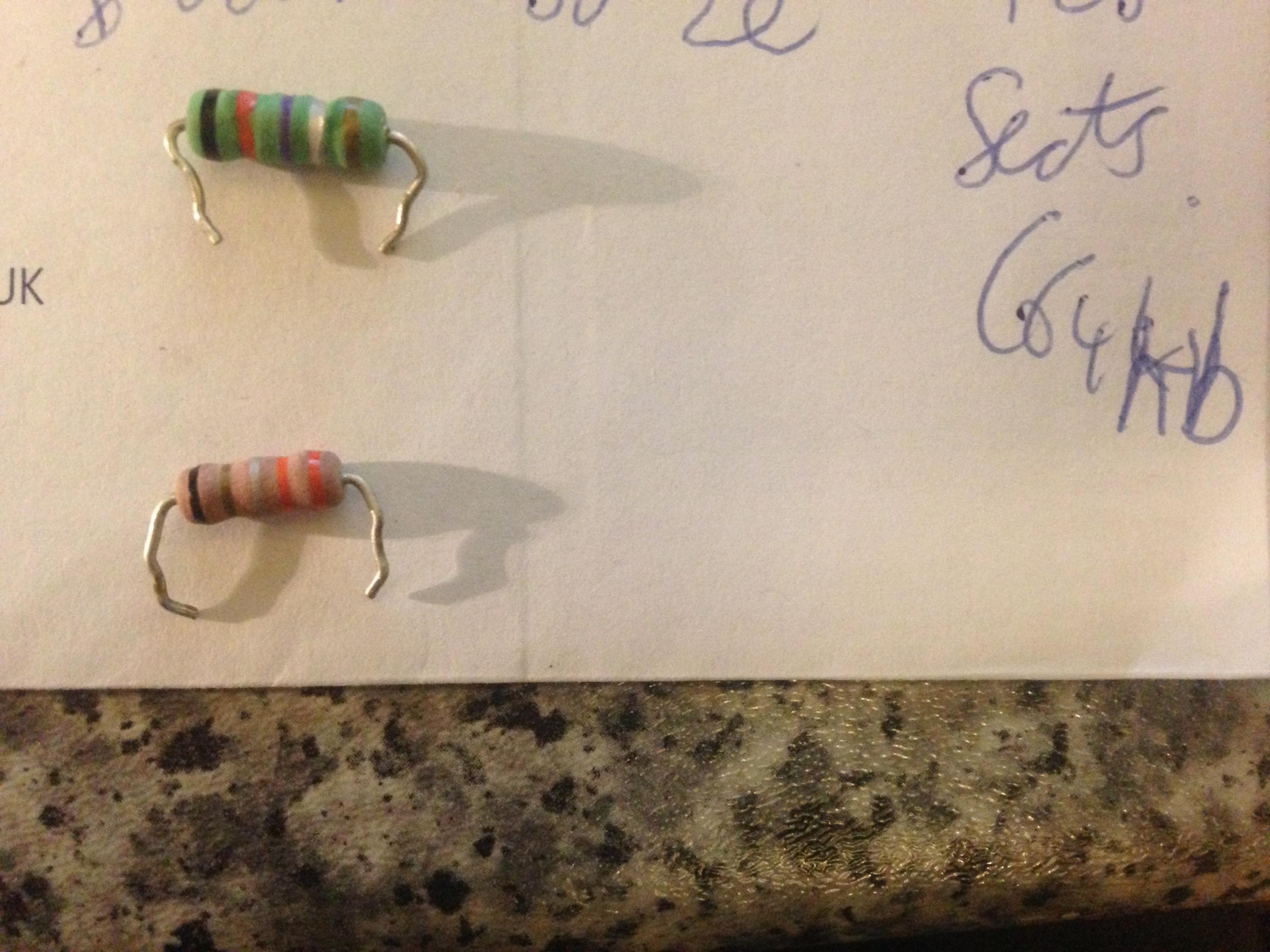

          Thanks Andrew but can you explain the colours on the other 2? Would be handy if I actually understood what they should be, they are probably really small then like the first one but the colour scheme doesn't make sense to me?
          Cheers,

                    most odd .. not military obviously . no silver band on end .. resistor codes dont make sense to me .

                      I googled ( 5 color band restistor ) and found this
                      http://hirophysics.com/Labsheet/resi...sis-codes.html
                      From this cart the it looks like one of resistor is 0.62 ohm
                      I hope this helps

                          Top one is 0.15 Ohms (It looks like Brown not red to me) 5%
                          Bottom is 0.33 Ohms 5%
                          The black band should be for Temp Coefficient.
                          These MOX Flame proof resistors are not marked the same as regular resistors.

                              Ok, that makes more sense budm. They read like 4 band and the 5th could be like you say co efficient.
                              Why did you say to dis-regard?
                              To vinceroger69 the psu is EAX65359511 from Plasma LG 50PB560B. I have created another thread on the repair if any of you can help.
                              I think the resistors are solved or at least we know why they tested short because they were such low values!
                              The PSU I have now tested on the bench and forced on with a resistor and appears to be fully working outside of the set!
