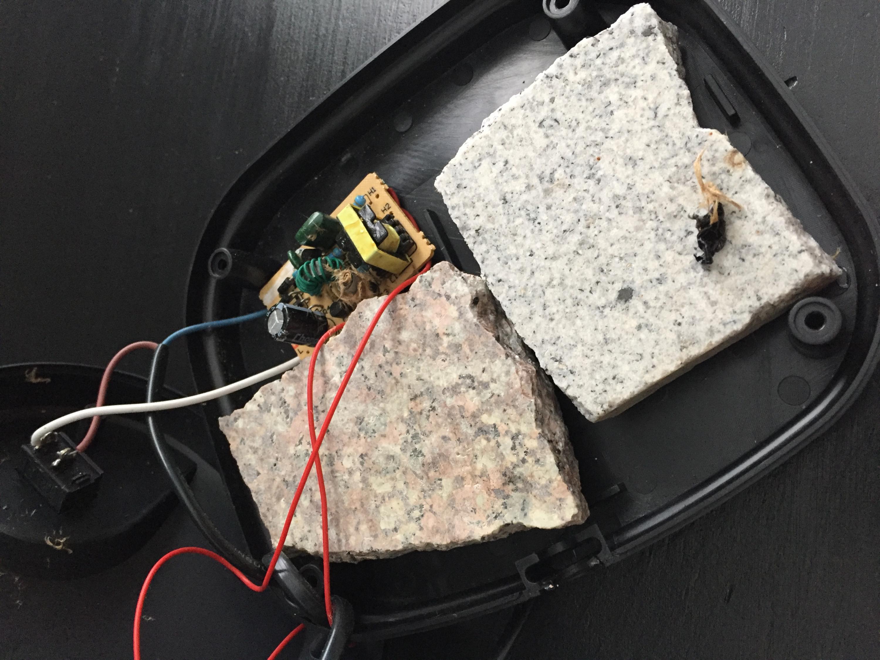

    Turned it on and heard a loud pop, opened it and a small 10uf 50v electrolytic capacitors had blown up.
    Is it safe to replace with a higher value like 47uf 100v? Or does it have to be exact value of old?

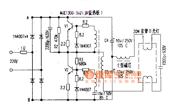

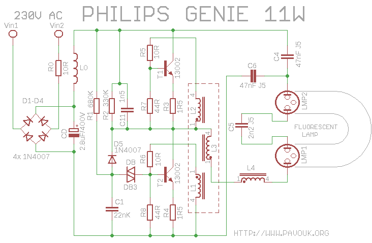

          That capacitor is probably for limiting base-drive, so if it popped I think a transistor is shorted. Usually the lamp fails open circuit and then the PSU dies.
          These schematics are similar to your circuit but not exact - it's a two transistor resonant oscillator. The Philips/Osram one has no 10uF 50V cap.
          I don't see filament connections in that desklamp, only 2-wires leaving the PSU.

                            Revisiting this. Changed the cap and one of the transistors previously and it worked all this time.
                            Just recently quit again, this time no caps blew up and no shorts on the transistors or diodes or any of the caps (tested in ohms settings)
                            Any suggestions? I should just replace it but curious to get it going again
