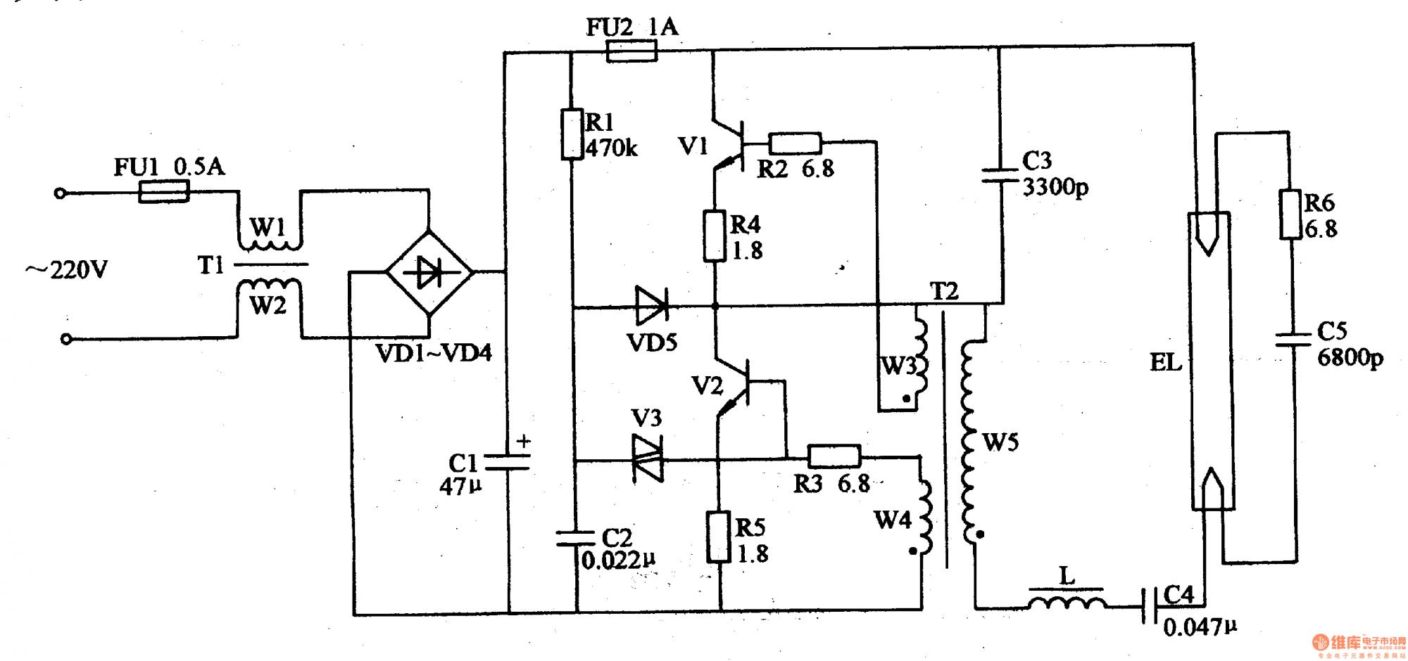

    This is cold-cathode? I see only two red wires going to the tube, but the fixture's schematic shows four wires.
    Philips Circline fluorescent tubes are all 4-pin hot-cathode (for starting) and they mention run voltage 61-84V for the 20-30W class T9 (12") size. You don't need really high strike voltage when the heaters are on, I've manually lit tubes then with even 24VAC.
    I think it's not a good idea to measure output voltage because it's high frequency AC which many multimeters can't read, chinese multimeters rolloff above 2kHz for example. Also, it should be high voltage with no load (tube not lit) which can kinda damage a multimeter.

      @redwire Yes that’s the one you’ve linked. There are 4 wires that connect to the lamp itself further up and two of them have a capacitor across them.
      What’s a good way to test if the circuit is functioning properly? Can I just ohm check the lamp to determine if it’s not open inside?
      Do you know what voltage I should expect at both transistor pins?

        The two "ends" of the tube should appear open circuit at the voltages of a DMM, and the two filaments should be like incandescent filaments.
        Oddly enough I had a iinear F15T8 fixture that had a magnetic ballast that I replaced with a CFL circuit. The lamp turns on right away -- however, the CFL circuit does not heat the ends hot enough so basically it's running the lamp CC and though some tubes light, there are some F15T8 bulbs that do not light up in the fixture anymore.

          At the lamp, you should get low continuity at each end (between the two filament pins) and of course nothing end to end. Compare it to the old tube.
          It seems like the oscillator is working because you measure some ACV on the output.
          I would test the 47uF electrolytic capacitor that had blown up before and the film cap at the tube.
          How it seems to work is the filaments at each end draw power through the film capacitor that is across the tube ends. It's just a dumb oscillator going for max all the time. No starter circuit.

                  The lamp tests good. The capacitor not sure if it's good or bad but could only measure in ohms and gives a reading of 1.2 ohms across it when disconnected from the lamp
                  I may have previously measured voltages incorrectly. Those reading were DC when I try measuring AC it only reads 1.2vac at the wires going to the lamp

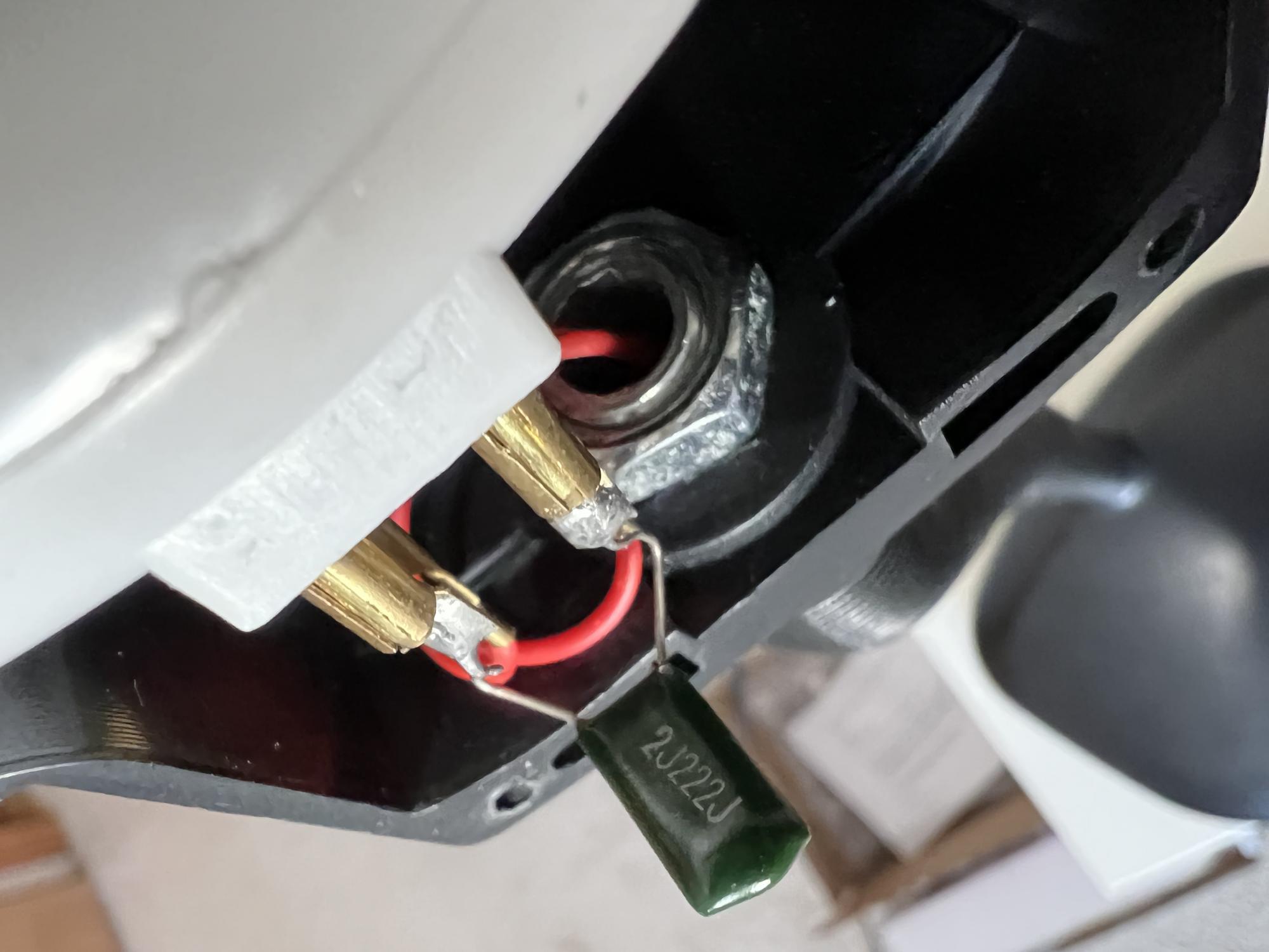

                        This is the cap that bridges two pins of the tube (that connects the two heaters together)? Might be able to test it, but without it, it's really running cold cathode now. However with it shorted it would cause other issues...

                            Yes it bridges one of the two filament pins. I tried without the cap but still nothing.
                            Im confused on how you would test this circuit if the output voltage is high frequency. Is an oscilloscope required?
                            And is my understanding correct that mains ac is converted to dc and then back to higher ac voltage to get the lamp running?

                              yeah without the cap the heaters wont heat and need a higher voltage to cold cathode start the lamp.
                              You need a faster high bandwidth RMS multimeter if you want faster results, or you could rectify the voltage with a diode and filter with a capacitor, but be careful of loading down the circuit.
                              Yes pretty much these things do a switcheroo from ac to dc and back to ac. The higher frequency is the main reason for doing this, not necessarily the higher voltage.

                                    Turns out it was the green cap across the lamp terminals. Didn’t have exact one so momentarily substituted with a 483pf one. Lamp lit then went off and puff of smoke came from the circuit board lol. Guess using the wrong cap for testing wasn’t a good idea? Lol

                                      Yay magic smoke
                                      483pF? not a standard value, weird.
                                      Original appears to be 2200pF?

                                        At least that's what my capacitor tester said. Yeah original is 2200pf
                                        Would the smaller cap cause the light to go out and cause secondary issues?

                                          Would have imagined no cap could possibly do damage, then too small cap would be the same, and shorted thus be the 'safest'... but who knows how the circuit was made.
