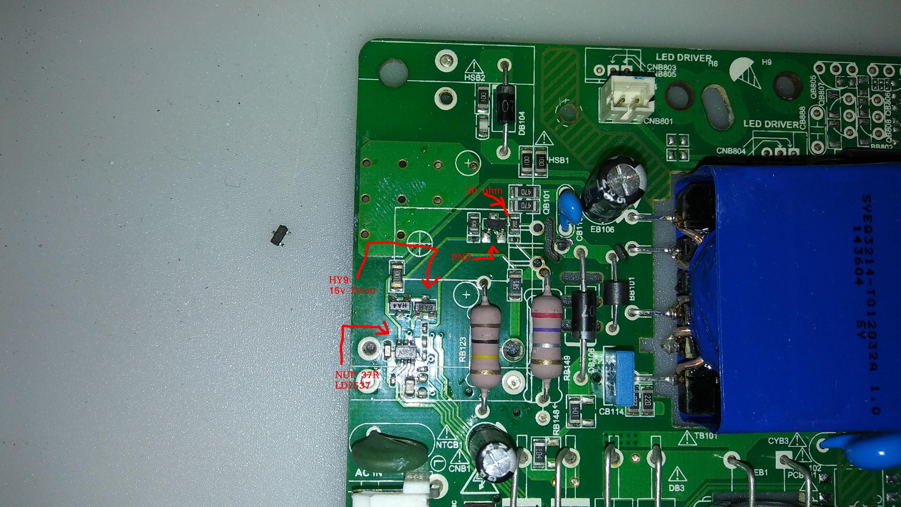

HY9 is a Zener for ? voltage
    Re: HY9 is a Zener for ? voltage
    So QB102 Gate discharge transistor is also bad?
      Yes, QB102 marks H2A is a PNP Tr, shorted at Collector and Emitter.
      Each parts are coded (or no mark) really time consuming to repair.
        Question? i forgot put CB113 back but PCB works(has DC12v), what is the CB113 for?
          It is connected in series with the resistor to form RC snubber for the rectifier diode, you better put that back in place.
          BTW, that GATE discharge Transistor tested off board as shorted E-C? I am surprised that the SMPS IC output drive was not damaged too.
            RC snubber for the rectifier diode, you better put that back in place. I did.

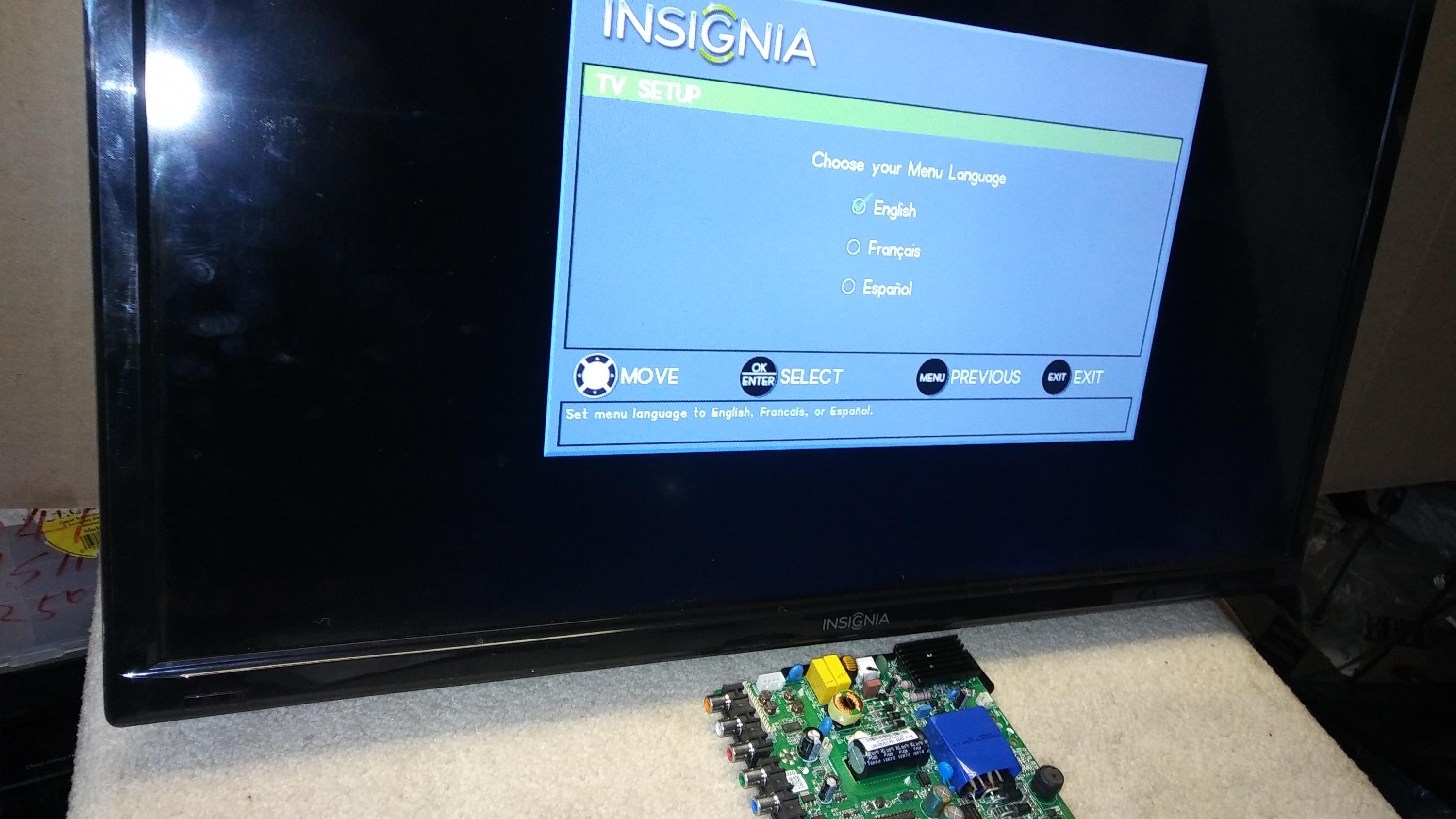

            Now TV (NS-29D310NA15) is under testing, underneath PCB was the one I ordered on ebay( is good).
            Question : Why the TV is in setup mode? TV came with no standby.
            • capwizard
              • Jun 2016
              • 1991
              Because someone swaps the EEPROM that was me..............
              I thought it is the EEPROM....then I found out TV does not has 5vSB................
                Another priceless tip for you, after visual inspection ,and some checking of the fuses or protection devices, then check the Voltages and see if they are present or present with correct Voltages or not, no Voltages no working.
                • capwizard
                  • Jun 2016
                  • 1991
                  Thank you. With your tip I can save 1 day's troubleshooting.....
                  This one PCB TV has no connector for testing 5vSB when I check 12 V does has Vibration voltage. After I change EEPROM still not works then I check no 3.3v.
                    Stand-by voltage must be present on Vcc of SPI Flash memory,on Vcc pin of IR receiver.
                    Easy to check if PSU is inaccesible.
                    On some units is 5V in other is 3.3V

                      #30
                      Thank you, I forgot about it. (IR receiver or Buttons)
                        #31
                        NUP 37R : https://www.badcaps.net/forum/showthread.php?t=60813
                        Well, that come from experience to be able to section out the board to see where the STBY power supply is and look at the cold side of the transformer where the rectifiers are to see if it is alive or not.
