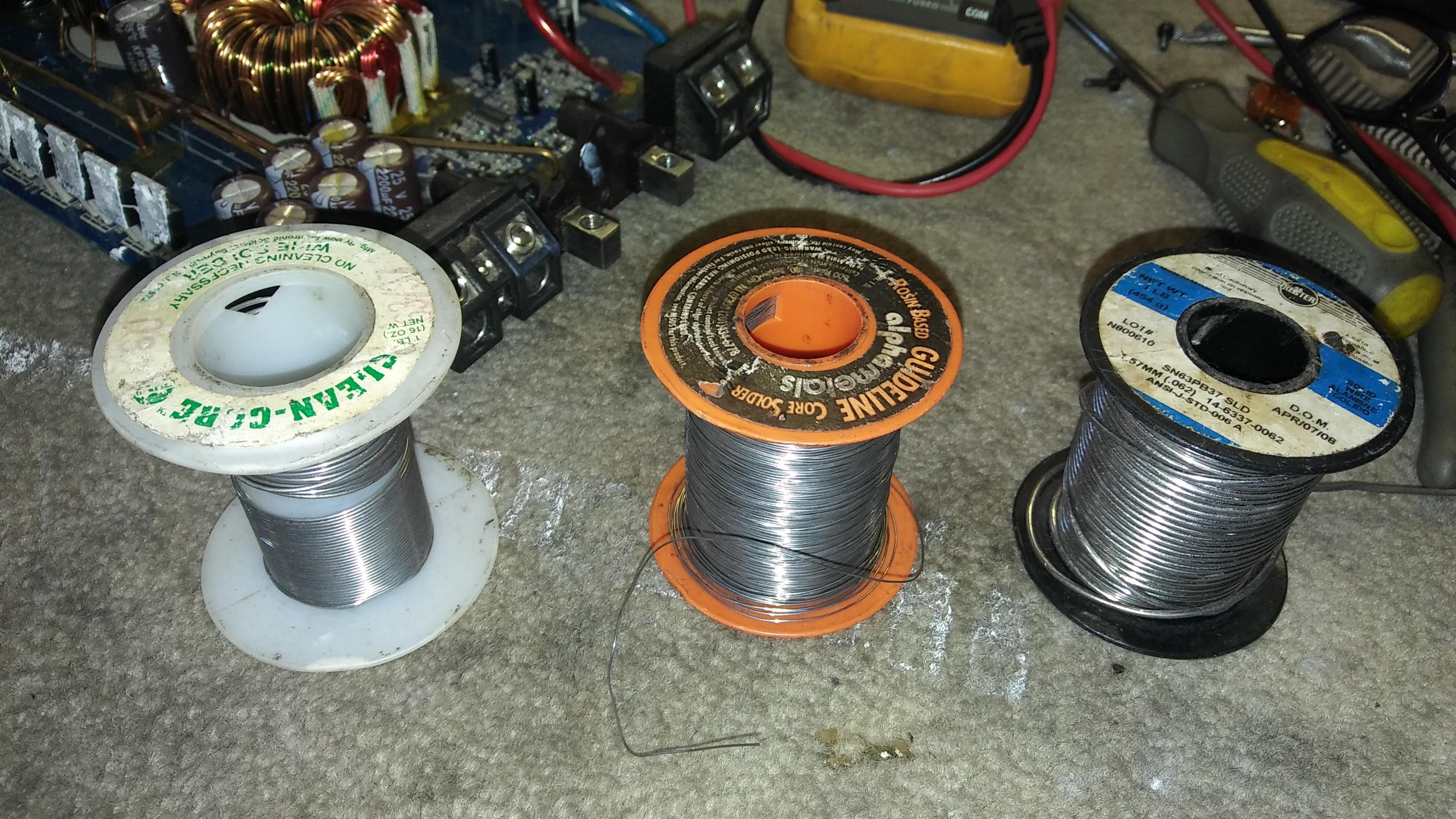

      [excuse the imperial measurements]
      wow. That's crazy, then again anything that's an "audiophile brand" goes for quite a bit.
      400g ~= 1lb (well, less than 1 lb, but at $130/lb the math is easier).
      Solder prices have gone up since when I first started looking, but I thought the going price is around $16/lb now.
      Then again for a hobbyist, 1lb solder will last a long, long time, and one can afford a one time charge. I think all the solder I've ever bought:
      1 0.5 lb roll of 60/40 0.08"
      1 250g roll of 60/40 0.04"
      1 0.25 lb roll of lead free 99/0.7 0.04"
      I grabbed a spool of 63/37 0.031" with 0.25 lb left that someone was dumping.
      and some leftover solder wire from random places that probably weighs less than 0.1 lb...
      I don't see myself buying any more solder for the foreseeable future, unless I need to solder copper pipes.

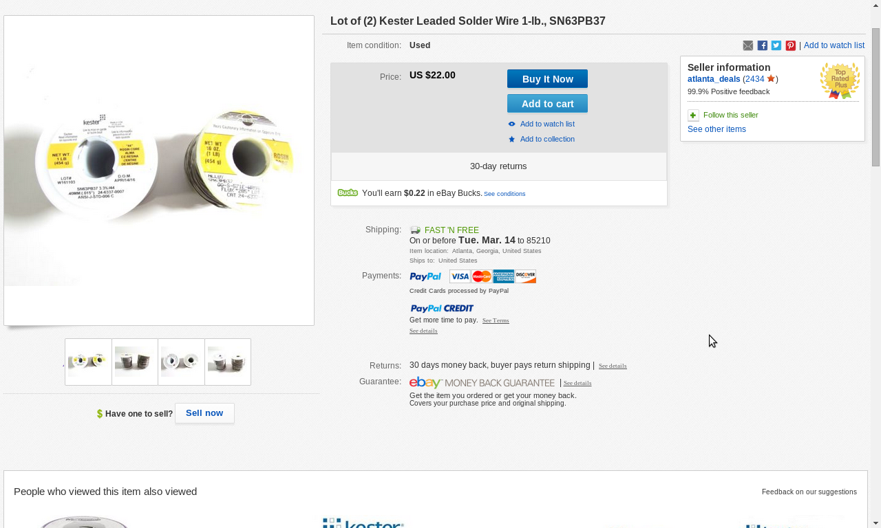

                    mariushm Thank you very much for your advice.
                    pic1 : Kester solder wires : Lot of (2) Kester Leaded Solder Wire 1-lb., SN63PB37 two for US $22.00
                    WoW...It is A steal , I bought it right away , I am extremely HAPPY. I do not need to use the low quality solder anymore. Good solders will pay for itself. At the meantime, I will feel guilty to put low end solder on customer stuffs.
                    "SMD parts do not need any solder I just use Hot Air put it right back"
                    I used to put a homemade Flux for SMD parts resoldering, recently I just lazy to put it , I will from now on. Thank you.

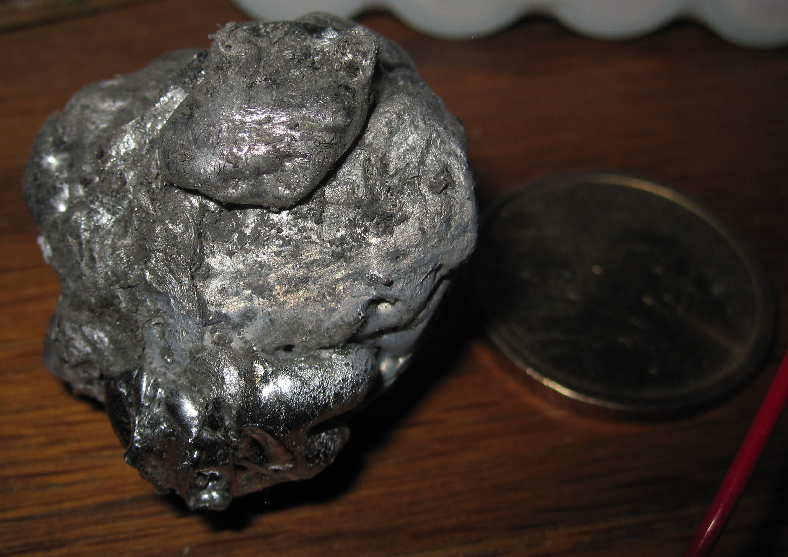

                      BTW, I still have a fairly significant ball of used solder, would be nice to make a wire out of it once again and use it as fill solder when external flux is available, instead of wasting fresh solder...

                          Re: 1lb solder US $136.00 ?
                          At this point I've stopped "growing" this "main" ball every time I get excess waste solder, and growing a second ball. Then I merge the two when the second ball gets large enough. All the waste solder from my desolder pump and any spilled solder gets dumped into the waste instead of the trash. Most of the solder is from desoldering.
                          At first I was using my 45W solder iron to grow the ball, but yes, now I have to use a butane torch to add to it as the thing takes forever to melt to grow now as it has so much thermal mass, it sinks all the heat away.
                          I suspect the tin:lead ratio to be near 70:30 now with lots of impurities such as ash, oxides, and copper/iron from broken wires and leads. I would have thought it should be near 60:40 but with additional ROHS solder, who knows what the ratio is now.
                          It would be neat to make this thing into one continuous wire.
                          (That's a Sacagawea US dollar coin along the side. The outside diameters of the two are similar though the picture makes it seem like the ball is immensely larger. The ball is just a bit larger than the diameter of the coin.)
                          [edit]
                          You know what, perhaps this thing should live its life as recycled solder paste instead of recycled wire...

                            Thank you. That is the Meteorite from the Space. ................
                            I think you need to copy the Russian ( in this youtube video) files this Meteorite down to metal powder to use it. It is very good weapon for self-defence if you ever need.
                              I got a small ceramic pot (i.e. soufflé dish) and melted it down. Got some of the impurities/ash out floating on top. Unfortunately now it no longer looks like a meteorite, but a fat metal disc... Still probably hurts though no scratches if thrown at someone.
                              I'm sure I'll be adding more to it, though probably not very quickly unless I have another salvaging session.
