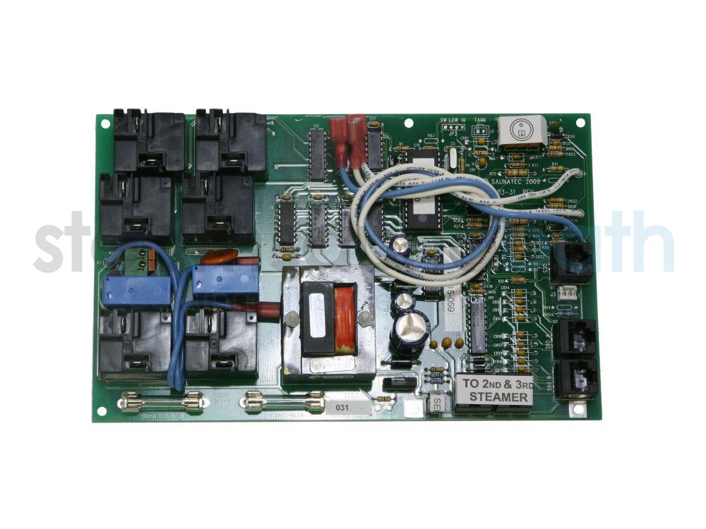

                            Actually sir i want to modify this circuit. The modification is i need to connect 8 parallel relays with the relays on the board. Now total relays will become 16. Actually the relays on board burn mostly and very difficult to change again and again so i need to connect external relays in parallel along with the relays on the board. when the board will turn on the board relays at the same time the external 8 relays will also be turned on so any time if the external relays with base will be burned out i can change easily. so is it possible or ic will be not be effected by dealing with 16 relays at the same time? I am so confused so give me some solution to make this project successful please. I shall be very thankful to you.
                            • waqqas.qayyum1
                              • Feb 2017
                              • 21
                              • Qatar
                              Re: ULN2003 max input voltage?
                              actually i will solder 8 more relays from down side in parallel with the relays on the board. so the relays on board will be dummy or will not take any load. the same new relays will be operation and can be changed at any time in case of any fault. so this modification will work or not?

                                Well if you did the math, each relay will draw around 70mA, and 16 of them is well within the 2.5 amperes the ground pin can handle. Calculating it out, you'll dissipate 1.4W worst case, which will make the chip quite warm, and it's probably not a good idea to run that much power through it.
                                What's the expected duty cycle of the relays, will they most/all be "on" most of the time, or will they be cycled frequently?
                                I would suggest removing/disconnecting the old relays from the board if you can... that would get around the power dissipation concern during the worst case scenario.
                                If only one (or in your case, two) relay(s) will be on at any one time, then you don't have to worry about it.

                                  actually all will not be turned on at the same time. According to this cct 6 relays (for heating elements R N, Y N, B N) will work at the same time. 1 Relay ( inlet solenoid relay for water intake) will work when all the other relays will be off. and the last relay ( drain relay ) will work when the rest all will be off. so external relays if i will add in parallel will work in together with the board relays like 12 relays at a time and 2 relays at a time and 2 relays at a time so it makes total sum of working of 16 relays.
                                    very difficult to remove the old relays from the board. It damages the board actually

                                      Also consider how much time the whole device is turned off, but if it's industrial and needs to be operating 24/7 then you can't take this into consideration.
                                      Up to you, take your chances on it, it could go either way. You're best off adding more margin of error to make sure it won't fail (doubling up on the drivers or removing the redundant relays), but at least on day 1 it seems like it should work fine.
                                      And yes the IC will feel quite warm to hot when the 6x2=12 relays are on... which is why I don't know about the long term reliability.
