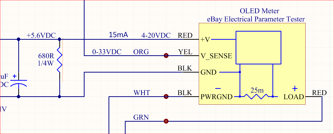

            The panel meter will run quite happily on the 9v winding. It will go up to more than that once I drop a cap on it after the bridge rectifier, but the meter can handle up to 30v so we should be fine. It's the other winding (for the board) that I'm trying to step down, since I need 12-something volts to power the kit I linked to.
            THIS is the panel meter, in case you're curious. The schematic shows it using an individual power supply. If I were to power it from the same adapter as the load, the GND of the DUT would become the same as the meter's GND.....not entirely sure if that's a good idea...

              Not clear but have to assume the panel meter is not isolated.
              The load board probably can take a wide range of voltage input, with a minimum of probably 11-12V to be able to saturate the MOSFETs. Can you use the 30V to power the load board? It shouldn't use much power, probably can use a LM317 or something to get the voltage down to 12V (or higher, probably fine) without too much dissipation.
              I think whatever you can do to get the load board to run with the 32V supply would be your cheapest option. A regulator to 12V like a LM7812 is enough, and if that's too much dissipation (it shouldn't use that much power, I'd imagine it only should draw no more than 100mA or so) you can use a LM7815. You may even be able to go higher with a LM7818 or more, but looking at the schematic you should not go past around 20V. I would suspect the PSRR of the load is fairly high so you don't even need to regulate that much, just need to make sure you don't go past 20V.

                  I have the red/blue LED version of that panel meter. It uses HM5333B LDO for 3.3V and draws around 15mA. It's fine with 5V input power.
                  The current-sense is not isolated from the voltage-sense or from LED power, there is a common ground node.
                  Internally it is like this other OLED panel meter.

                    I'm surprised those meters only draw 15mA, LEDs are usually more hungry than this. You can bet an ICL7107 and 4x7-seg uses quite a bit more power.
                    Also the isolation that's necessary is between the measurement jig and the measurement electronics - between the measurement modes is not absolutely necessary.
                    Also keep in mind there is a maximum voltage for the 7812 (35V?), you may need to use a LM317 instead, as it doesn't care about the absolute input voltage. You still need to worry about its drop, dropping 20 volts at 100 mA still is two watts and that will still get quite warm.

                      For one power supply project, I wrapped around 10 turns on the power transformer to make an aux winding for the panel meter. If there is room, just try add a winding, thin wire. Then you just need a bridge rectifier and filter cap.
                      I think the current drain is so low at 15mA because the displays are multiplexed, so only one digit (out of eight) is on at a time.
