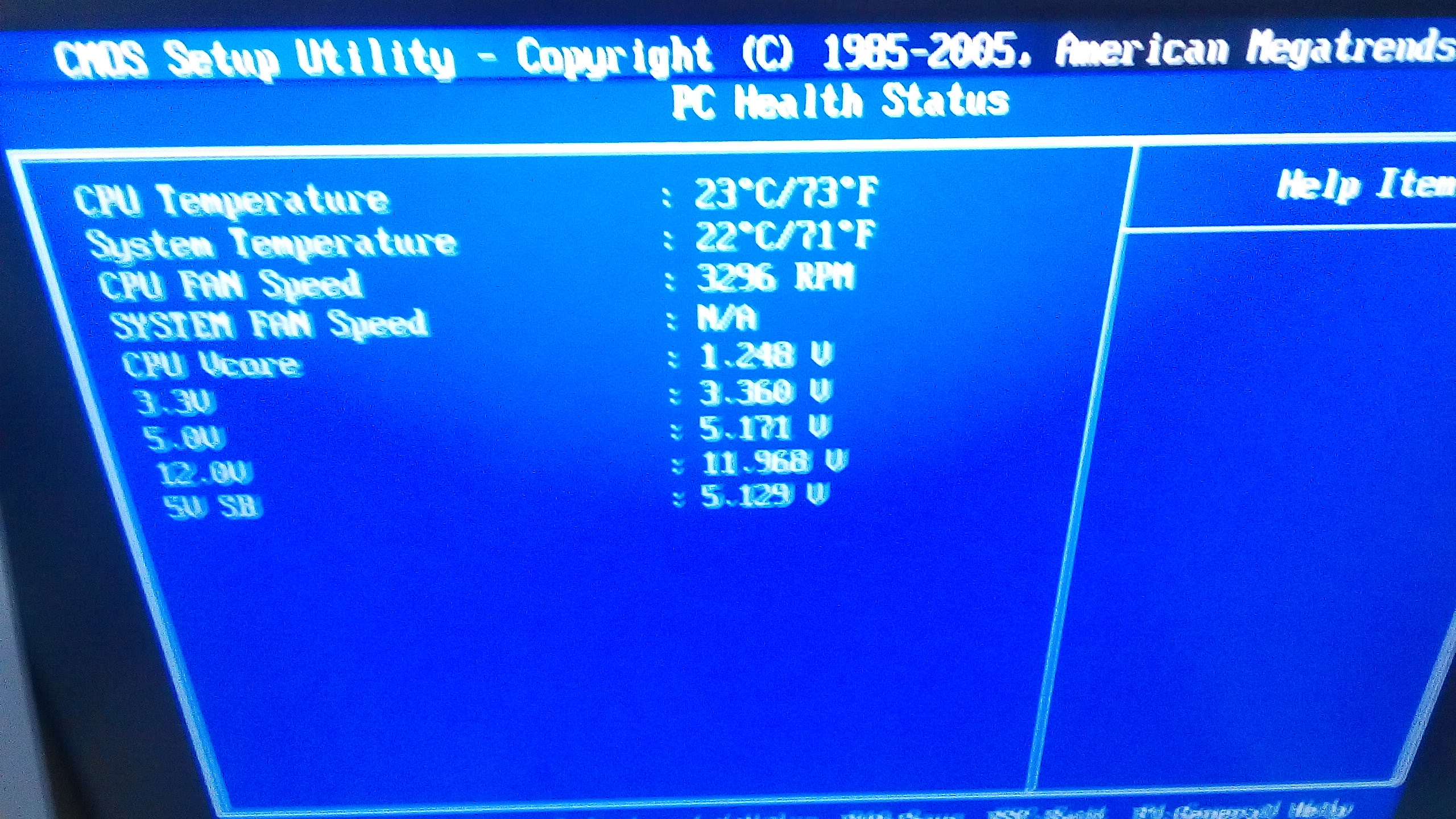

    Guys,
    I have something in my mind,
    Is it possible that I use lithium grease as a CPU thermal grease ?
    Cheers...

    I'd just use some AC MX-2 i have but I think they have MX-4 now.
    If you are out and it's very temporary another aussie used vegemite. Cracked me up when i read it years ago. www.dansdata.com/goop.htm
    I'd say lithium may get runny when hot and weep the liquids from the solids in it. I know my lithium grease gun will leave a pool under it anyway.

        it has a high melting point for lithium grease :
        https://en.wikipedia.org/wiki/Grease_(lubricant)

              You won't believe what I've been using! For the price of cheap silicon paste (.1 oz) I can get a CAN of general purpose lithium grease (32 oz) and it actually works as well if not better. It's made for machinery and has a melting point of over 90C.
              http://www.tomshardware.com/forum/10...thermal-grease
              I want to use thermal paste....but it's running out....

                As mentioned there are many types of non thermal paste can be used as thermal paste, toothpaste, lithium grease, vegemite, etc The problem is how these substitutes performs long term. Toothpaste dries out very quickly and becomes ineffective, the lithium grease likely to run out.
                Depending what the cpu/motherboard is, there m might not be any thermal protection.
                Substitutes i'd use for testing not long term but considering the cheapness of thermal paste, I don't see the point.

                        Re: Lithium grease as a CPU thermal grease ?
                        Looks like it's better using lithium grease....my CPU AMD Athlon 64 x2 is doing 22 degree celcius...constant...I put it for few hours test already...
                          That is lower than room temperature (ref. to 25c).
                          How is the temp measured? The reading in the BIOS? The HWMONITOR?
                          What is your room temperature?
                          Are you sure the reading is accurate?
                          • bianchi77
                            • Jun 2016
                            • 1121
                            It's measured by BIOS directly...the sensor is on the bottom of the CPU...
                            Yes the room temperature is cool now....around 17-20...
                            • bianchi77
                              • Jun 2016
                              • 1121
                              Have a look on the shot....
