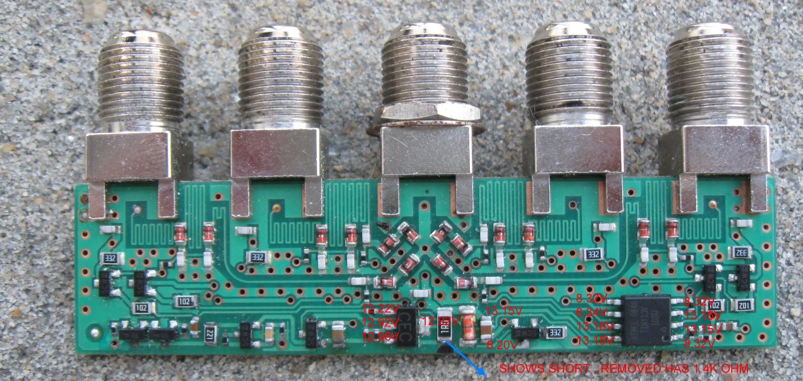

    Guys need help to pinpoint problem
    Worked great til water damage at bottom. I reflowed with flux affected area still not working.
    I then try to look for shorts, I believe I found one on smt resistor labeled
    1RO..
    How do I tested this component I removed it still shows short on continuity and on ohms shows 1.4 K ohms.

    1R0 = 1 Ohm. It would show as a short. So that isn't the problem.
    If the through holes are good, the diodes or one of the chip capacitors aren't shorted, plus the 3 legged SMD transistors, it has to be the TINY13V IC. Check for VCC on pin 8. GND is pin 4. 5cw and the CEC are PNP's.

      Re: Water Damaged Diseqc Sat Switch
      CEC is probably a voltage regulator.
        I guess you are correct. I traced pin 8 of the IC and it goes there.
          "CEC" is a BC869 PNP transistor (20V, 1A).
            guys thanks for help. I do notice burn mark near TINY13V.
            I looked at datasheet and it appears to be programmed chip? can I buy replacement and not have to program it?
            Of course I will have to check VCC and GND when I get a chance.
              Also want to add:
              Port1 works I get signal on sat,
              Port 2, 3 and 4 I get no signal

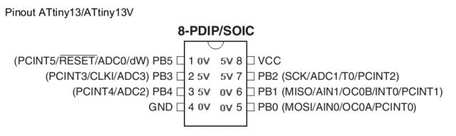

                    I took some measurements It's attach in photo.
                    Check for VCC on pin 8. GND is pin 4, Pin 4 does not go to ground for me.
                    I used continuity between one of the connectors and pin 4

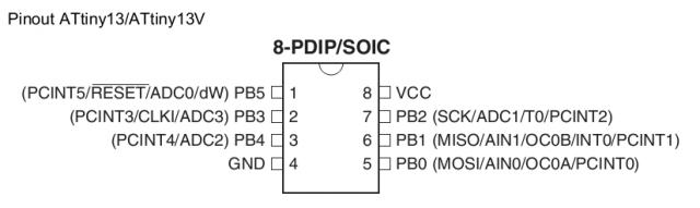

                      The datasheet states that the ATtiny13V chip's supply has an upper limit of 5.5V. Therefore I think that your measurements should use pin #4 as the ground reference for the circuit. Then the voltage measurements would make sense.
                      https://cdn.badcaps-static.com/pdfs/...349050191c.pdf
                      It would help if you were to trace the circuit. At least determine which pins of the CPU drive the base pins of the various transistors.
                      5CW = BC807-40 PNP transistor:
                            ISTM that pins 2,3,5, and 7 of the microcontroller may be doing the port switching. Three of these pins are high, which would be consistent with the corresponding PNP transistors being switched off. The other pin is low which suggests that it is switching port #1 on.
                            I would think that if the micro were dead, then it would be unlikely for it to be behaving as it is.

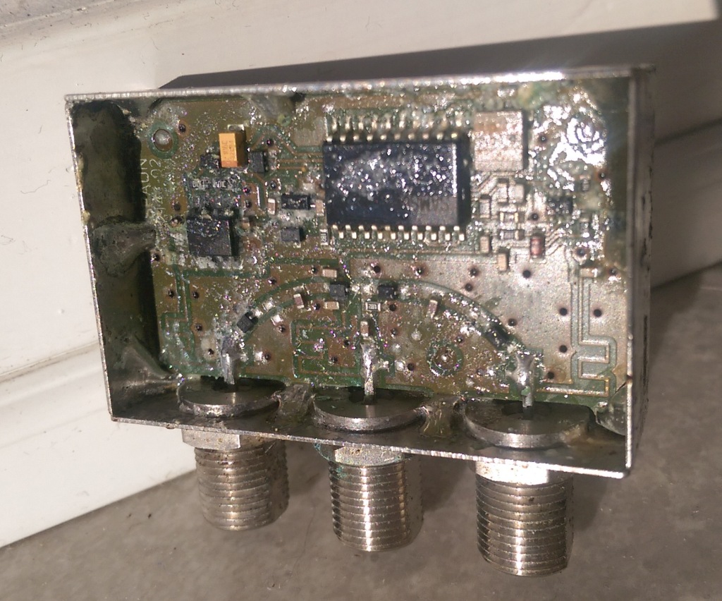

                                      DJ_MIX: Are you sure the problem is with the Diseqc switch?
                                      Maybe this thread could be an interesting read for you:
                                      https://www.badcaps.net/forum/showthread.php?t=21033
                                      Coincidentally my apartment is getting painted.
                                      So they washed the outside walls and you can imagine what happened to my Diseqc switch. (If not see attachment).
                                      So I washed it and then heated it to 50°C to dry it, it then worked for ca 2 weeks before failing again.
                                      Looking at the underside a VIA hole had rusted up... How this $40 switch does not have any conformal coating is beyond me!
                                      I now replaced it with a $5 switch and it's working great again
