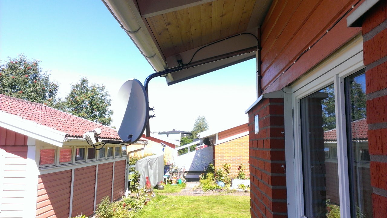

    Originally posted by stj
    diseq switches should be on the back of the dish - or even slung under the lnb-arm.
    and should be sealed the same way you seal the lnb - i use GEL-LOCKS when i work on them - much better than amalgamating tape and you can remove & refit them!
    Mine was installed under the roof, I made the mount myself.
    Of course the painter washing it with high powered jet wasn't in my planning lol
