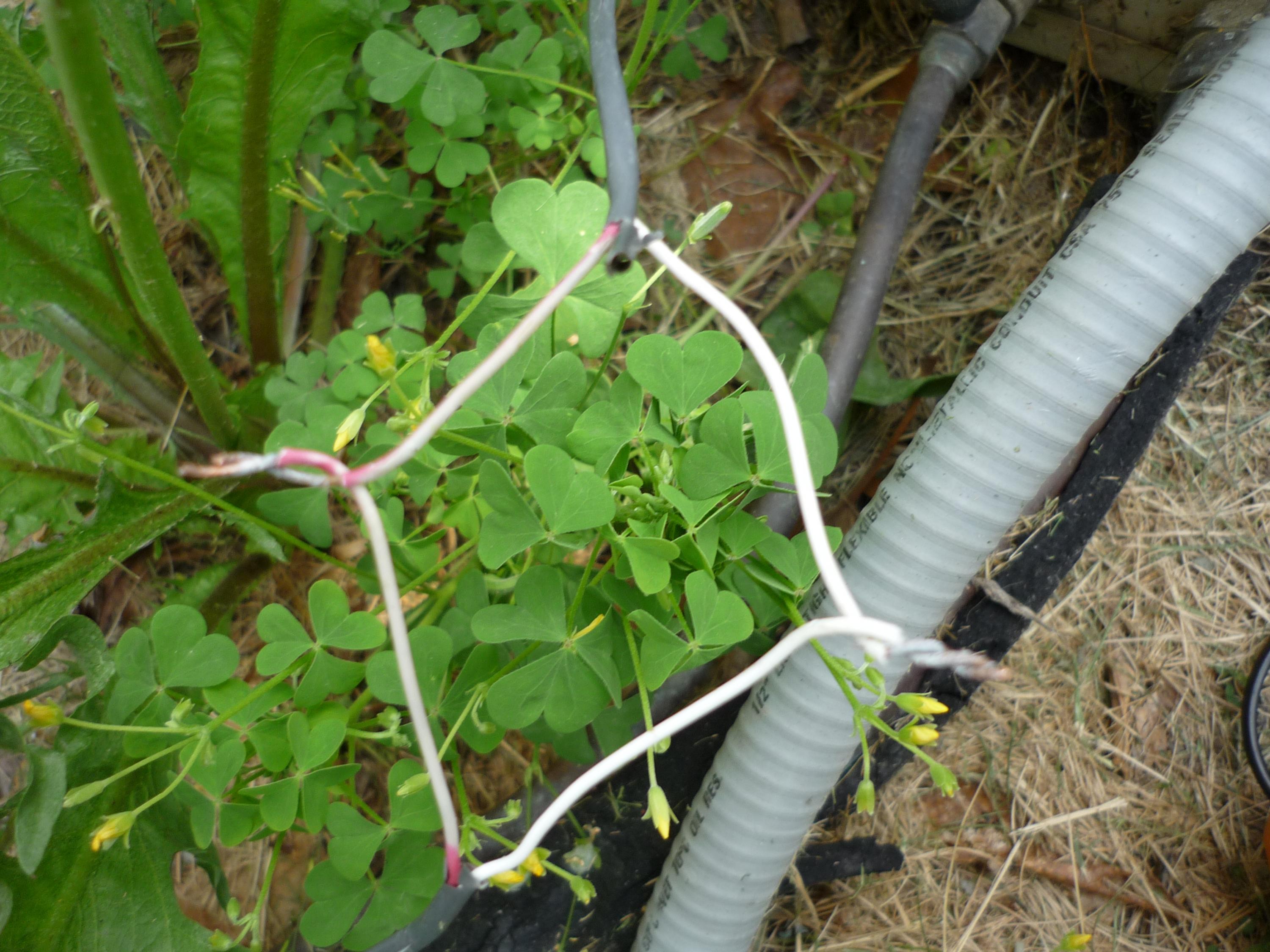

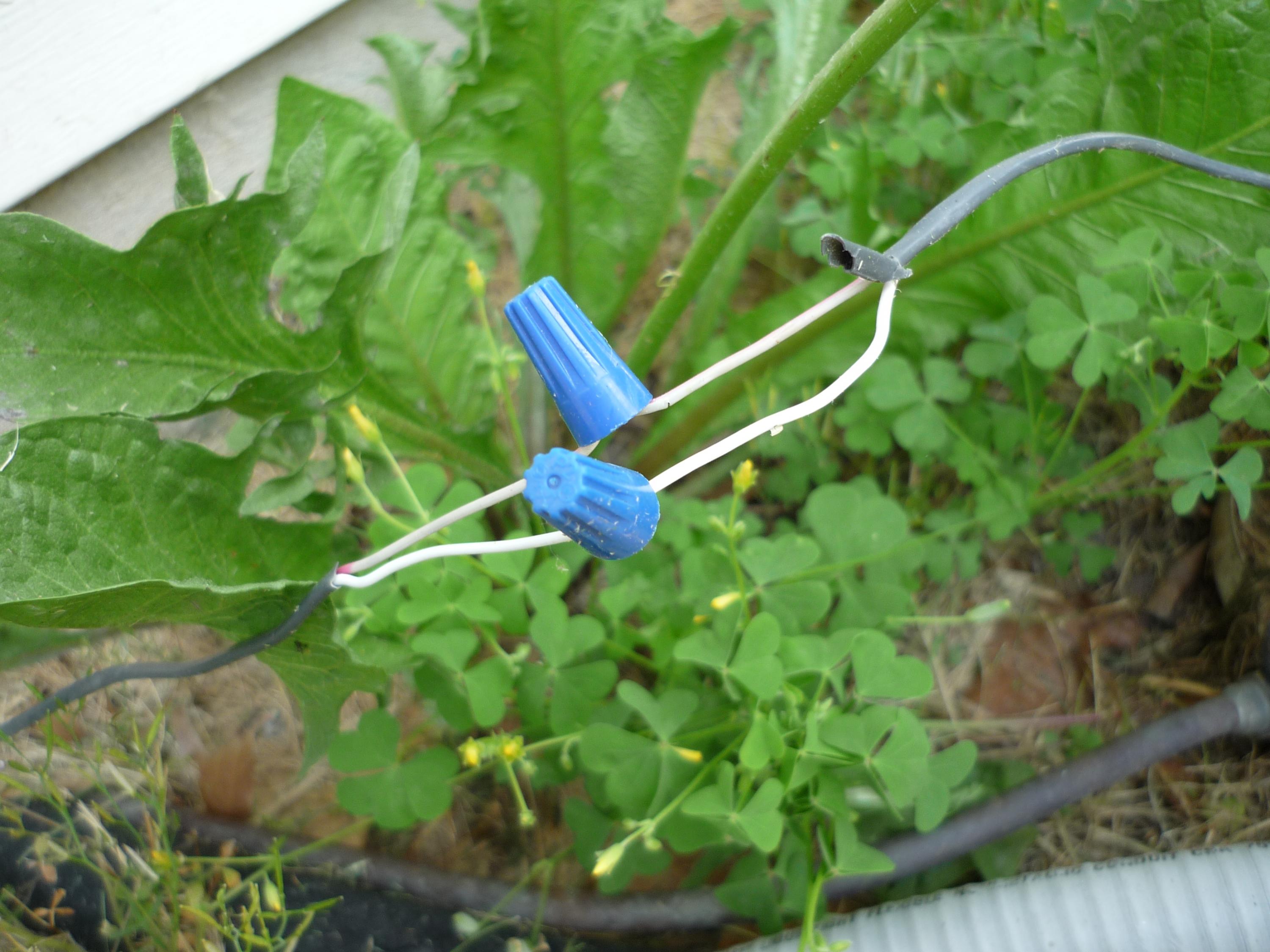

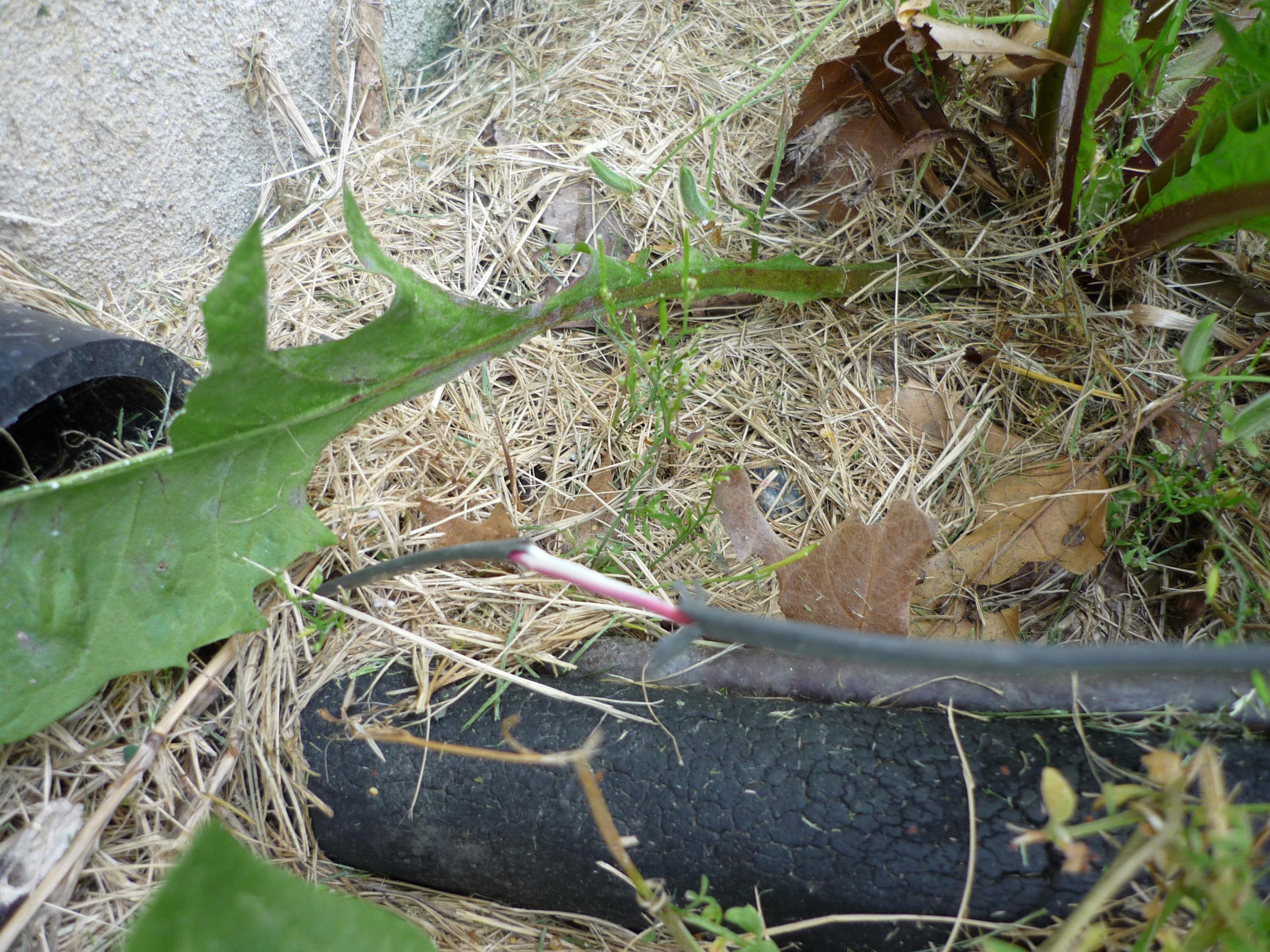

                        Look at this beauty from a "repair" I un-repaired:
                        These were thermostat wires to a condensing unit. This was in a cutesy "retirement community" where older folks have idiot "landscapers" wreck their units. This unit was two inches into the ground (plastic pad settled, ground not prepped beneath unit/pad). Moot, since Hack-n-Slash Landscape got the coil pretty well over the years. At the end of last summer, they broke the stat wires to the unit/contactor. Some jerk told the old lady's son that "repairs will be made and the stat wire sleeved." That was last fall- I told them to have me look anyway, since the hired help doesn't give a shit...
                        Fast forward to a month or two ago. The son is getting the house ready to sell and wants AC to keep cool while painting. Sure enough, unit doesn't run, and it was time for me to look at it.
                        Here's what I found. Horrible, non-pretwisted splices, unsleeved a few inches off the ground. Keep in mind winter had passed by now, and those things got all manner of snow and rain soaked by this time.
                        Wire was damaged in several places- had to cut all the way back to chase where it came out and splice on good wire, and sleeve it. Used some 3/8 OD "NyCoil" tubing.
                        Also found jumped-out rollout switch in furnace inside. Some jackass was inside "cleaning" the unit, and because pride in your work is verboten around here, a terminal got hit and broken off. Rather than replace the ROS (schematic showed all three in series), idiot removed the jumper, connecting #2 and #3 together! You never bypass/remove safety controls on a gas appliance!
                        How many other units were like this? What a crime...
                        Anyway, first pic is splice-as-discovered. Notice broken insulation where "landscaper's friend" stripped outer jacket. See, they used invisible sleeving on the wires...
                        Second pic is coming out of the 2-1/2 chase/pipe under the crawlspace- they got the wires there, too.
                        Third is under the wirenuts. Nice and green, and nasty... No 24V contactor coil for you. Look close- one's sort of pretwisted, the other's not. And the other wire is half-on and half-off the insulation!
                        Repaired, my ass... Good thing they didn't damage the 240V feed to the unit and "repair" that; they'd have burned the place down.
