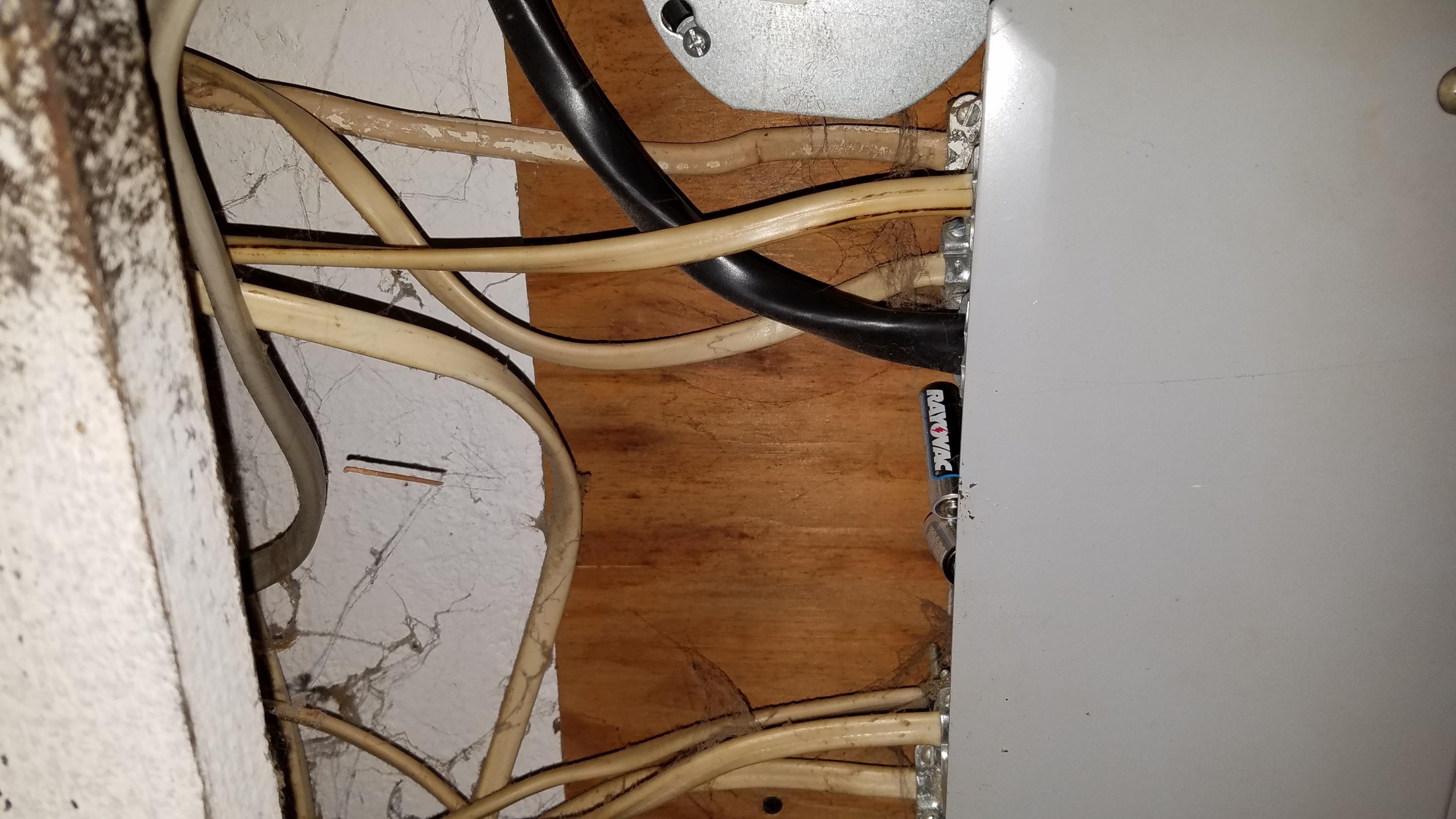

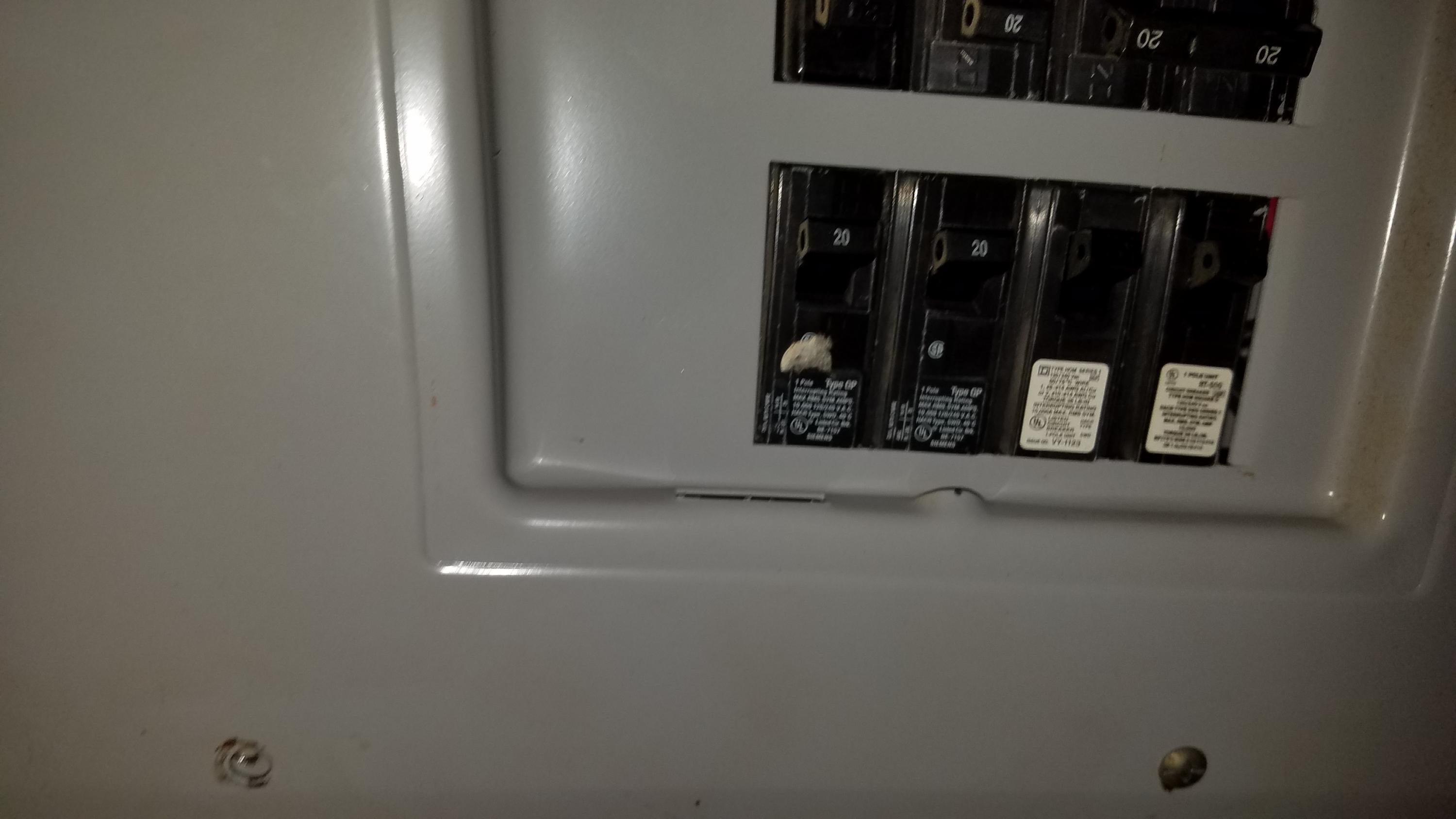

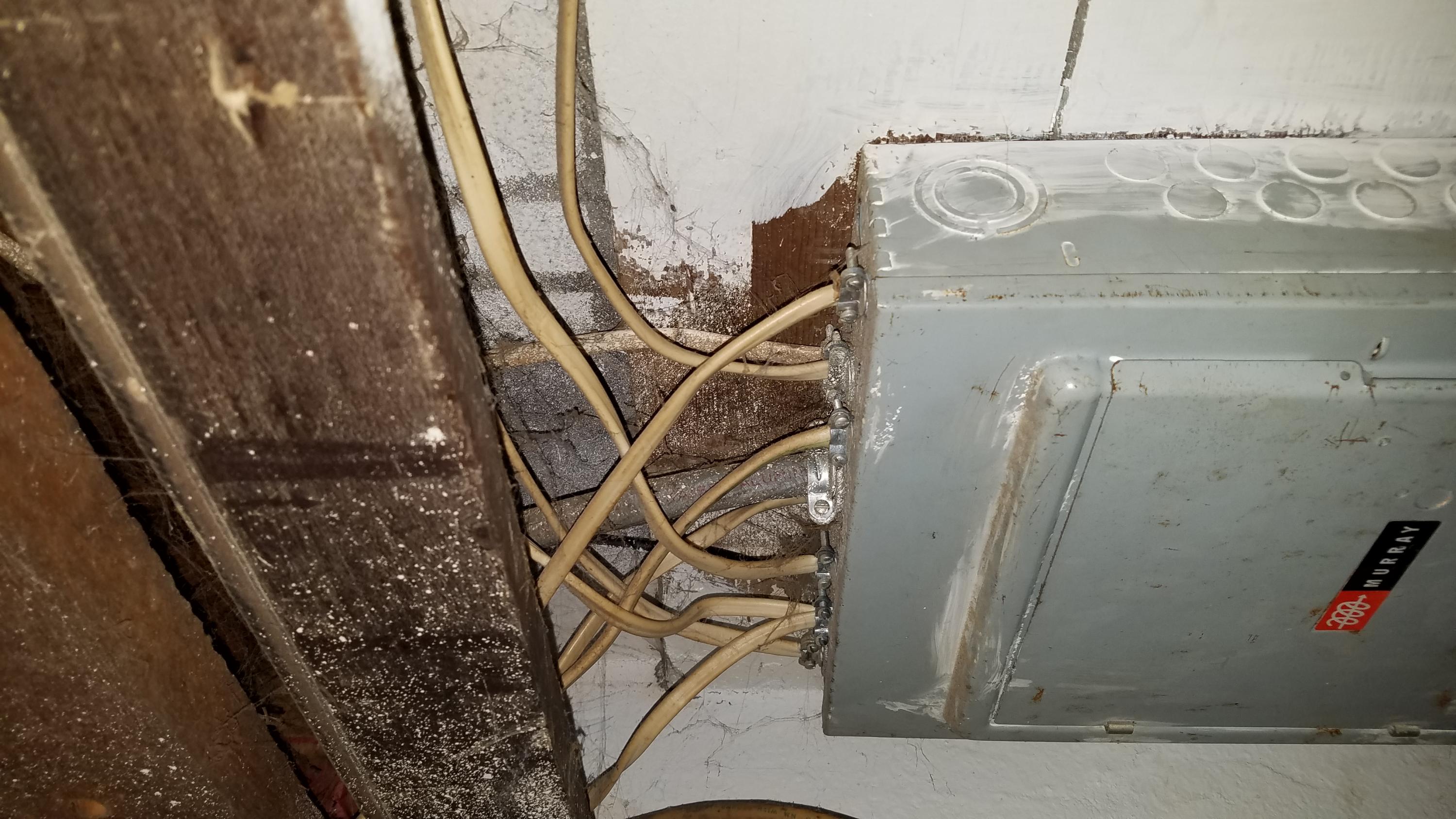

    Sorry for the crappy pictures here. My father, who has dementia was with me and it was a bit hard making sure he wasn't doing something down there that was going to hurt him and taking the pictures. For some reason, he kept grabbing hold of one of the big thick wires that thankfully wasn't hooked up. He'd grab hold of the red wire and say hey, this doesn't seem right. And then as soon as I got him away, I'd try taking a pic, but he'd come back and do it again.
    What do you guys think? Easy upgrade? There's actually two boxes here. I believe it was once a multi-family house and one panel is for the upstairs, one is for the downstairs. I'd like to get a 42-panel breaker box and just combine them all into that and add a few more I think. What do you guys think?

      Man, those pics turned out horrible! The one with the batteries on top is the second box. They're all on their side, try to visualize them side ways or maybe turn your monitor up side down.

        I was wondering if that was the battery backup for the house. You know, for when the power goes out?
        I see about 25 generations of spiders there too.

          LOL! Yeah, we can pretend that's the battery backup for the house! And 25 generations of spiders!!! Yuck! 35 years of my life and one thing I never seemed to overcome, my fear of spiders! Pretty sad when the realtor laughs when I scream like a little girl after seeing one and then run and hide behind my wife!
          Anyway, is it a big project upgrading these things? Or with a little research, would I be able to do it pretty easy like? I've been studying mine here at this house and honestly, it doesn't look to crazy or anything. The person who did it didn't even make it look nice. I bet I could even make it look nice.
