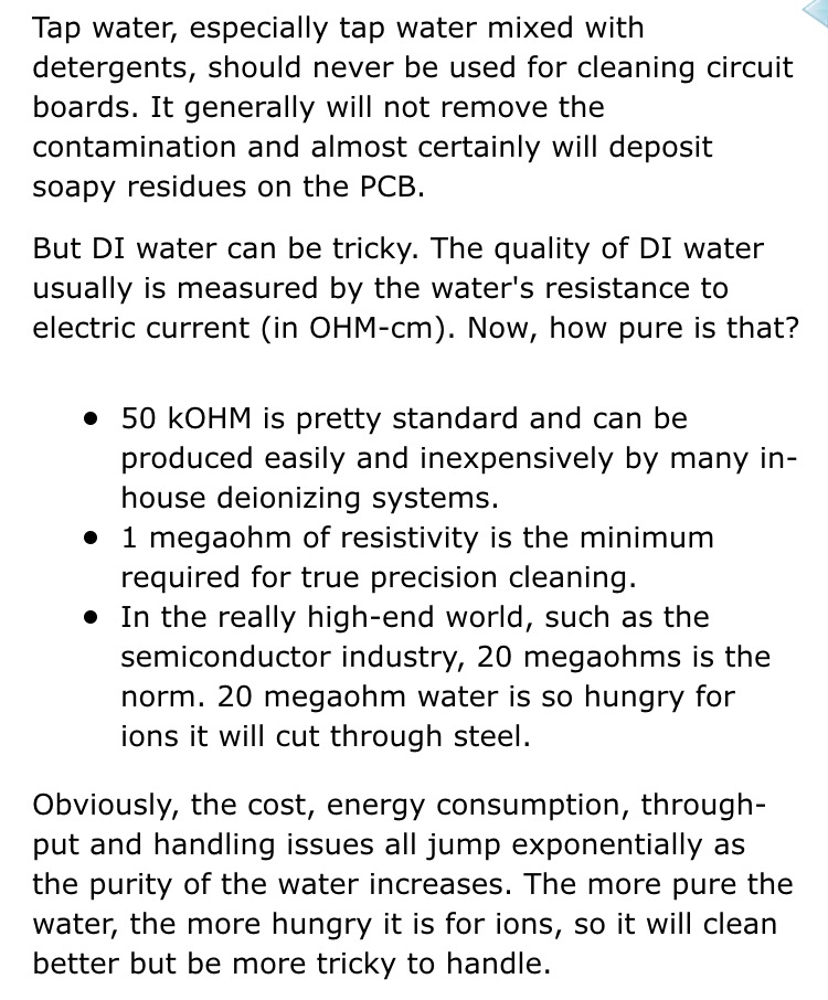

      Re: Confusion about distilled/deionized water for circuit board cleaning
      I came across this on a site which tells about the uses for deionised water
      "Ultrasonic cleaning tanks – deionised water is extremely active cleaner and will pull ions from any surrounding metal, including stainless steel. As deionised water contains no ions of its own, it will always look to draw from its immediate surroundings and even the atmosphere"
        So it makes it sound like the water is "stripping" the metals clean, thus my confusion
                So distilled water is used because it doesn't leave a residue behind? It has nothing to do with it cleaning contaminants because it "strips" them away due to its "hunger" for ions? Here's another excerpt from another site
                  As your excerpt says ultra pure is used in the semi conductor business because it leaves no contamination. If your looking to strip things, it's best to use something specific instead of water. The chemical we used was meant mostly for flux. It dissolved flux very well. Water would not. Yes water can strip steal, it's called rust. Those sites are being disingenuous. We used to use freon to clean tape residue in tape recorders. It removed the brown residue very well. In the days of digital tape you had to keep the heads clean. I never lost a tape because I cleaned the path before each use. I watched more lazy people chew up several tapes from a dirty tape path.
                  I've got a glass bottle here I got in the mid eighties. I use it on cassette deck heads. Works great. Trichlorotriflouroethane. Works great on tape paths, much better than alcohol.
                            No, not really. It's cheaper, leaves no residue, and just gives a physical flush of all solder particles, dust, dirt, and grime. At least I would guess. I'm not an engineer. I don't work for the manufacturer. Just an old soldering iron jockey.
