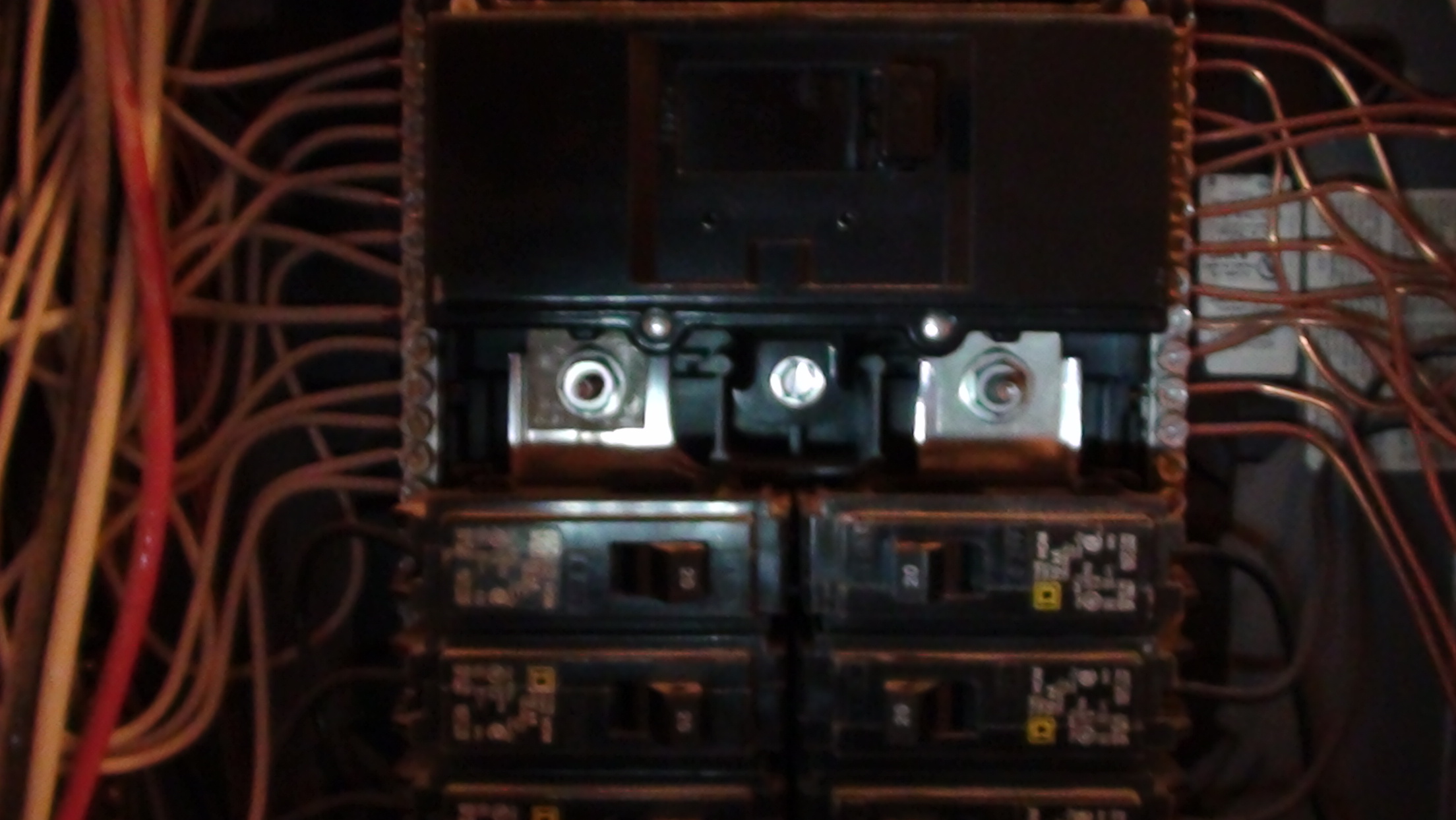

If my two sides of the breaker box are separated, should I try to run all the 240V's like it's ran in that picture you attached? Where one hot is on one side of the breaker panel, the other hot is on the other side or don't it really matter? I'd think it probably wouldn't matter so much because I'm not drawing super crazy amounts of current or anything. So it really shouldn't matter, right?-- Law of Expanding Memory: Applications Will Also Expand Until RAM Is FullComment

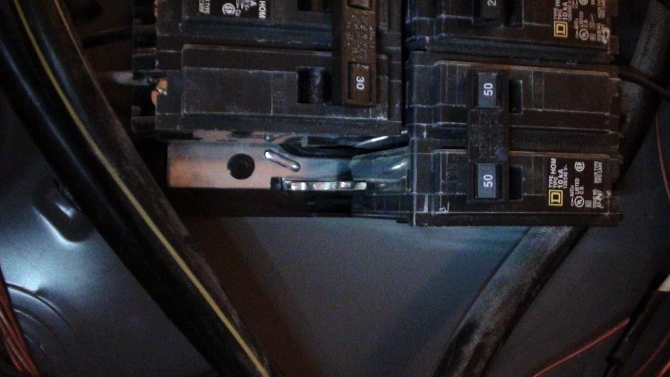

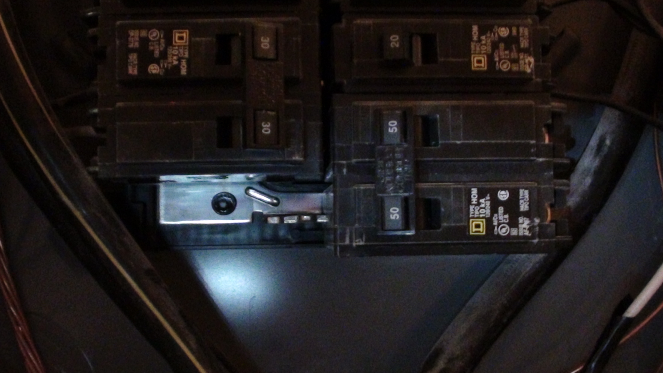

The first picture is a bit blurry but shows where the hot lines from the second picture go. The third picture shows how I think they're connected, at the bottom there. I think the panel is just a big U. Then the last picture there, that's one of the 240V breakers. I should have put black electrical tape on the white HOT closer to the actual circuit breaker. You can see it here a few inches back. I was trying to keep it up to code.-- Law of Expanding Memory: Applications Will Also Expand Until RAM Is FullComment
Re: How much current goes through me when I touch 120VAC?
There are two buss bar one for L1, one for L2 coming down in the middle section that you cannot easily see in the pictures.

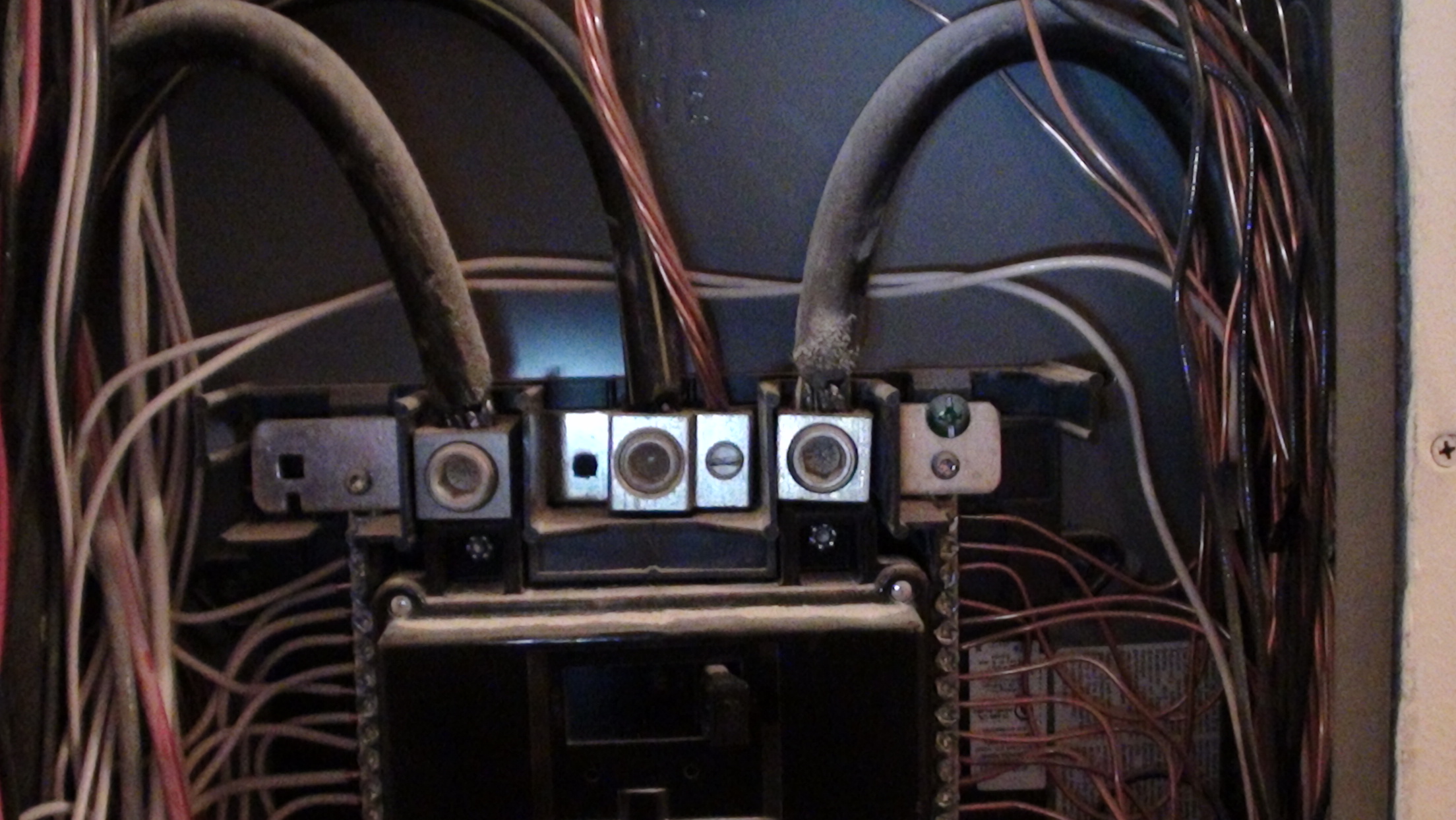

BTW:https://www.badcaps.net/forum/attach...7&d=1463430832, those 3 incoming power wires do not look good, it looks like they are running hot.
Those terminal should be check and tightened once a year by qualify electrician, those are aluminum incoming wires.

So, from that article, it shows 240 is 120V from one bus and a 120V from another bus. But then they talk, further down on the page, about how 120V is just a double pole breaker (which seems to imply it's 120V's from the same bus). The giant bars that the breakers hook into are the buses. I have two hot buses, right? I think I finally understand. I thought because my double pole breaker was 2 breakers on the same side, ecah breaker was connected to the same bus. But from what you're saying, I'm guessing left side bus crossses over to the right side and vice-versa every other breaker, right? So I can hook up double pole breakers and get the 240V that I need...-- Law of Expanding Memory: Applications Will Also Expand Until RAM Is FullComment

u.s. electrical standards are clearly bullshit.
in europe those incoming terminals would have to have 2 clamp-screws to be legal.
we dont trust only one to hold the wire on high current circuits.
can you show us what's on the other end of the large wires.
if they go to a sealed meter then the power company may need to replace them.Last edited by stj; 05-20-2016, 07:24 PM.Comment

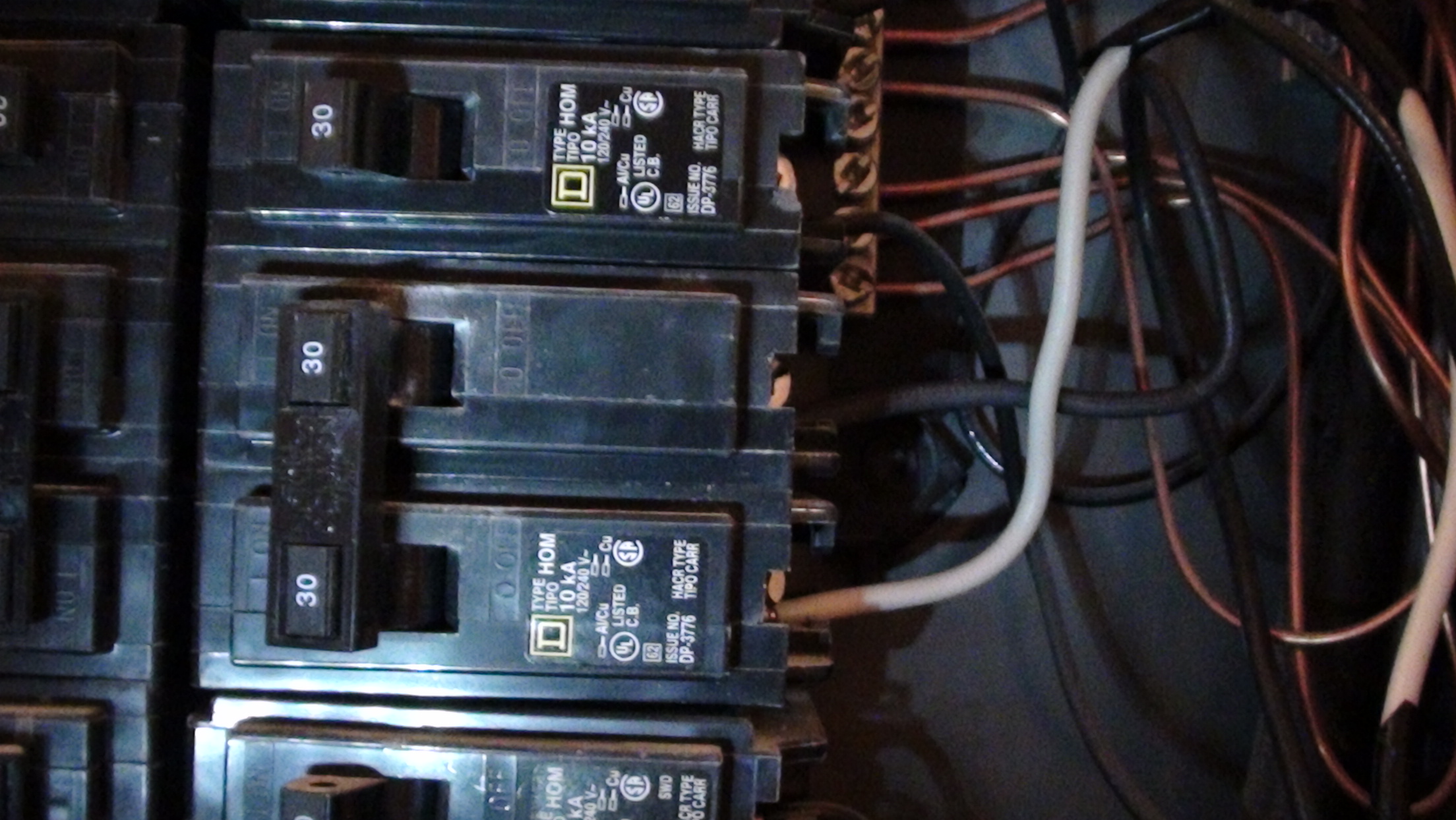

My box is generally sheielded as well, I just removed the sheilding so I could work on it. I'm pretty certain this box isn't up to code. I don't think my dad hired a certified master electrician. I think the guy was an idiot and just saw how his house was wired and wired it how he thought was right.
I'm pretty sure code says the electrical lines in the attic, they need to be so far away from the scuttle, not directly over it. Also, they shouldn't just be dangling in the air like they are. They should either be stabled to the rafters, drilled through the rafters or in conduit. We're in the country, I have no idea how this passed inspection when the house was being built...one girl came, three times during the build phase. That was it.
I'd like to get a qualified electrician in to check everything out and make sure everything's good. I'm sure that'll cost some money. There where wires (ground / neutral) that weren't even hooked up in the box. There were wires in the outlets that weren't hooked up. I guess they could have come out.
Also, the wires that go into the outlet, they got some bare metal showing. If I were to do it, I would have stripped them jus right, so no bare metal was showing. I don't think that has much to do with code there, but still, I think a real professional would have done a much better job and probably charged much more than 10$ an hour....-- Law of Expanding Memory: Applications Will Also Expand Until RAM Is FullComment
