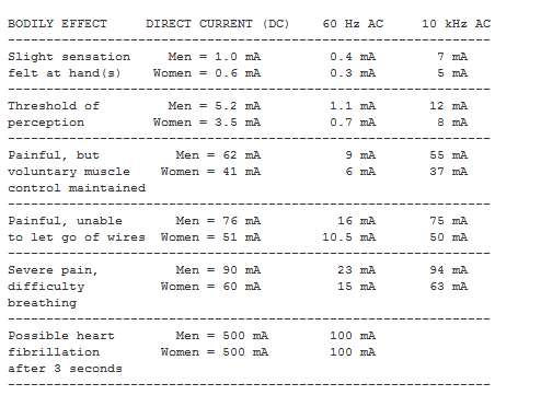

                    • caphair
                      • Nov 2011
                      • 1249
                      Re: How much current goes through me when I touch 120VAC?
                      I believe AC can be more dangerous because your body acts like a capacitor thus it can still flow through you even if you're not grounded.
                      With DC you need to be grounded for the electricity to complete the path through your body (if it's strong enough)
                      Have a look at this chart

                                • Spork Schivago
                                  • Mar 2012
                                  • 4734
                                  • United States of America
                                  There was a guy down in Florida (when we went on a mini-vacation / party spree) that bet me 5$ he could stick a screwdriver in the outlet, touch the metal part and not get shocked. I took the bet because I had done this and got shocked when I was a kid! Sure enough, he stuck it in each hole and didn't get shocked. He said it was because he wasn't grounded. Something about his shoes were acting as an insulator. So, is this true? From my understanding of electricity, it makes sense, but from what you're saying here, it's a bit of the opposite? Even if you're not grounded, AC can still flow through you?
                                  Just curious as to why the guy didn't get shocked.
                                  -- Law of Expanding Memory: Applications Will Also Expand Until RAM Is Full
