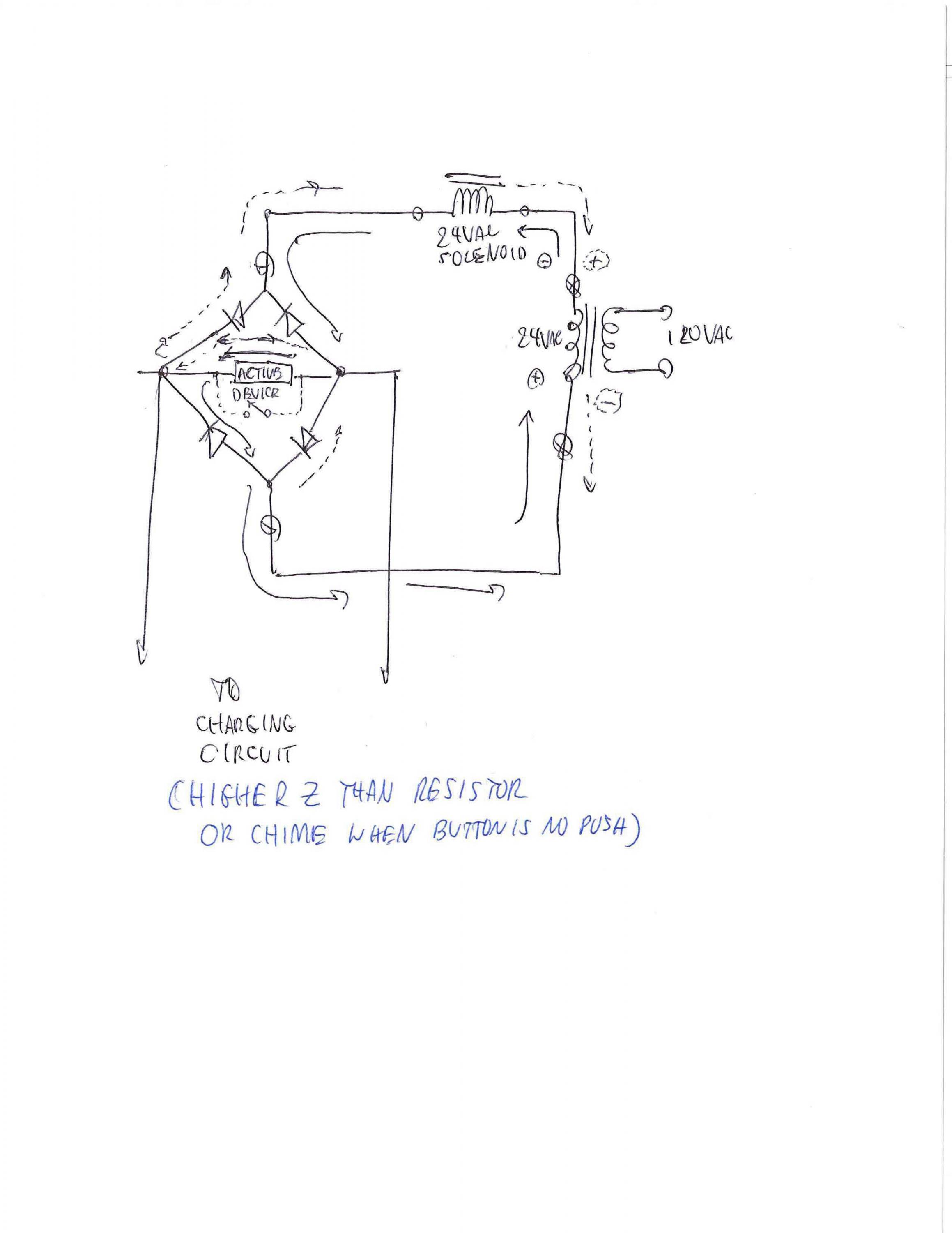

            I have a ring.com doorbell and it seems like to hardwire the doorbell so I don't have to take it off the wall to charge it weekly, I need a transformer and a resistor as seen here:
            https://support.ring.com/hc/en-us/ar...a-doorbell-kit
            So basically I need a 25 to 33 Ohm/20 to 50 Watt wirewound resistor, does anyone have any recommendations on what brands/parts are suitable for this and also for the doorbell wire, can I just use 18 or 20 guage speaker wire? Also, is there a reason to use a wirewound resistor instead of a film resistor? Since this will be outside, what can I use to cover up the wires?
            Thanks!

              BTW, the Ring.com provided the link to Digikey as to what type of the resistors to use so they already tried and used them in their lab otherwise they would not have come up with those two recommended resistors.
              So I do not see why you are trying to use something else that they did not recommend.

                              Well, what do you think the VAC on the resistor or the chime solenoid will be when the button is pushed to activate the Chime (or if the resistor is used) for let say using 24VAC Transformer?
                              24 Ohms resistor with 24VAC applied = 1A = 24 Watts. Using 24 Ohms resistor will limit the current to 1A if the unit is shorted out.
                              If the charging circuit tries to draw more current then more Vdrops will be on the resistor thus Trickle charge is used to not draw lots of power.
                              How do I know about this typical setup? The company I work for also makes similar products.

                                  I guess I was not clear about the door bell. To me the door bell is the switch one pushes to make the door chime sound.
                                  So you see two wire on the transformer red and white. So where is the transformer at and what voltage do you measure on those wires? Next, you see two wires at the door bell. Is there any voltage across those wires? If not then twist them together, go back to the door chime and see if you measure voltage across those two wires and what is that voltage? It should be the voltage of the transformer. If it is not then something is not connected correctly. Caution, make sure the wires where the door chime is suppose to be are not touching before you measure or twist the wires at the door bell together. If you do not measure any voltage on the transformer There are two possibilities 1 The transformer is burnt out, in this case one can ohm out the wires. 2 You have one lead on the 120 AC line and the other lead on the the 16 volt line, in this case take one lead and move it to the other transformer contacts until you either measure primary 120VAC or the secondary 16VAC.
