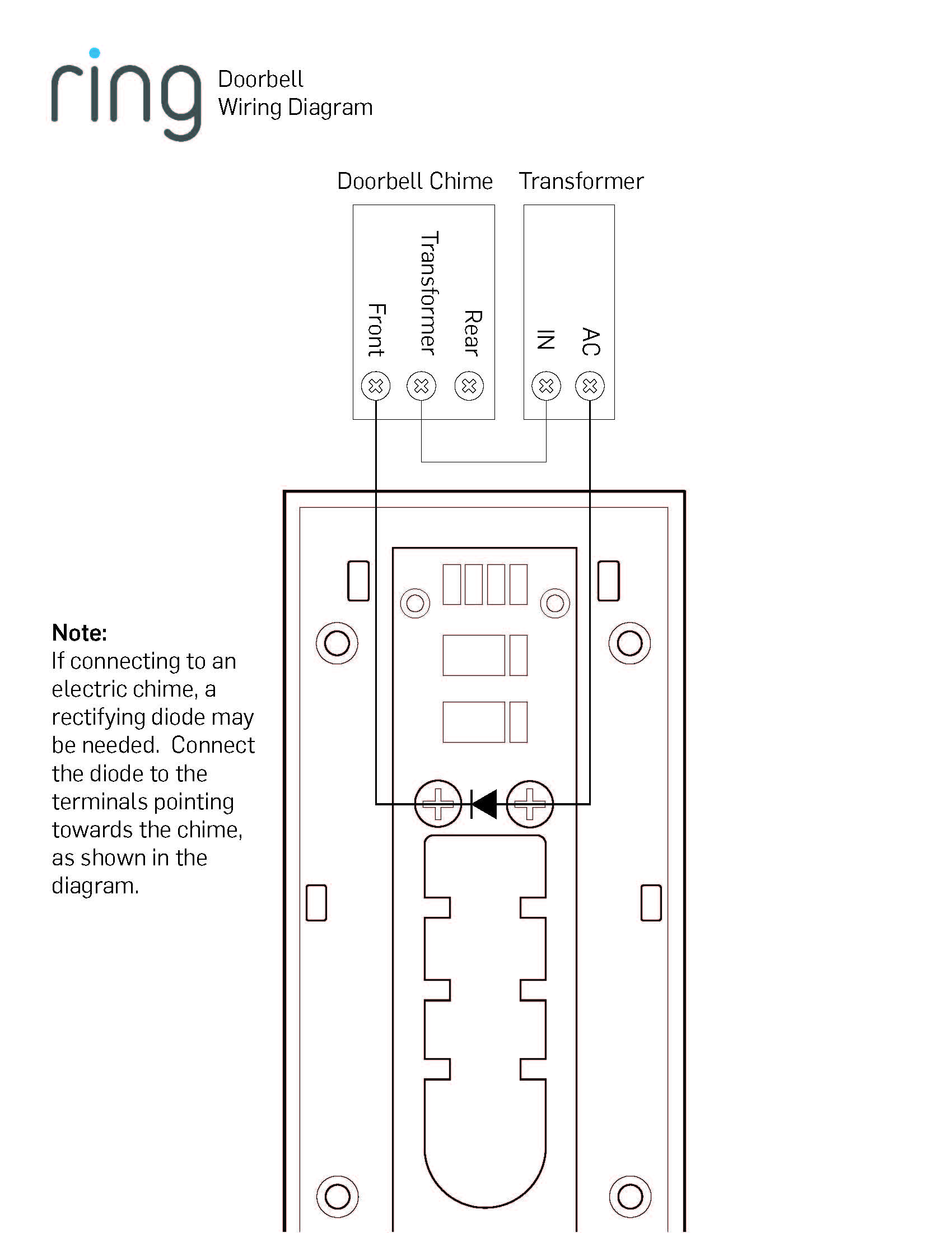

    Greetings everyone:
    I have a ring.com doorbell and it seems like to hardwire the doorbell so I don't have to take it off the wall to charge it weekly, I need a transformer and a resistor as seen here:
    https://support.ring.com/hc/en-us/ar...a-doorbell-kit
    So basically I need a 25 to 33 Ohm/20 to 50 Watt wirewound resistor, does anyone have any recommendations on what brands/parts are suitable for this and also for the doorbell wire, can I just use 18 or 20 guage speaker wire? Also, is there a reason to use a wirewound resistor instead of a film resistor? Since this will be outside, what can I use to cover up the wires?
    Thanks!

      20~50W Resistor? How much power does this unit require? You should worry about dissipating the 20~50W of power in tight space.
      So you are not going to use a new door chime? https://www.badcaps.net/forum/showthread.php?t=52762

        Looking at the docs a bit, the resistor isn't there for dropping, it's there in lieu of the doorbell chime... must be some other indication that the system was activated.
        I suppose if you have a 24V relay you could use that instead of the chime/resistor too. However I suspect the circuitry is assuming an inductive load and hence the wirewound. Without knowing what the actual circuitry is in the device, who knows...

          It is power through the door chime, so for them to use 25 ~ Ohms 20 ~50W resistor it must have quite AC drops on the resistor to dissipate that much power, you can calculate V drops on that resistor.
          So just assume safety margin so they double up on the Wattage of the resistor, so it will be 10W or 25W of power dissipation on the resistor.

                They are using the resistor when you are not going to use the chime, if you have the chime then you do not need the resistor, if the chime come with the step down transformer then you do not need to use the new transformer if the old one is good and has the correct AC Voltage to match the new chime and wire it up as shown for single switch location.

                    now stop right there,
                    a increasing voltage wont charge a battery faster, it will heat it up till it bursts or burns.
                    the speed a battery charges is controlled by the current, not the voltage.

                            So 40VA = 40 watts. or P= V*A therefore P/V=A Where P is power in Volt * Amps better known as Watts. 40Watts/24Volts= 1.67 Amps now we use the formula V=I*R where I is current and R is resistance We rearrange this formula to V/R=I that is 24volts/25ohms= 0.96 amps. Now we use another equation that may be derived from P=V*I with substitution to get P=I^2*R
                            Of course you will notice that A and I are the same "current". So the equation becomes P=0.96^2*25, this then gives you 23.04Watts or VA.
                            You should check the voltage on the wires to the transformer before you disconnect the wires to make sure the voltage side you are disconnecting is the 24 volt side and "not" the 120 Volts side. Make sure you take one side off at the time making sure not to short wires across transformer. Or you can have someone stay with a meter measuring the voltage on the transformer and another person can start flipping breakers until to find the one that cuts the power off to the transformer. Then do the below step.
                            To check your door bell wires. First detach wires on transformer. Undue the door bell and connect both wires go back to transformer using an OHM Meter measure the resistance between the two detached wires that go to the door bell. Your resistance will be low around 25 ohms which is the chime coil. This is a continuity check. Also, before you measure the Ohms switch to Voltage scale and make sure you have no DC volts or AC volts between the wires you are going to measure in OHMs.

                                  Yes 40VA is 40 watts. 40 VA is 40 volts times amp. Volts times amps is watts. I think in another thread or even this thread I post where you can by a 16 volt 10VA at Home Depot for $8. I would not use a transformer that is the wrong rating for the door chime as it may not work at all. I would still check the wires with a meter as some people may of connected them wrong. Any good electrician would do this check. You always check voltages or current on the largest scale and then go to a smaller scale if you can not get a reading. I went to your link but there was no pictures.
                                  If you have no door bell or wires on the outside of the home then you will need to run wires to the outside of the home. You will need what they call a fish. This is a reel of solid very stiff wire with a loop at the end of it. It is contain in a plastic container than can be reeled out or up depending on what you need. You will fish this wire up from your basement or down from your attic. In the basement you may have to drill a hole in a stud to get to the interior wall. You will also have to drill another hole in the outside wall where you want the door bell. That is where the wires will come through. You fish this stiff wire to this hole. This will require two people. One looking for the wire and one doing the fishing. When you get the fish to the outside wall you then strip the end of the two wires your are going to use for the door chime. Then you twist the wire end and loop them them through stiff wire loop and twist them back on to themselves and lastly you tape them very tight and smooth so they do not slip off. The next thing is to pull the wire. you will then bring them to the chime and then to the transformer. Or you could get a wireless door bell. You will have a door bell on the outside of the door. This has a AA or AAA battery which can be replaced easy. It also last a long time. The chime you plug in to a wall outlet somewhere near the door on the inside of you house.
