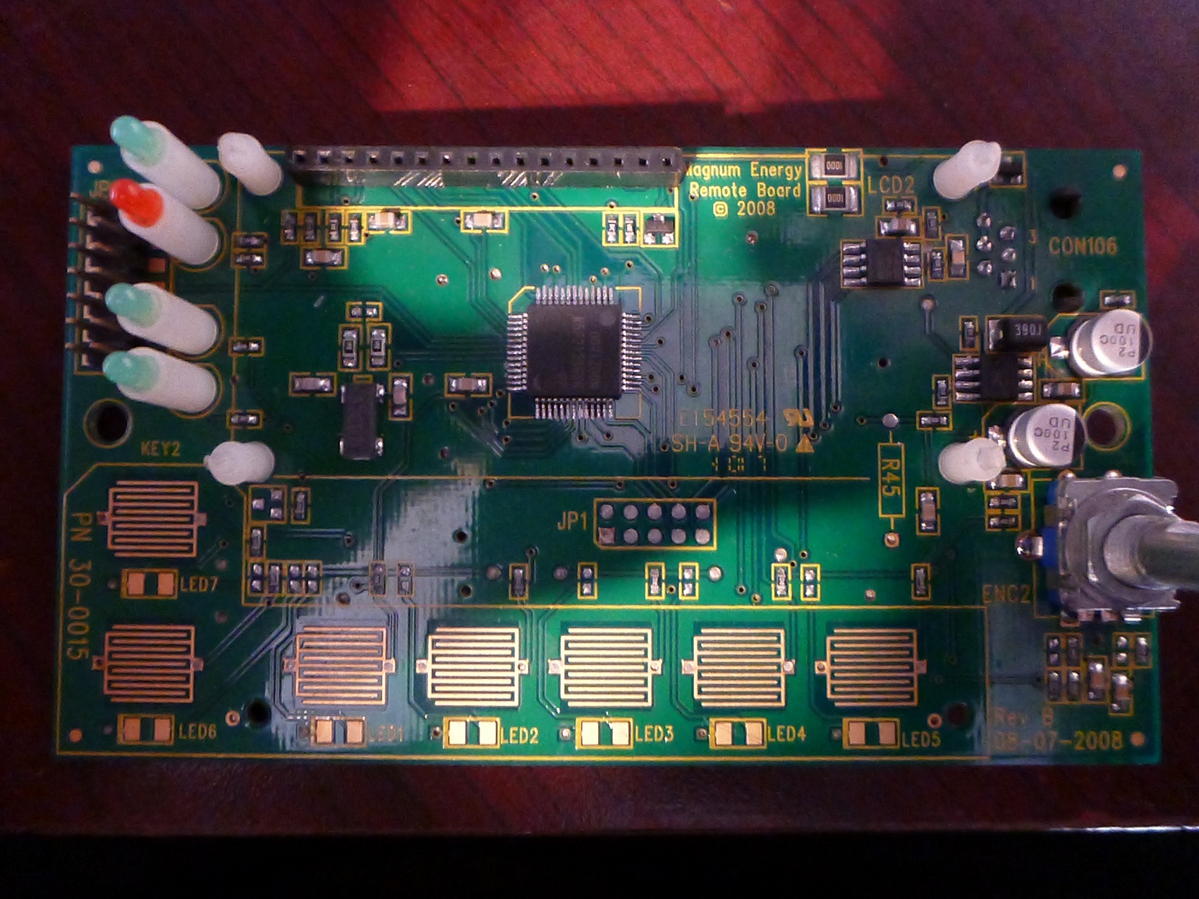

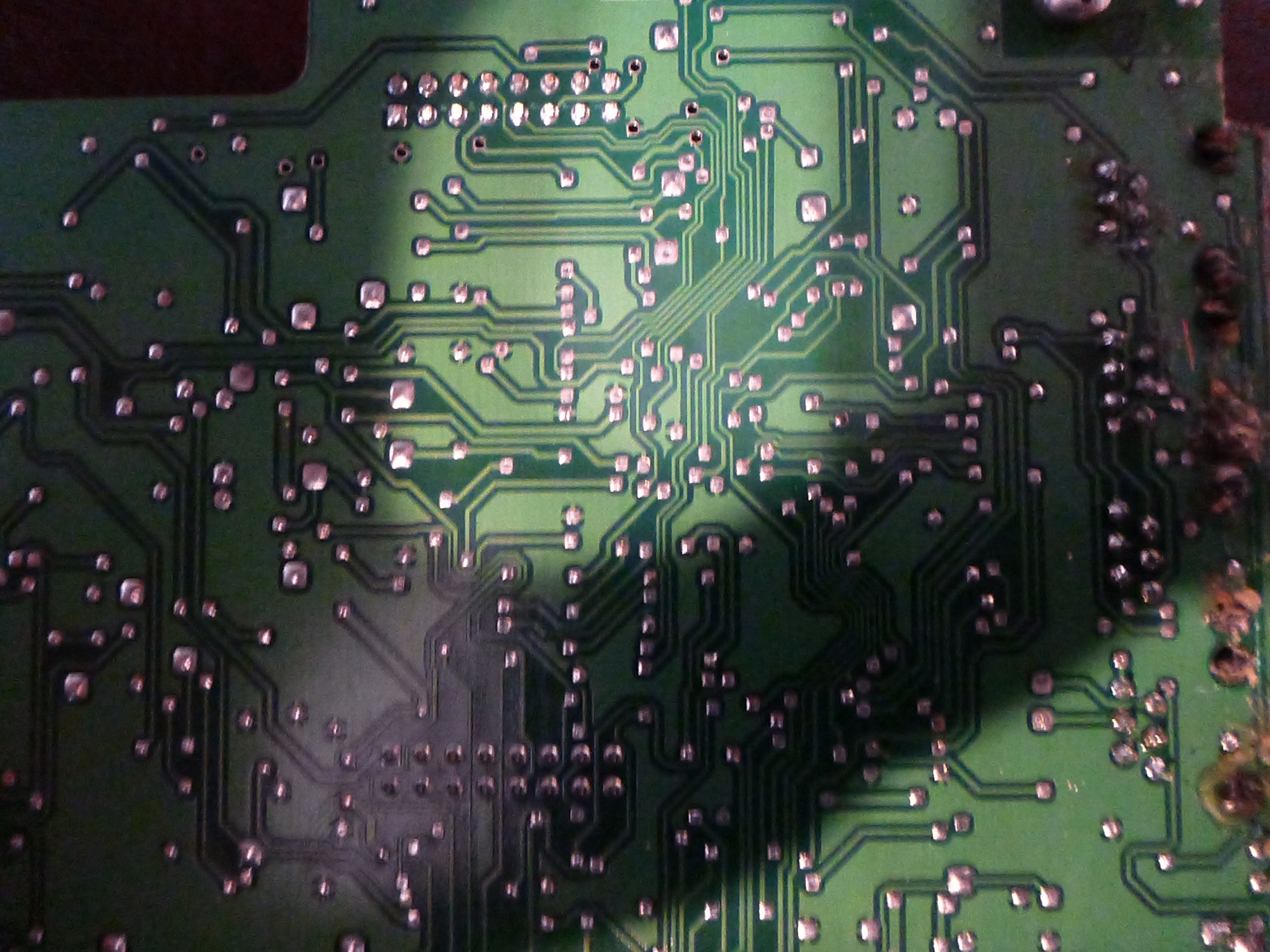

    I have a Magnum ME2012 Power inverter and out of the main logic board I have phone cable with a RJ45 female jack. in the cab of the vehicle I have a display panel with another female RJ45 jack. the phone cable connects these 2 guys together and I can set things like max amp draw, low voltage cut out etc.
    On the remote controller I have only 2vdc on the VCC legs of the op-amps and micro controller. I cant seem to find anyone who knows anything about power inverters or is willing to help fix this. I picture in the phone line that there is a twisted pair for communications and a VCC positive and a ground? it makes sense from an automotive design standpoint. I am also being told that telephony does not have a "heavy lifting VCC DC in the cable and that the analog voltage rides along the twisted pair com wires" im not sure if this is true or how that would even work.
    I can post photos if someone is willing to help me.

      Upload good clear pictures so we can see what we are dealing with.

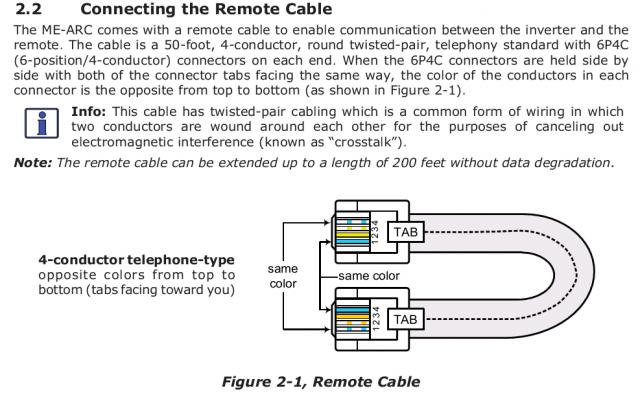

        The manual states that the communication interface is RS485.
        This circuit might provide some insight into what you can expect:
        http://pinouts.ru/Converters/rs485_cable_pinout.shtml

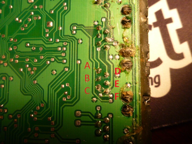

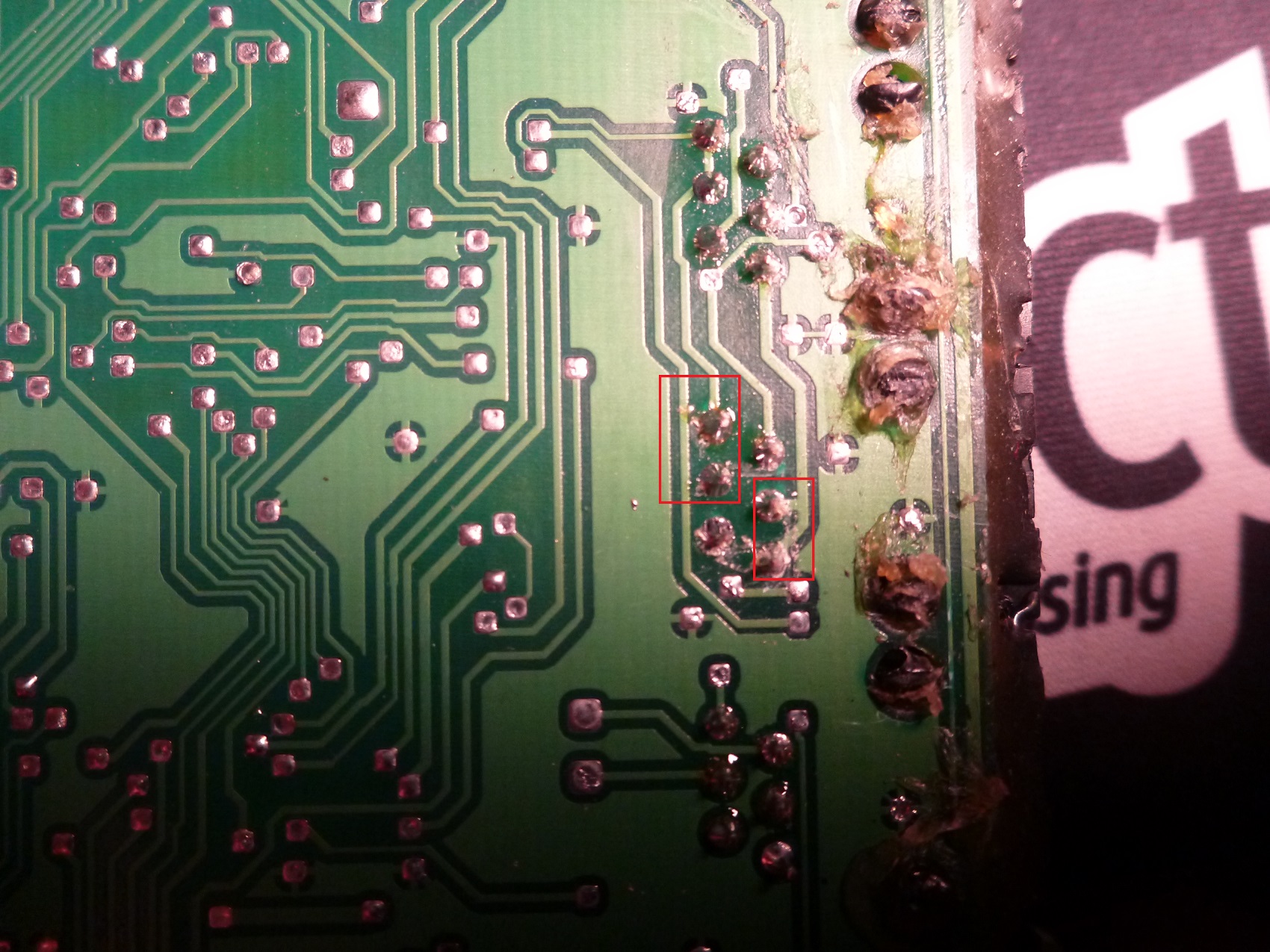

                Dammit!! No I am not!!! I had a problem with the original cable that came installed with this thing. It stopped working so I bought a new phone cable to replace it. It worked and lasted a few months. After 3 phone cables and all worked, I realized the female jack was corroded. I thought the corrosion was my problem. I pulled the unit from the vehicle and replaced the female jacks, now I am in this predicament where the new or old phone cords don't work.
                • SteveNielsen
                  Retired Tech
                  • Jun 2012
                  • 2327
                  Re: What is telephony? where does the VCC come from?
                  Recheck your work. Perhaps you've got a solder bridge short or a bad solder joint.
                    ' I thought the corrosion was my problem. I pulled the unit from the vehicle and replaced the female jacks,' So you replaced the FEMALE phone jack on the main unit or on the remote unit? Did you do the resistance test on all four pins between the main unit and the Remote unit? Correct phone wire per post 7?

                      The OP mentions an RJ45 jack, but that's 8-pin. The ME-ARC uses a 6P4C RJ11/RJ14 connector. Moreover, I didn't realise that phone cables had reverse pinouts at each end, so I had to check my own. Sorry about the mistake.

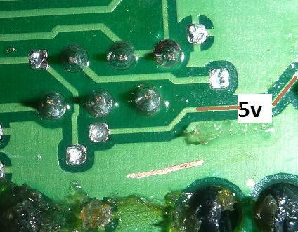

                        I seem to have 2 sets shorted, it appears to be by design, I can follow the traces. the other pins are free and clear of each other.
                        these female jacks have 6 pins
                        I have only replaced the 4 female jacks on the main unit and I have not replaced the female plug on the remote.

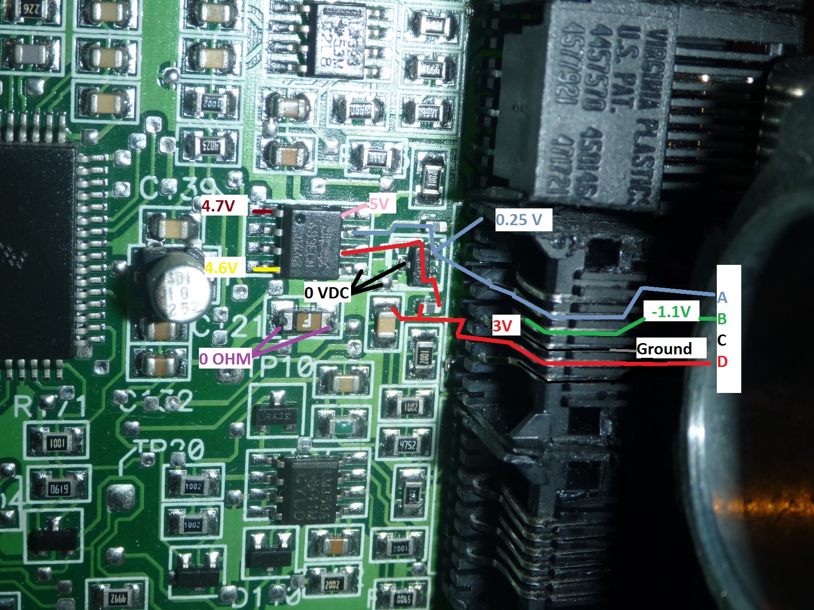

                          I would identify the RS485 transceiver ICs at each end. One or more of those 8-pin ICs should be likely suspects. Then examine the IC's datasheet. This will tell you its power and data pins. Then trace these pins to the respective jack(s).

                            I would find out which pin of the female phone jack is the VCC pin, GND pin the check out the resistance between the VCC supply pin of the main unit to see if you do have conection all the way to the remote unit VCC pin of the female phone jack, do the same for 3 other pins.
                            You should verify that one pin of the Remote female jack on the main unit has VCC (5V? 12V?), and one or more pins are GND. It only uses 4 wires.
                            Then you should at least find out if you do have good connection between the two unit first.
                            It is double sided board when you removed all those pins, the feed through between the top layer and the bottom layer may be damaged.

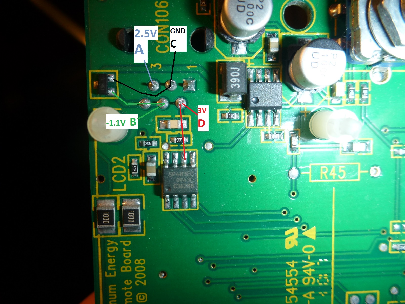

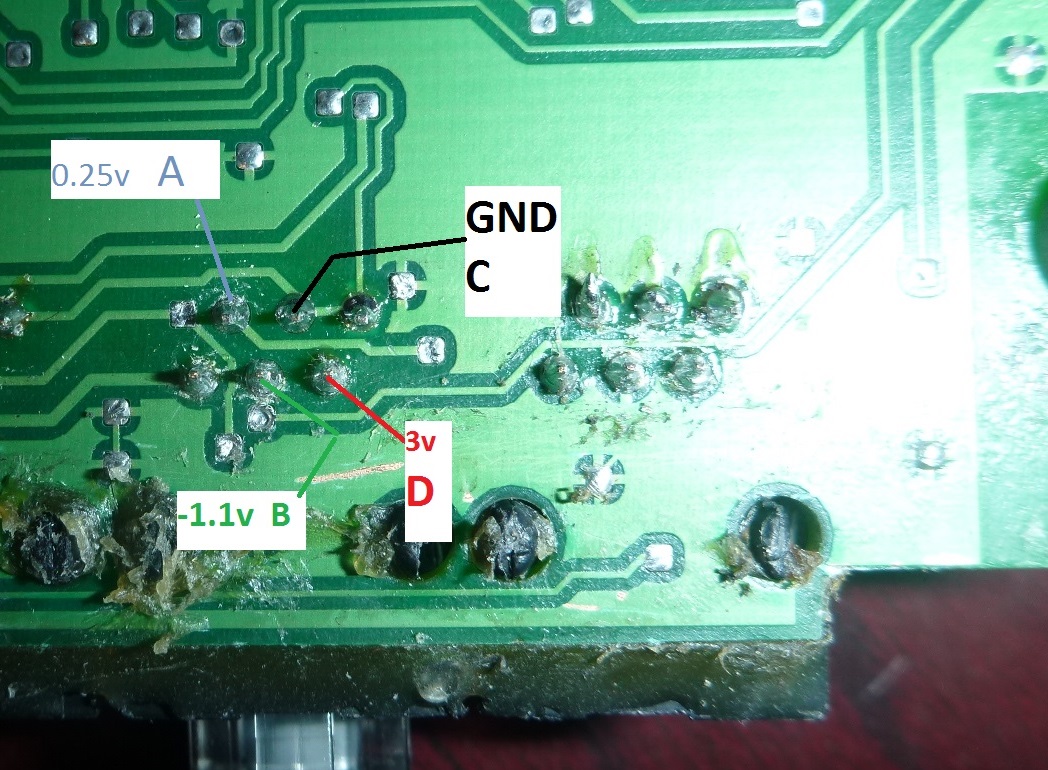

                                  C .25 vdc
                                  D 3 vdc
                                  A,B, Ground
                                  E.F, 0 vdc
                                  The connections are good between the remote and the logic board. I have 0 ohms straight across each lead
                                  terminals E and F don't seem to do anything and terminal D doesn't seem to be strong enough to light up the remote. I think this is possibly the problem??

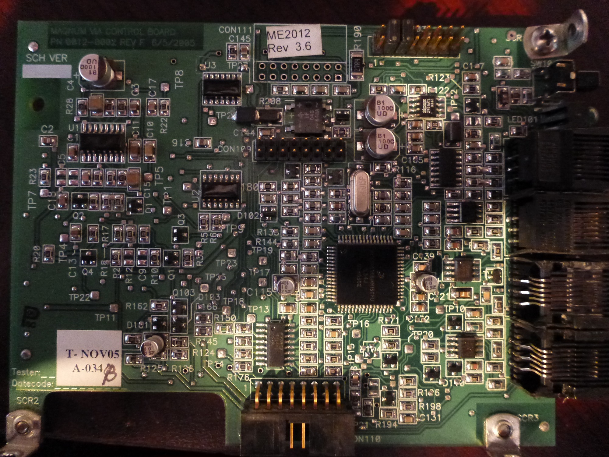

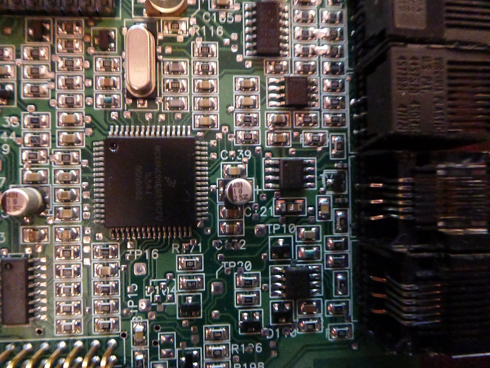

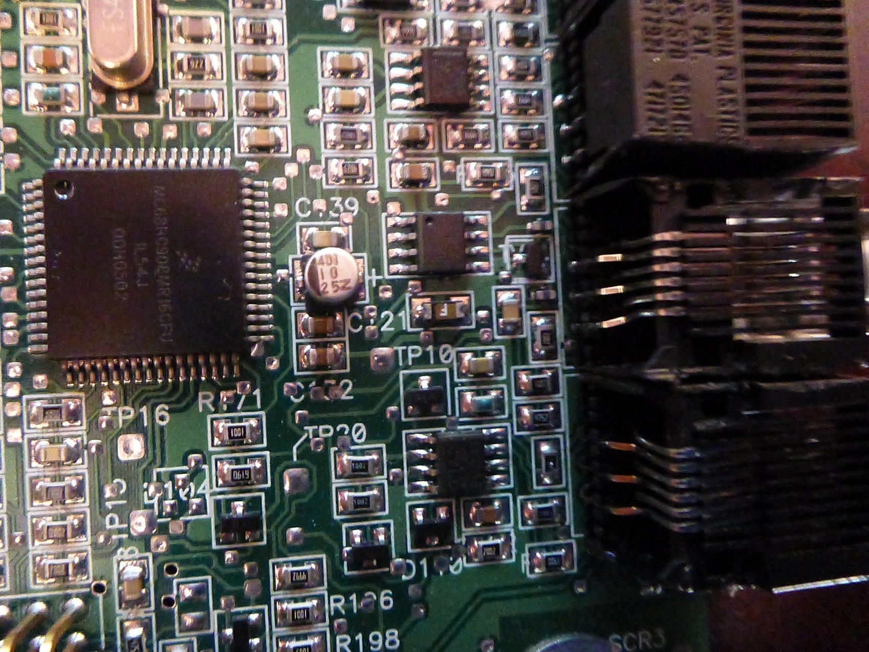

                                    Here are some more measurements and some more photos.
                                    there is no loss between the output of the logic board and the input of the remote.
                                    I have negative voltage at one pin, I do not know what this means.
                                    the IC in the photo of the logic board has 483ECN and 0448 on it and also possibly SIPEX ?
                                    the IC above it are LM393 and the one below it are LM358A.
                                    on the photo labeled "back of logic" there is an image of terminal B -1.1v and its very close to solder dot, I don't know if these are supposed to be connected or not. I have enclosed a closer photo, the "dot" has 5v.
                                    please don't forget, this stopped working, Then I pulled it and replaced the female connectors and now its still not working (or at least the same as it was before)
                                      So I am confused as one place you list A,B as ground and another place you are listing C as ground. This is a very simple circuit. Do you measure 5Volts DC when you measure from pin 5 to pin 8 on the 483ECN on the remote board? If you look at your picture of the remote the microchip seems like lines are shorted in the middle of the pin on the bottom part of the chip. I can not make out where pin 1 is or the number of the chip.

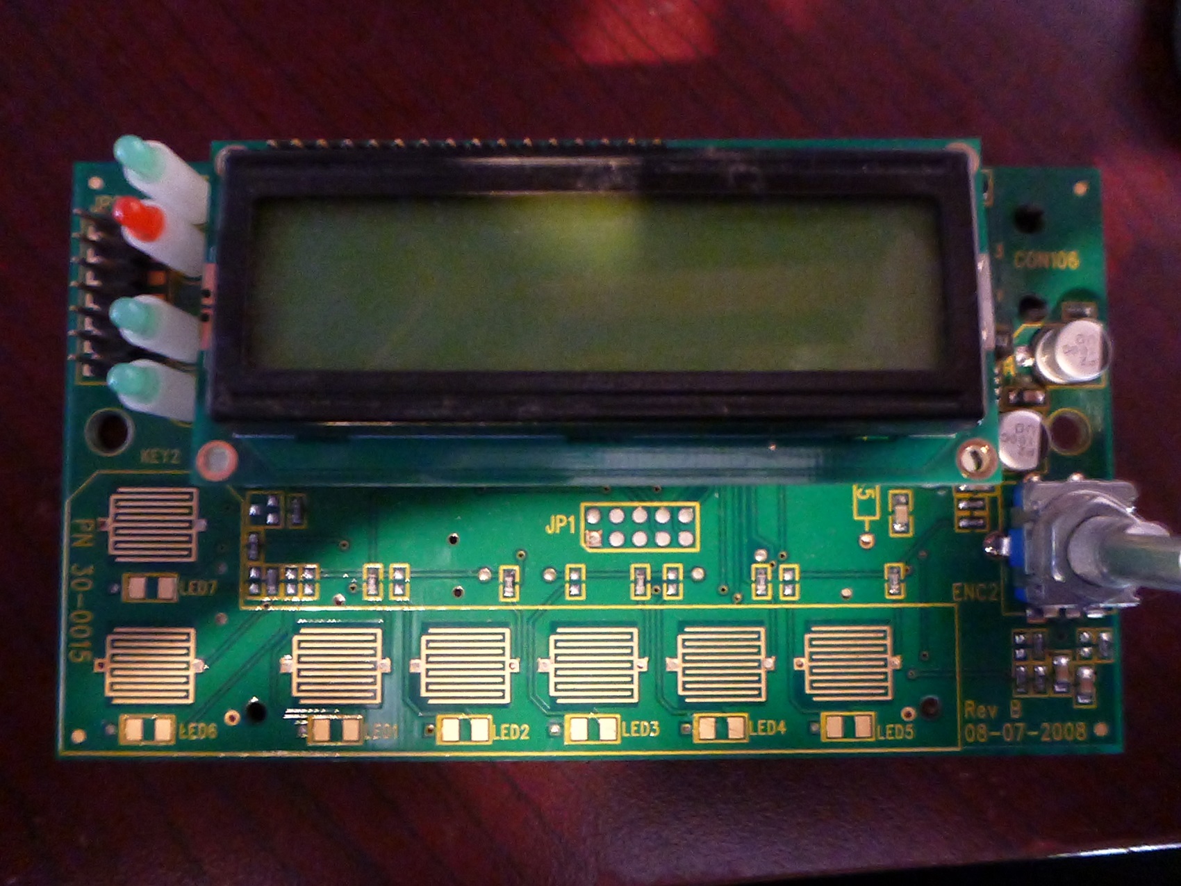

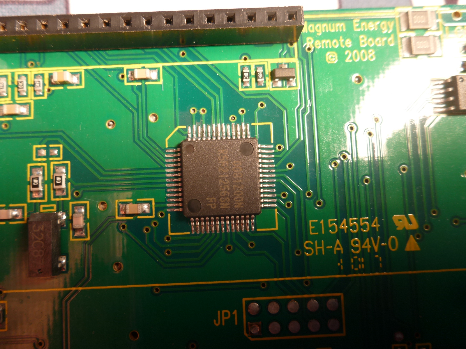

                                        Please ignore post #17, the logic board slides into the inverter like a video card on a PC. I was trying to probe around a corner and I was measuring the wrong port. I have since pulled all of the tin heat shields apart. The previous post (#18) is actual measurements. Moving forward I will do my best to keep the letters and colors the same.
                                        The IC on the remote pin has only 2V at pin 8 with my ground lead on pin5
                                        I have enclosed photos of the micro controller on the remote board. before I started this thread, I found the VCC pins on the controller and they are all at 2v
