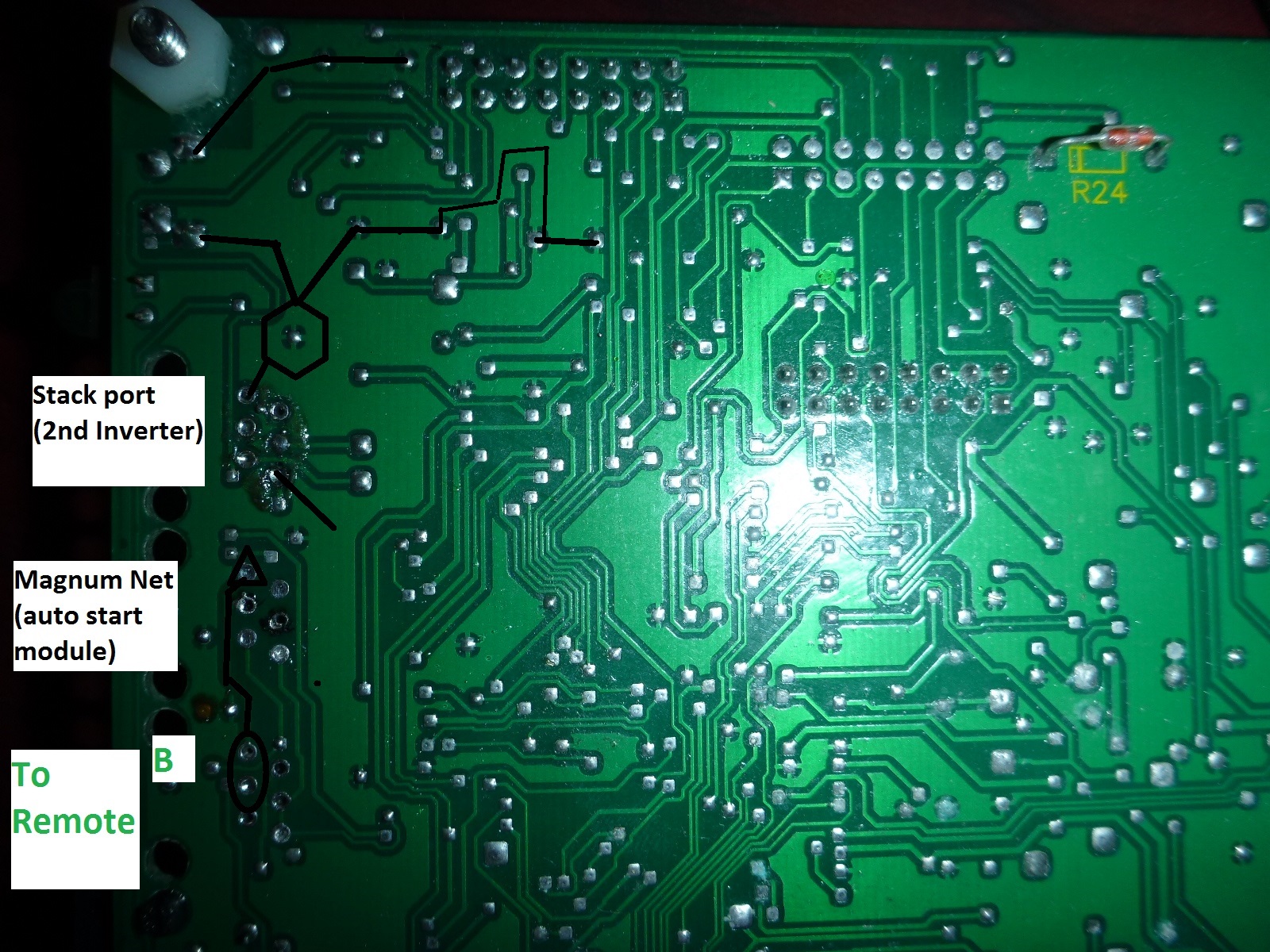

                        #51
                        Re: What is telephony? where does the VCC come from?

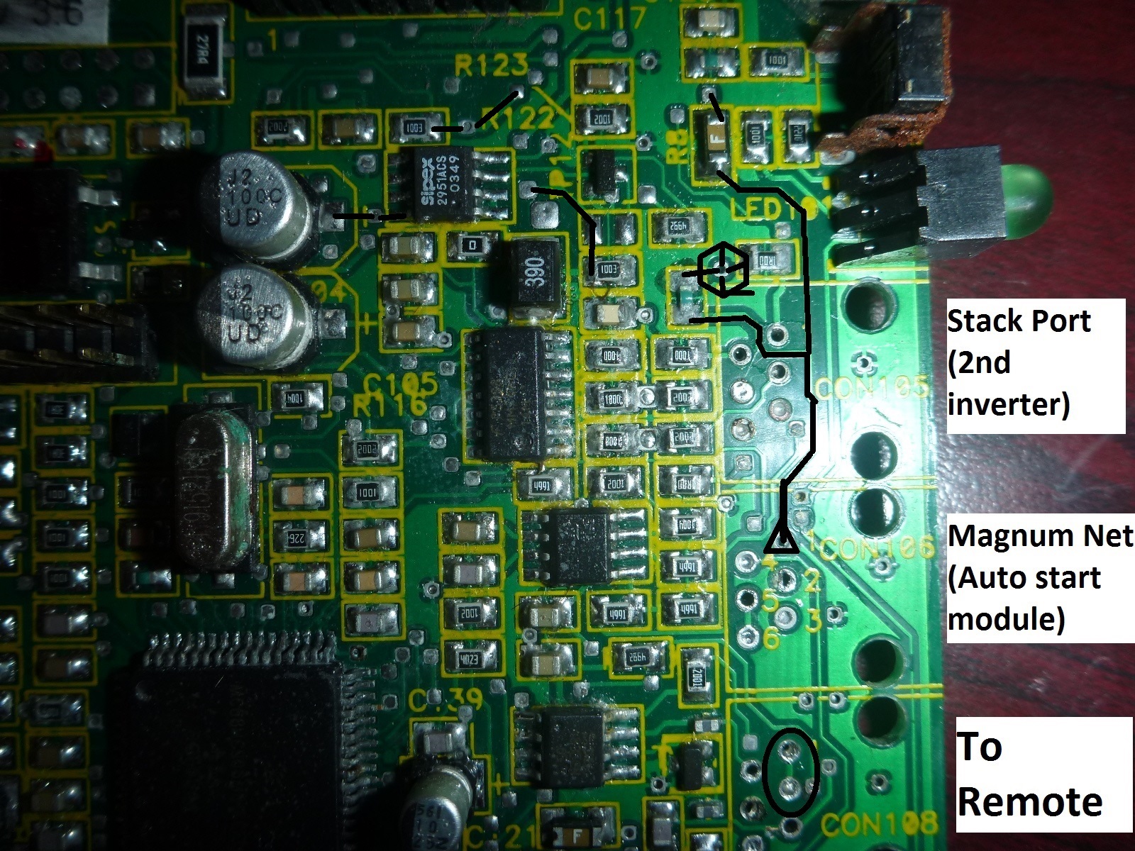

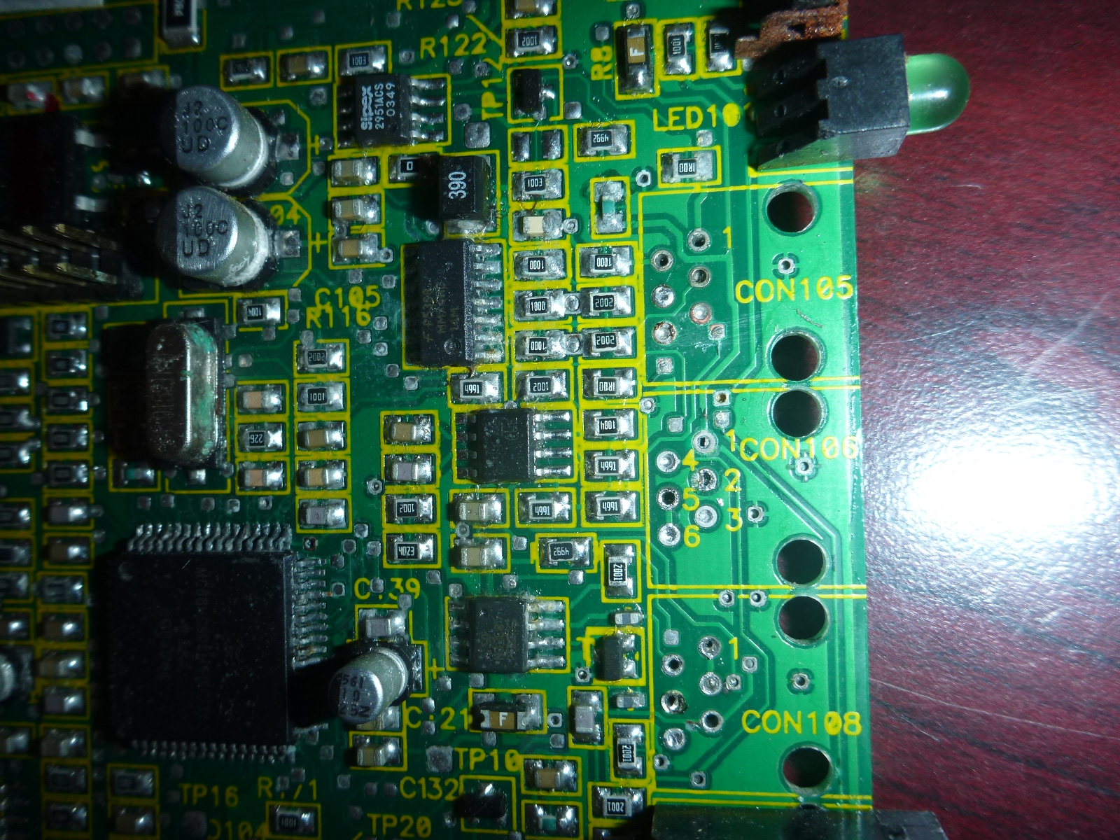

                        I have found a second non functioning logic board, I have something I can poke and remove parts from to see traces better. please don't comment that the caps are corroded or the solder traces are bad. I am dissecting this one with the intention of throwing it away when I am done with it.
                        I have removed all of the RJ11 jacks on this donor board to better see the traces. this "B" port seems to go to the neighboring RJ11 port for the auto start module which I do not have hooked up. then it goes to a capacitor then to me it looks like ground, it takes off and goes all over the place on both sides of the board.
                        I am now getting 0vdc at the "B" terminal that I am chasing around. And I am getting 4.5VDC on terminal "D" with or without the remote board attached

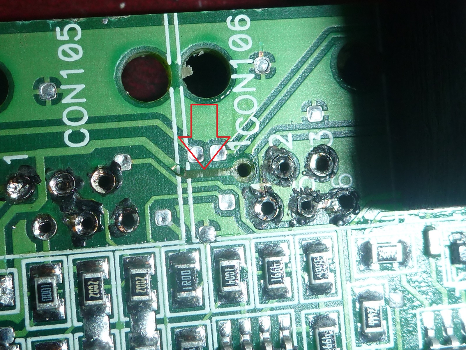

                            GOOD NEWS!!
                            I found a damaged trace under one of the RJ11 jacks. (photo enclosed) this connected "B" terminal to the fuse. the huge trace I was chasing around turned out to be B+. It is de coupled by a cap and protected by a fuse (look on the previous post photos) I repaired the trace and now I have MUCH better voltages to work with.

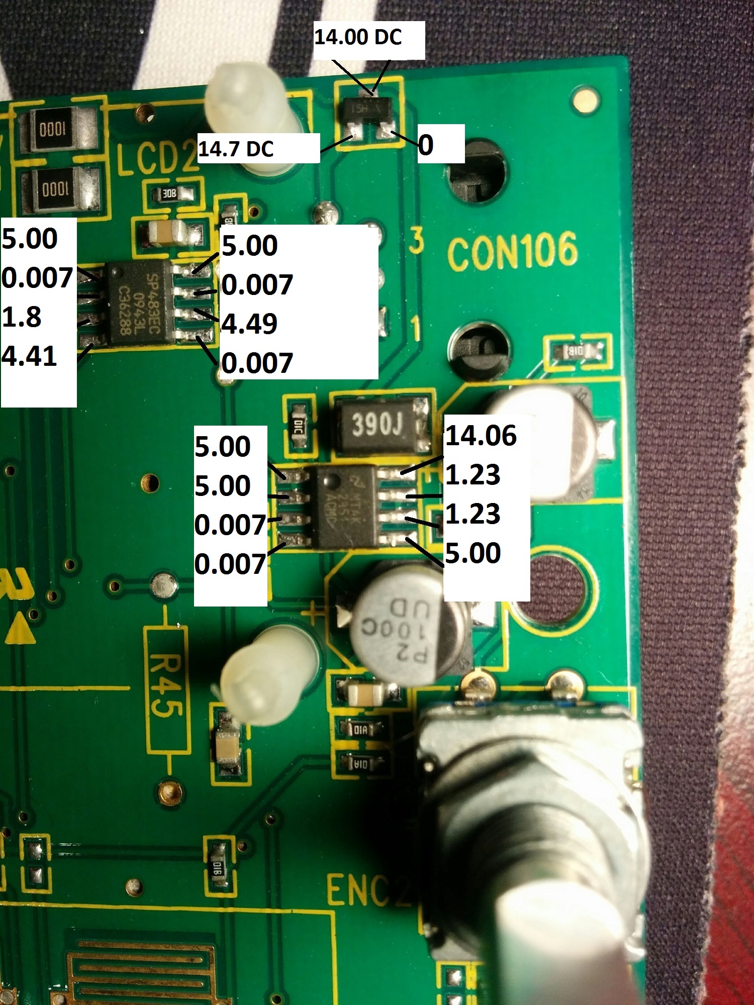

                            Now the "B" terminal is B+ and I have much better voltages on the remote board (photo enclosed).

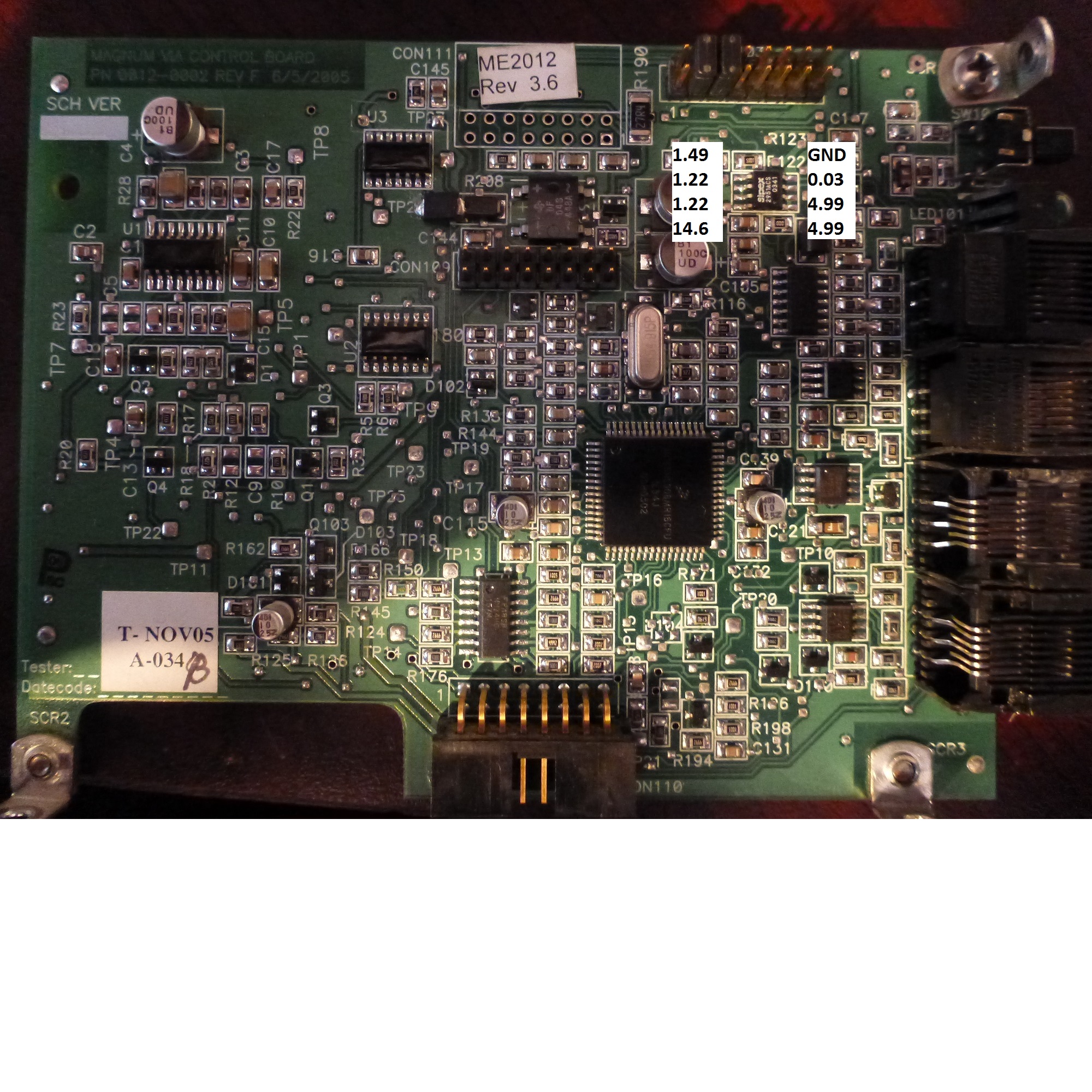

                            The inverter is still going into some kind of protect mode. As soon as I apply battery voltage I throw a big relay and it will not power up like it was before. I am hoping this burnt trace is a step in the right direction.
                            I have enclosed measurements from my suspect 5v regulator and I have rock solid 5.00 VDC.

                                #55
                                The remote is fed by 14.7V, not 5V.

                                  #56
                                  Originally posted by scampo77
                                  GOOD NEWS!!
                                  So now that problem is fixed. We need to concentrate on this new problem. We need to know where the battery voltage is going too on the inverter. It is possible that the relay is held in by another circuit.

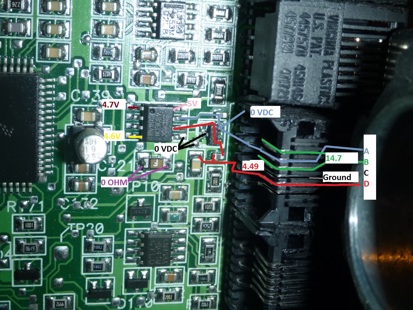

                                    #57
                                    I am confused:
                                    Per Post 45 : AISI, the incoming supply at the remote PCB is regulated as follows: per diagram: So RJ-1B is fed by 14.7V? Feeding 14V to drop down to feed LP2951 3V? That is lots of Vdrops on this LDO.
                                    Post 52: So on the main logic board the regulator 295151ACS is a 5 volt regulator because it has no XX numbers after it. The XX numbers would be like -2.5, -3.0. This is the data sheet for that chip.
                                    If this is what is generating your 5 volts regulated to the remote board Then it has very tight tolerances. It you are reading 4.5 volts that would be out of spec. I also noticed that there is way too much solder on these components on the main logic board. I know if a capacitor gets to much heat near its plate you can damage to connection in a way that the cap will appear to work, but it will not perform correctly.
                                    Post 53 'I have enclosed measurements from my suspect 5v regulator and I have rock solid 5.00 VDC.'
                                    So what is the Voltage feeding the Remote Module for sure?

                                        #59
                                        budm, look at the 4th photo in post #53. The reading of 4.5V appears to be for one of the data pins of the RS485 transceiver IC, not the power supply.
                                        BTW, I agree that the 14V-5V in-out voltage differential is absurdly high, but that's the way it appears to be designed. If we knew the identity of the "15H" part, then perhaps we could determine the allowable input range.
