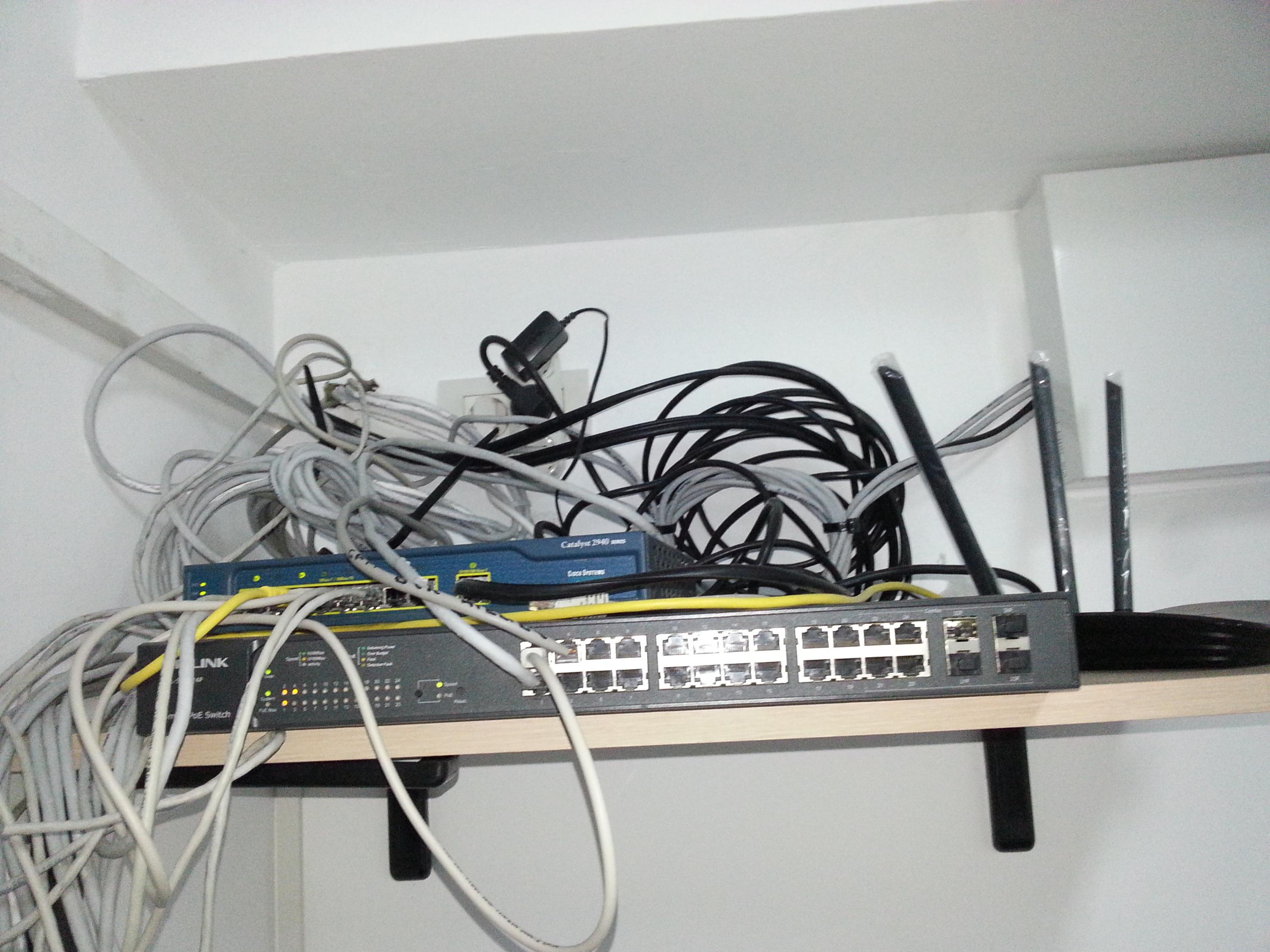

                Quick shot of the network devices used in this branch office I suppose....just for curiosity. As expected, nothing fancy: two managed switches and a wireless router thrown on there (yellow cable). The WLAN is actually incorrectly configured ATM (well, incorrectly given how I would do it), because the yellow wire goes to the "internet" WAN port, rather than the LAN ports, so there's another "sub-Network" being generated by the router, with it being the gateway, when it should just be an access point, part of the same main network, so DHCP should be off on it. I can't access the CRM platform because of this either, so there's some serious issues here....bunch of "experts"....
                Nothing here should've conflicted with my failed Wi-Fi installation, but at least now I know where everything is and how it should be done - the "antenna" should be plugged into one of the swtiches, NOT the phone....nothing should crap out, since it's should be like plugging in a regular device WTH

                  Re: Cisco IP phone F-up
                  what a fucking rats-nest.
                  i'd offer to send you some cable ties, but i see you have used a couple - so it's a question of giving a shit, rather than resources!

                    Not my work, just so we're clear - forgot to mention that Can't go in there to arrange it the way it should be without big boss's permission first. If anything ceases to work, guess who's responsible then ?

                      Are the IT guys getting paid more than you? What a mess!

                        Yes, they are - undoubtedly. The way it works in any large company is you have to prove your prowess in order to climb the hierarchy ladder, that's why I'm constantly going around hunting down stuff that's less than ideal (see aforementioned photo) and suggesting improvements to Big Boss, at least to make him see that I've got ideas and perspectives

                              I made another discovery today: apparently this network is fancier than I thought, because I tried the router trick again on a known working wall plug (no phone or anything) and it didn't work this time around either...moreover, that port shut down ! No joke: after a few seconds, the link just dropped....I thought my damn cable broke, because I got the "network cable unplugged" message when I tried the cable back into my laptop....I've never seen a switch to just completely disable the port like that...
                              The switch is most likely a TP-LINK TL-SG242P. It's got some fancy features built in like independent port control, but I'm not sure why it happened in the first place, I thought I did everything right...I'm no expert, but I thought cascading two switches would be easy (assuming the router acts as a switch now). I thought it did some sort of MAC filtering business, but before this failure, any PC would work on that cable - just this router bring it to its knees somehow...it detects it as an attack or some sh!t like that...

                                Well, just in case someone is still watching the thread, forgot to wrap it up by saying that I did some more in-depth research on how these managed switches work and found the issue: BPDU guard. Simply put, you cannot plug a dumb switch into the access port of a managed switch, or else BPDU guard puts that port in "err-disable" to prevent network instability or some rubbish like that which I didn't care about and apparently this is what happened all along: plugged the router/switch in and the port shut down immediately....
                                The Wi-Fi router in that pic can get away with it because it's plugged into the WAN port which doesn't send BPDUs OR that switch port has BPDU guard disabled on it.
