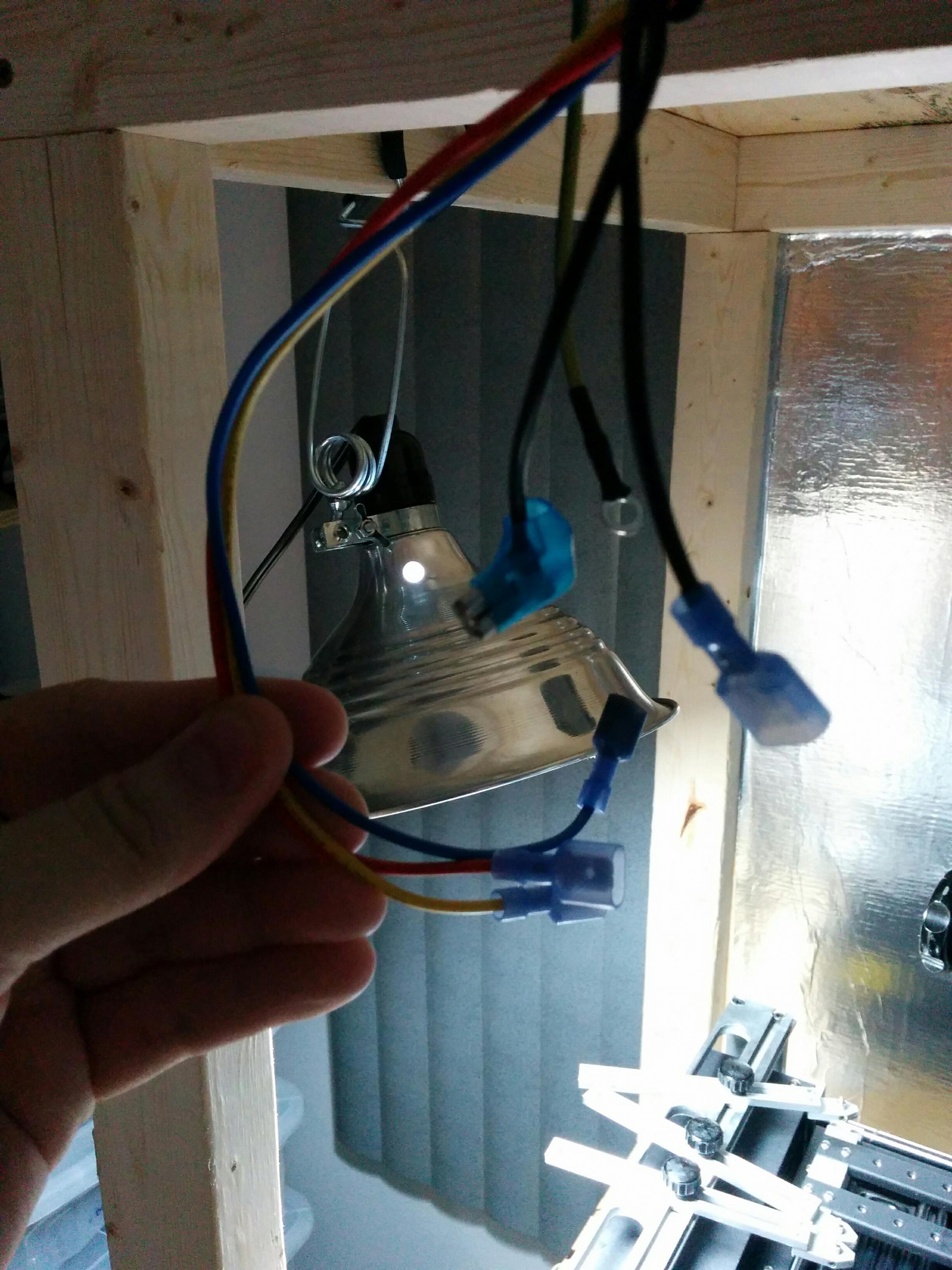

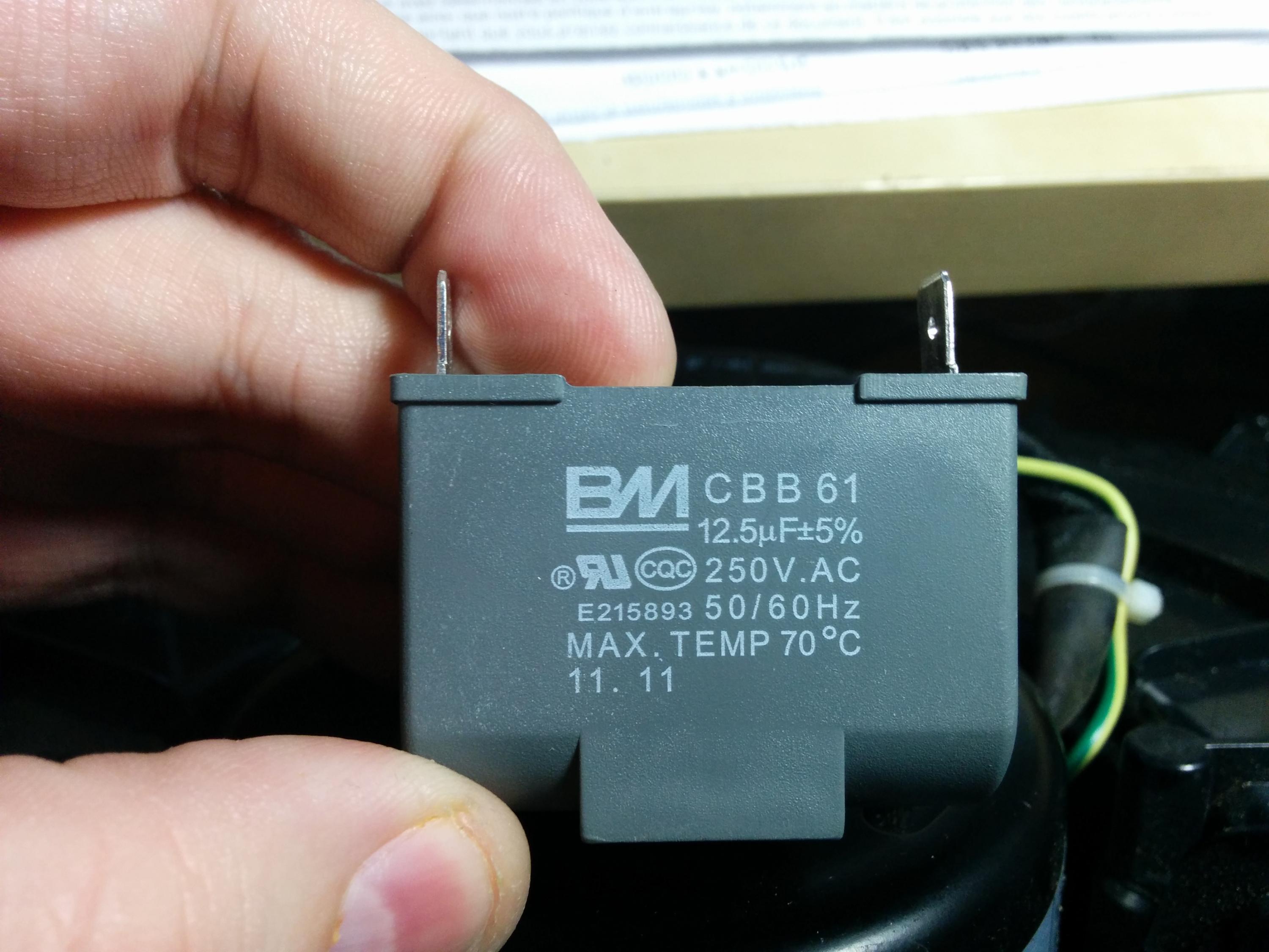

    Hi, I had unassembly a portable LG A/C from the garbage and want to reuse the blower to use it for succing the air from my desk.
    I don't know what is the color wiring codes. I would like to use it directly on 110volt with a varial ceiling controller switch (connect into the maximum blower power, and control it).
    I will need help.

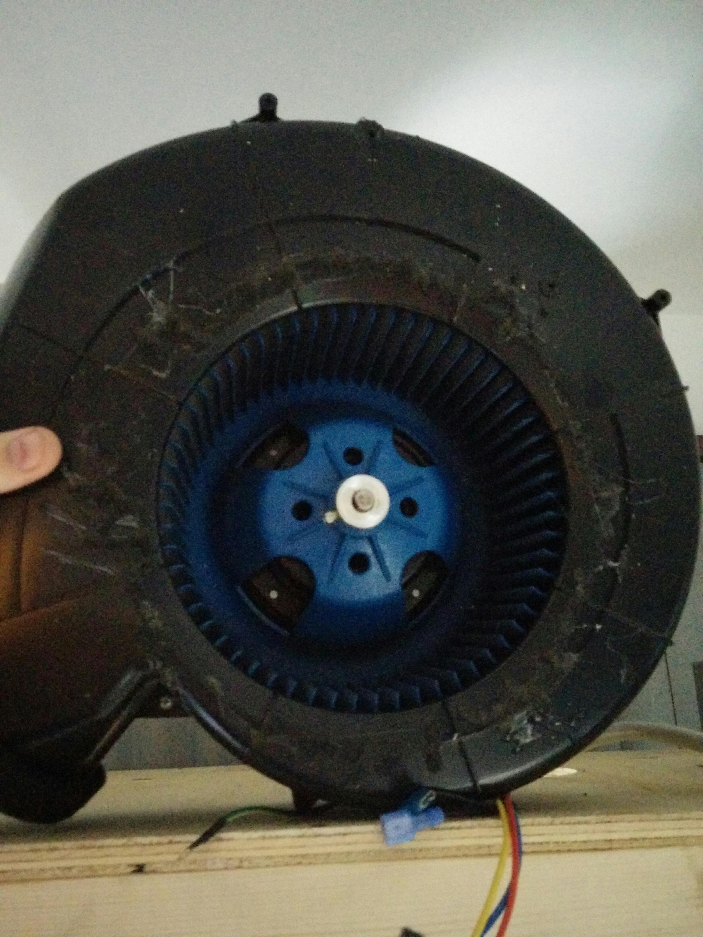

    The blower fan has
    2X Black wires (connected previously on a relay) (i keeped the relay)
    1X Red wire
    1X Yellow wire
    1X Blue wire
    1X green ground wire
    I don't know how to connect it. Any help is appreciated.

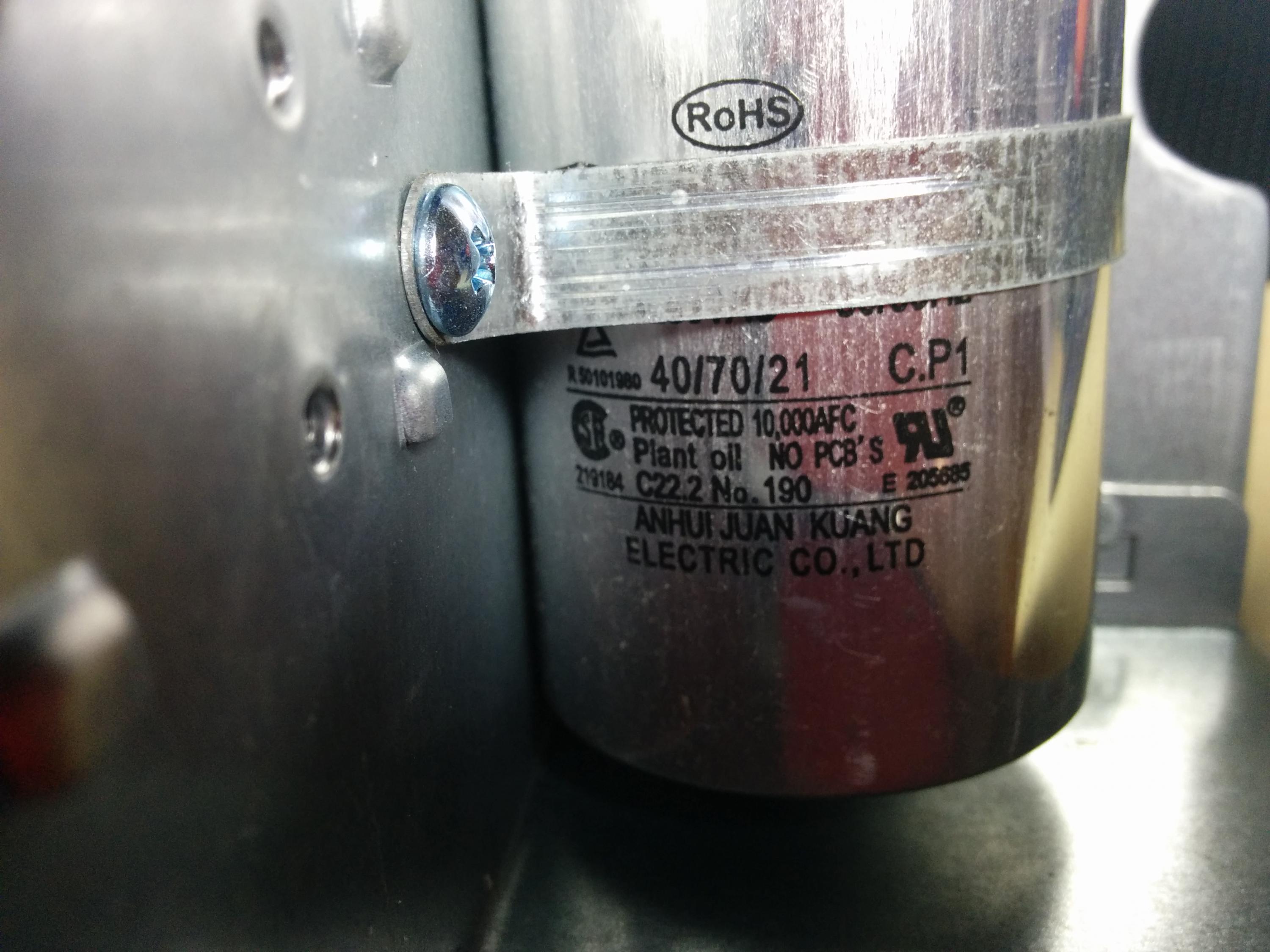

        bet what you called a relay is a cap.

            Re: HVAC Blower Motor Electrics Wires Colors
            Originally posted by sam_sam_sam
            Who make the motor ?
            Did this motor have a run cap ?
            What voltage did this ac unit run ?
            Is there a label on this motor at all ?

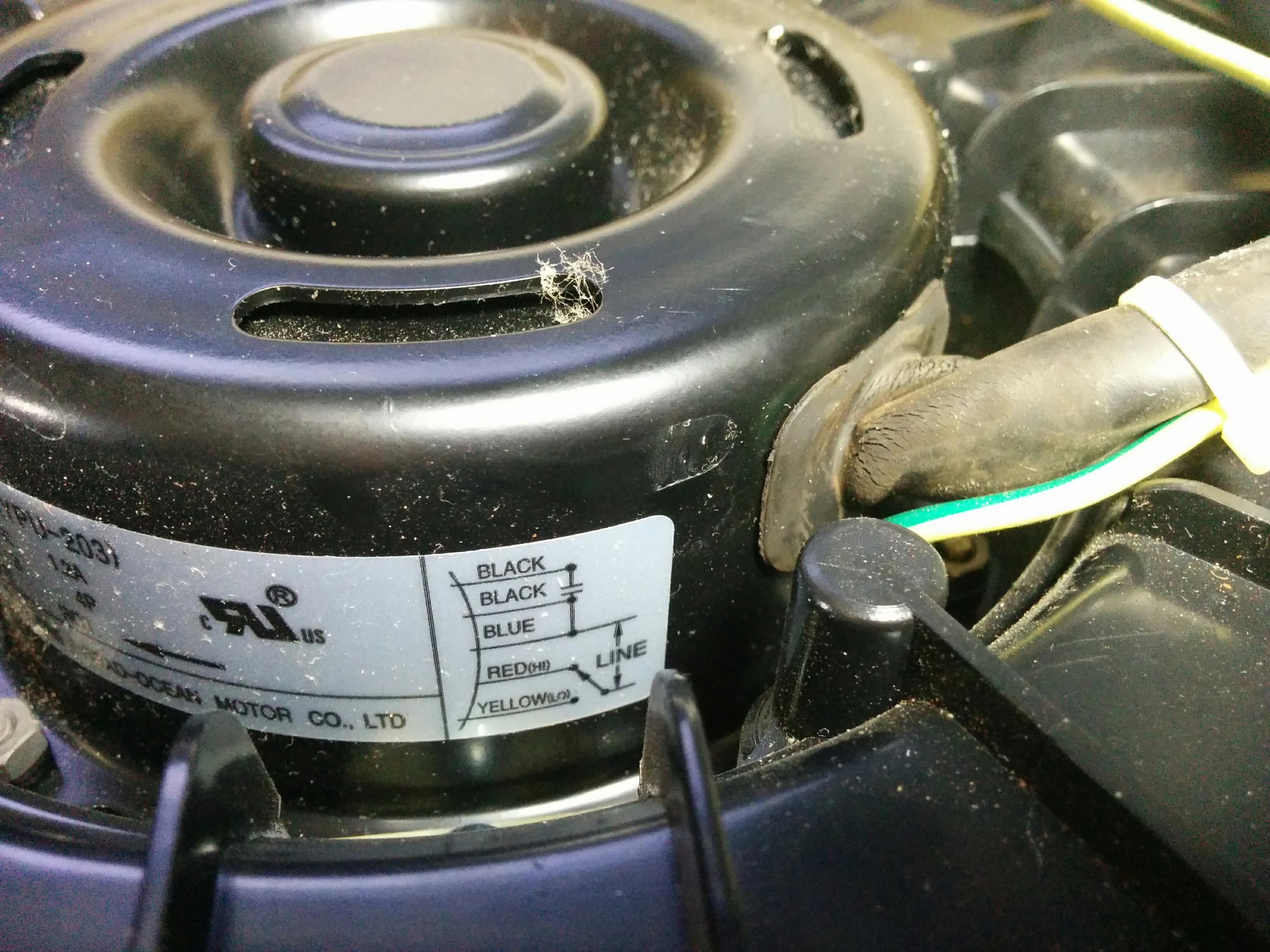

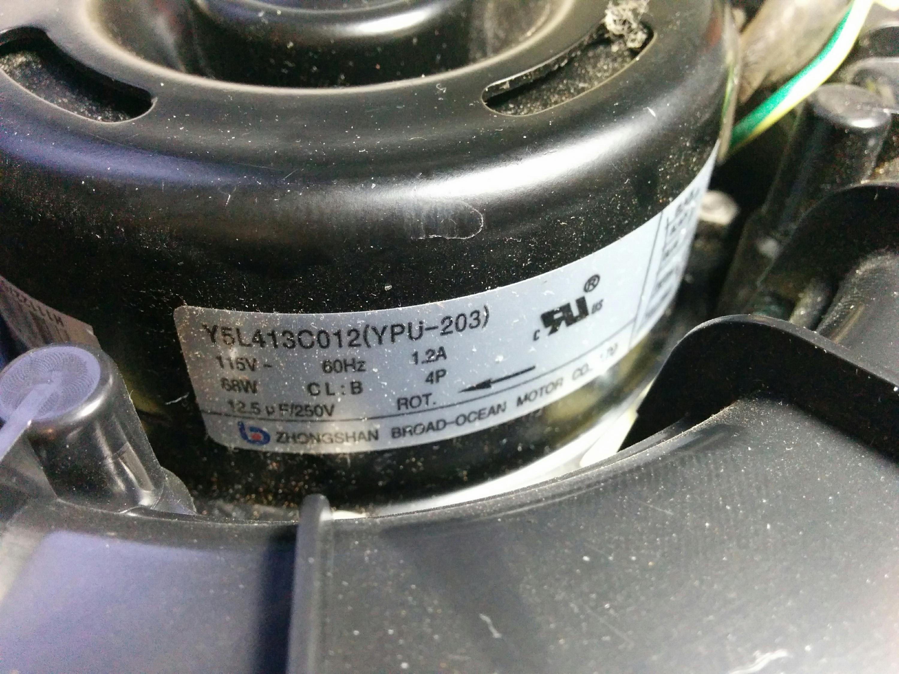

            I unassembly a capacitor, i think it's for the compressor. I took a picture of the capacitor (see attachement).
            Oups.... the 2 black wire was attached into the gray capacitor. I was thinking is a relay, no is a capacitor!
            115V - 60hz 1.2A
            12.5 uF/250V
            Yes see attachement (i found it under the motor assy)

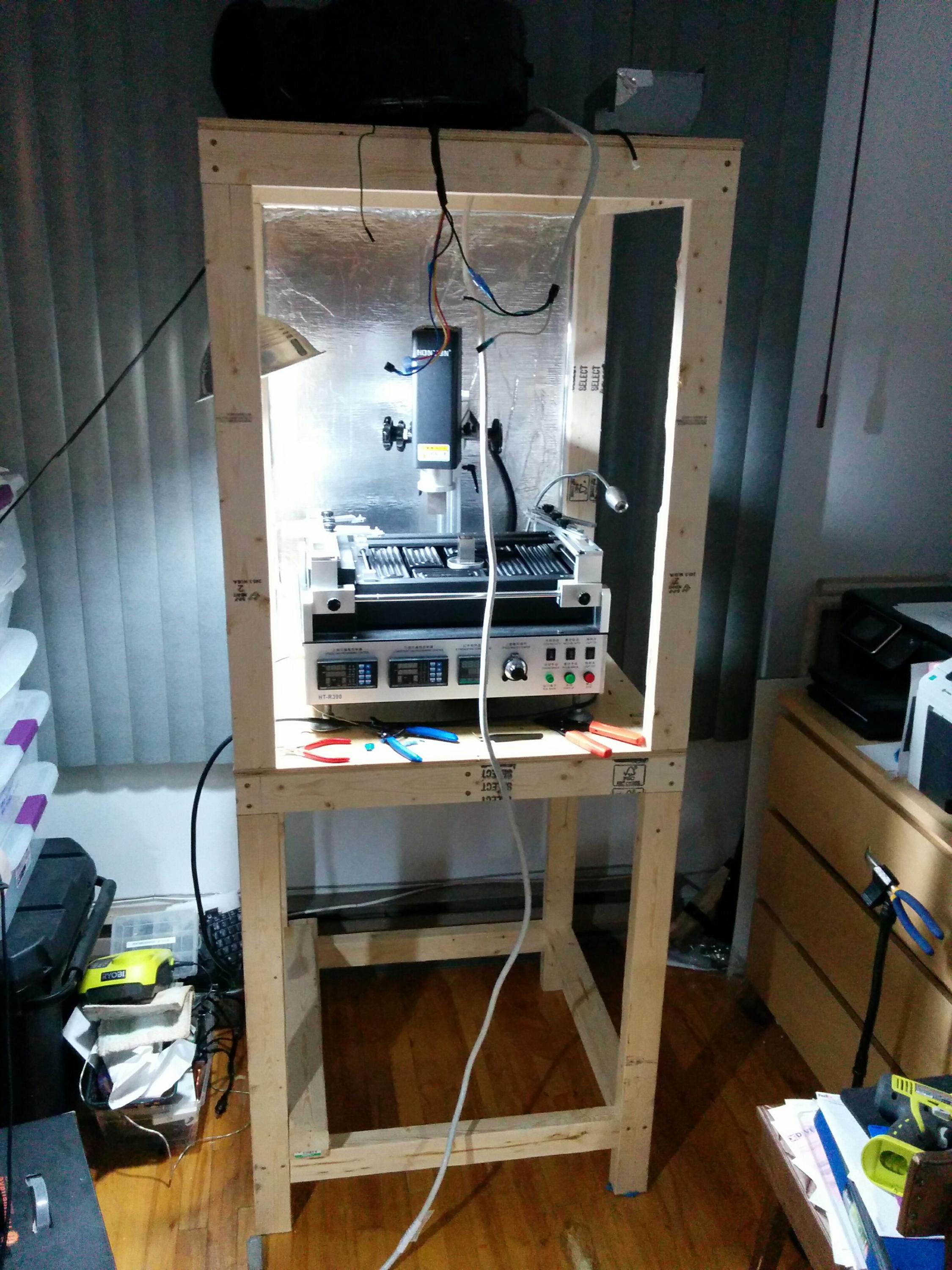

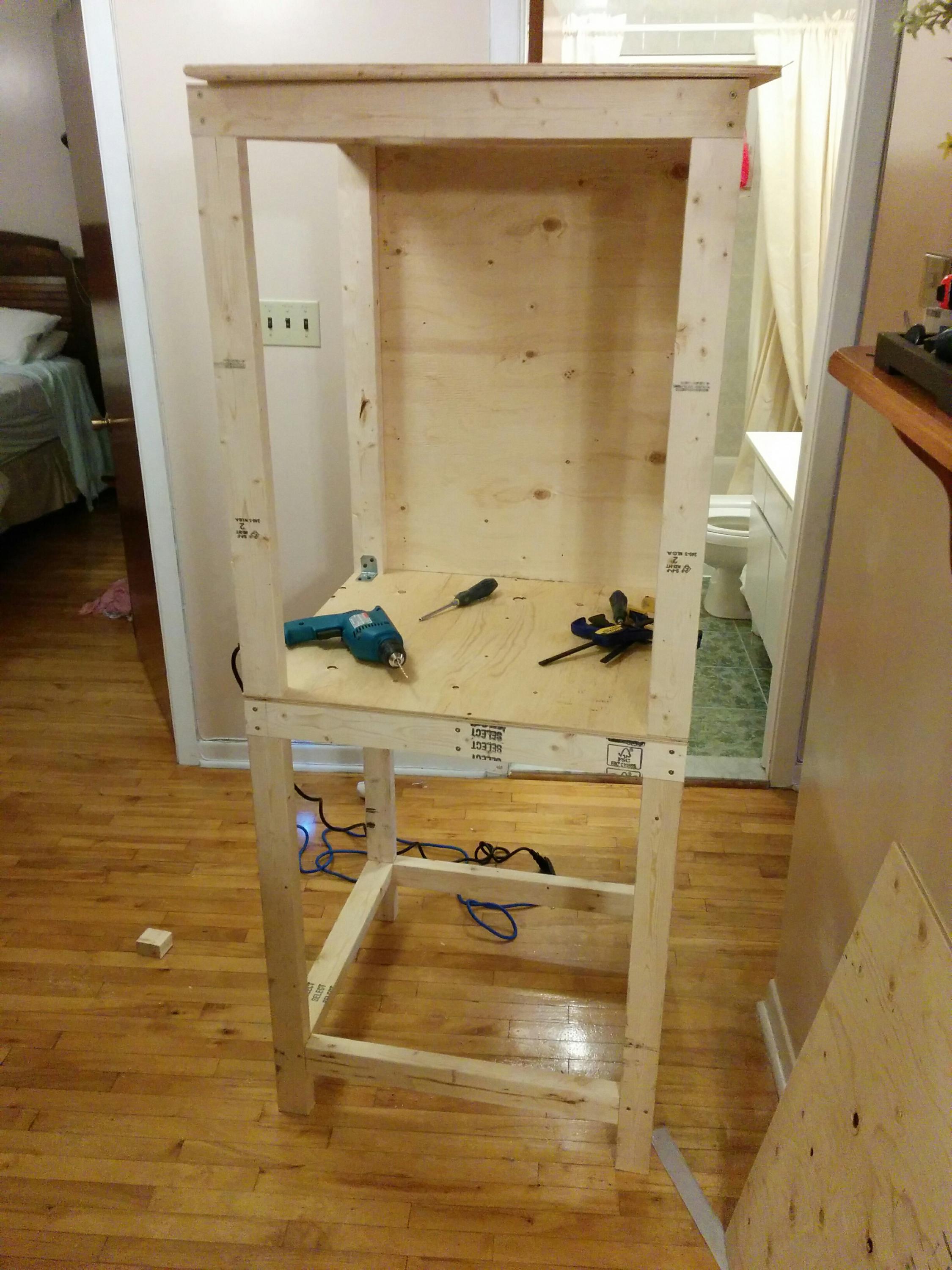

            Exactly, 3 speeds i think. I want to use 1 speed with a ceiling fan controller to control the variation (if possible).
            I want to use it in my Honton HT-R390 reflow/rework station to sucks the air outside. See my attachement of my desk i've build last weekend.
            Not sure if the relay is a relay or capacitor!
            Any help is appreciated. Im happy to see your answers and your time to answer my question!
            The A/C i found is a LG LP1111WXR. Bad compressor, leak, i've keep all the parts except the compressor.
            Thanks everyone! Your help is really appreciated!
            P.S. sorry, my stand for the rework station is not finish. I will add sides closed and need to install a variable switch.

                OK
                The two black wires are your cap leads
                Blue wire is your hot lead
                The yellow wire is one speed
                The red wire is one speed
                This is very important ----->
                Only hook one of these at a time either the yellow wire or the red wire BUT NOT both at the same time if you do that you will fry the motor this is your other hot lead
                I do not think that you can use that speed control --->
                Here is a way you can find out hook your motor up the way I was telling you and if you have an amp probe measure them amp using red wire then do the same thing using the yellow wire which ever wire get you close to 1.2 amps use this wire on the speed controller and at full speed it should not read any higher than the 1.2 or so reading you got with out the speed controller
                If it work OK then you have one more thing to check that is at the lowest speed that you are going to use -----> the amp reading should not be more than 1.2 or so
                In fact it should be a lot less after running the motor for 15 minutes the tempature of the motor should NEVER get so HOT that when you put your hand on the motor and if you can not keep it there because it so HOT you CAN NOT use any speed controller on this motor
                I hope this helps
                  It looks to be only 2-speed (HI and LO), as you can see, the motor wiring only show 2-position switch to select the speed.
                    Great. It"s worked! Thanks.
                    I've use the high speed, if too much powerful, i will use low speed. Thanks.

                                I had 3 capacitors with this air conditioner.
                                1 metallic is for the air compressor;
                                1 gray lower blower
                                1 gray labeled upper blower.
                                Capacitor fit with label of the motor uF value.

                                    The right cap for this motor is a 12.5uf@250 volts
