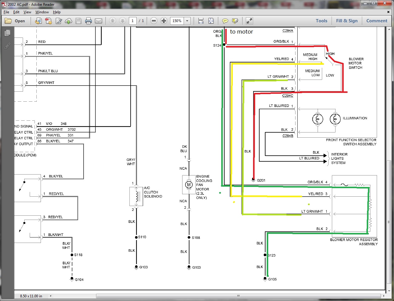

    So I picked up this little truck, and the blower motor does not work correctly. There are 4 settings, Low, Med-Low,Med-High, and Max. The issue is Low, Med-Low, and Med-High ALL act like Low. Max works like Max.
    So research tells me it is the resistor block for the blower motor. So I change that. Still works the exact same. More research tells me the plug going into the Resistor block often gets corroded and faulty, so I change that. Still works the exact same. More research says sometime the switch in the cab goes faulty. I replace that. STILL WORKS THE SAME.
    From what I understand from the schematic, on Low, the switch just goes to ground, and the current goes through all 3 resistors on the resistor block, providing max resistance and lowest fan speed. When you select Medium Low, the current goes to the Med Low wire going into the resistor block, and then through 2 of the resistors, and the fan goes faster. Med Hi send the current to the Med Hi terminal on the resistor blow, which only ha 1 resistor in front of it, and you get even faster fan. Max bypasses the resistor altogether and you just get max power to the fan.
    But for some completely unknown reason, Low, Med Lo, and Med Hi ALL act like low. Max works like Max, since that bypasses the resistor block.
    Here is the schematic
    https://file.io/YCa0gpeJGjP7
    Someone in a Ranger forum said this:
    When key is on and Mode/Vent switch is in any position except OFF, the blower motor gets 12volts
    The resistor block is always Grounded by its black wire(G105), but thru 3 resistors, which would be Low speed
    If the speed knob in the dash was set to med. low then resistor block has a NEW ground path and only thru 2 resistors, so higher fan speed than Low, NEW ground path uses G201 in the cab
    Med. high changes to NEW ground path thru 1 resistor, so even higher speed, also use G201
    High speed by-passes the resistor block entirely, no resistors, it's a direct ground for blower motor, via G201
    So if low, med. low, and med. high all seem to be the same speed, then med. low and med. high wires, or switch contacts, are not giving a NEW ground path in resistor block
    But I have no idea what to do with that. Even with everything replaced, Lo, Med Lo, and Med Hi are ALL grounding to G105.
    Any ideas what I should test next? From the wires I can see, I don't see anything cut, spliced, or tampered with to cause a short to the G105 ground. And I have replaced the resistor, plug, and switch.

    If max speed works, then there is a path to ground (for the motor) via the blower motor switch. if it operates on low there is a path to ground via the blower motor resistor ass'y, (bypassing the switch completely) so that leaves no connections between switch medH and medL and the resistor ass'y. So likely no connections on the yellow/red or the LT grn/wht wires
    Red trace is the path to ground via the switch, Green is the path to ground via the res. ass'y. For Medium High to work there needs to be a path to ground via the switch ground (3), the switch pin4 to the res. ass'y pin3

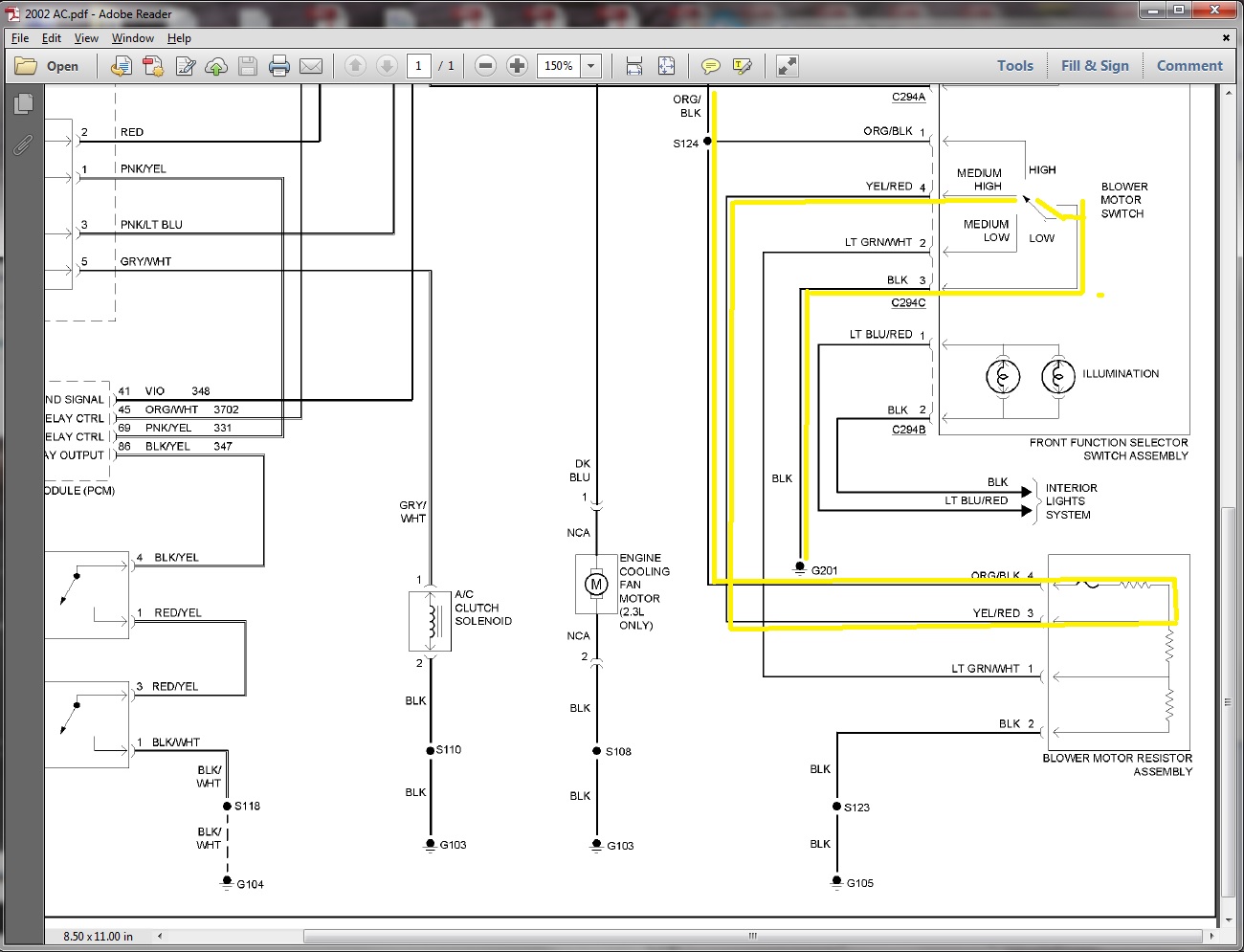

      Both those wires are connected to both the switch (inside the cab), and the blower motor resister plug. They are connected
        Then the medium speeds must be working. With the switch in the medium high position, ground pin3 on the resistor network, does the speed change? if yes, the path is open between the resistor network and the switch, if the answer is no, then the resistor network must be bad.
          So to do that, I would set the switch in the cab to Med-Hi, then connect the Yellow/red wire coming off the resistor block to a a piece of jumper wire and touch the other end of that jumper wire to a ground point on the car? And the fan should be blowing med hi? Or do I set it to Low, then ground out that wire and see if it switches to Med hi?
          This is how I identified a ground point: I put my meter on continuity, then connected the black wire going to the resistor block to one probe, then poked the other probe around until I heard a beep. I ended up getting a beep on some metal tube near the engine. Is that point a ground?

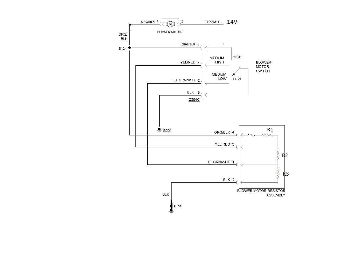

                    Here is the blower only part of the diagram. It is easy to understand. 14 volts is supplied to one side of the motor, the other side of the motor controls the speed, if it is connected to ground, it runs full speed. if it runs through the full resistor block it runs slow. If you connect pin2 to pin1 it bypasses R3, if you connect pin2 to pin3 it bypasses R2 and R3.
                    If need, remove the resistor block from the heater it does not need to be mounted for this test.

                        I understand the diagram and how it is supposed to work, but I don't understand why it is not working since everything has been replaced, and all the grounds seem to be in place. The only things in the circuit are power, the resistors, and 2 ground points, G105 and G201.
                        • The blower motor is getting power, so I know the fuse and relay are working, or the fan wouldn't spin
                        • I know the blower blows on MAX, so I know the G201 ground point is good, because on Max, the power just goes right to that, and it works.
                        • I know the blower blows on Low, so I know the G105 ground point is good, and I know all three resistors are in place, because on Low, the power goes through all 3 resistors and goes to G105 and blows low.
                        Med Hi and Med Lo simply take the circuit from their respective resistor terminal and bring it to G201. And we know G201 is good. So the ONLY thing that could be causing the current behavior is a break in the circuit between the Med Hi and Med Lo terminals on the resistor block, and G201, right? If I am understanding this correctly, if that connection was broken the circuit ground would be G105, which is Low, which is why Med Lo and Med Hi both act like Low
                        But literally ever connection in the circuit is brand new. New switch, new plug, new resistor block, so where could it be broken?
                              The only thing that can cause this problem is broken connections between the switch and the resistor block. NOTHING ELSE. it is the switch that shorts the appropriate resistor to ground so if you switch to medium high and the speed does not change and you replaced the switch etc, the only thing left is the wires and connections between the switch and the resistor block.
