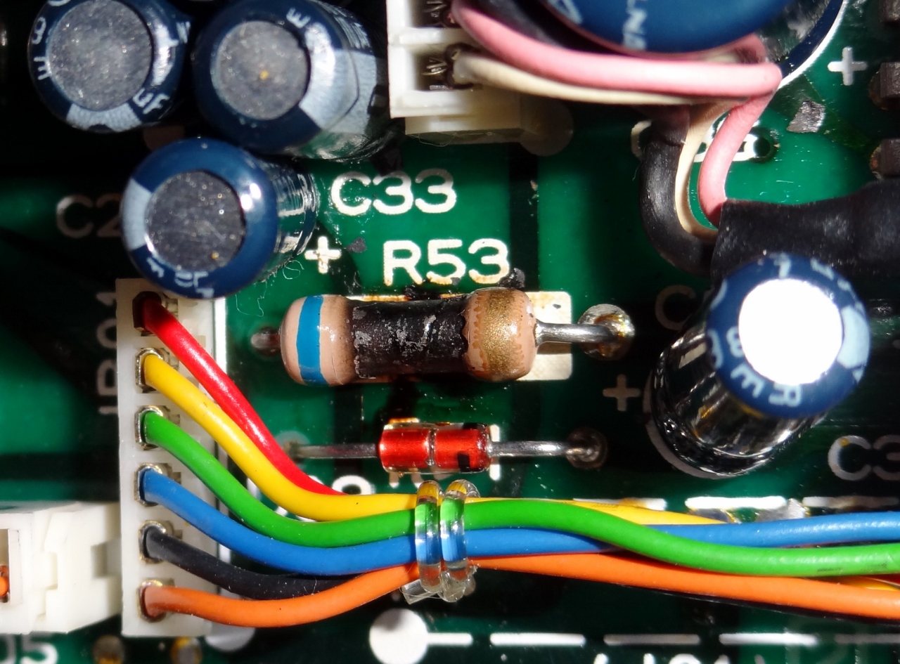

    Is the below resistor toast? I had my brother in law look at cb radio as he's into them and he says it is just a dummy resistor and its normal.
    But looking at it, it looks badly charred, don't want to mess with it if its ok and looks a pain to remove board and the radio works fine.

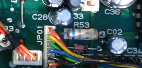

      found a pic of resistor
      blue grey gold gold
      can I measure it in circuit board?

        Yaesu FT-290R MK2

          I've seen toasted resistors like that still be within tolerance and keep working but it raises the question of why did it overheat like that in the first place. Look for THAT problem. It needs to be replaced regardless but it is not a dummy load resistor, it's only a 1/2 watt.

                6.8ohm 5% probably about 1w and it should be non-inductive.
                  Re: Is this resistor toast?
                  top-left on the 3rd schem.
                  6.8ohm .5w

                              It's on the 4th schematic, not the 3rd, and it is not a dummy load resistor. It is inline with +13.8v supply. Something shorted. Possibly a cap downstream connected to chassis gnd shorted then opened internally, like c34. The radio would probably still work without c34 but probably noisier audio and/or less stable than with it since that's audio output section.
