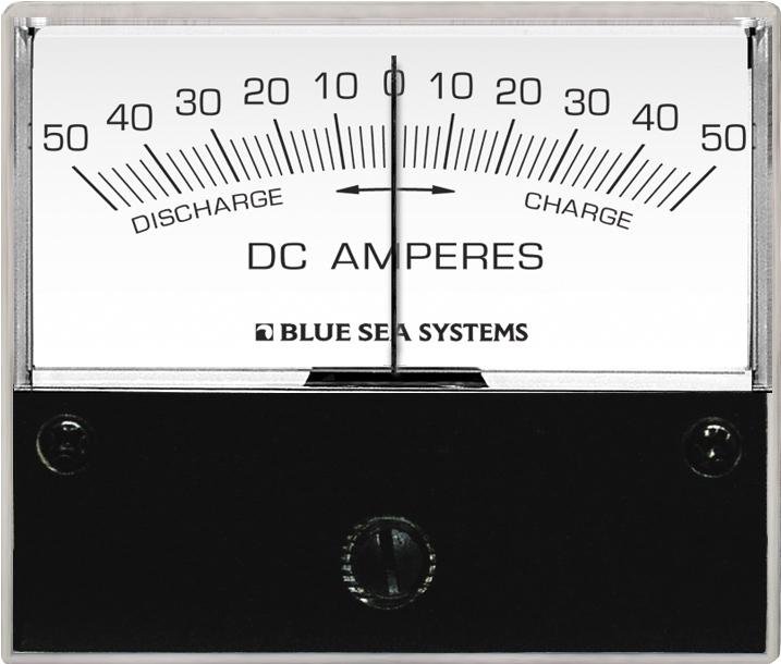

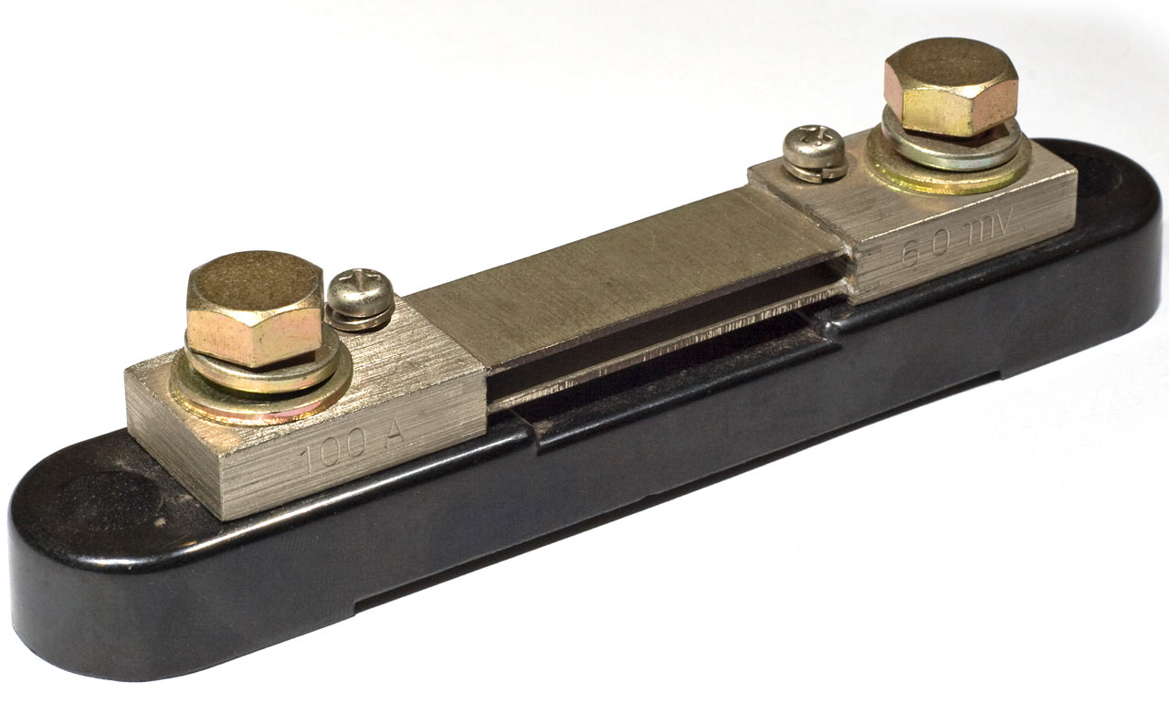

          If the amps are small enough you can just put in an ammeter but it has to be real small. Otherwise you have to put in a shunt and hook the ammeter to it.

            What does that mean? What's a shunt? How small is "small"? How many amps, etc...? Why does it have to be small? The whole concept of "smallness" her escapes me?
            Is an ammeter on a standard multimeter, or is that a separate piece of equipment?
              Re: How to Test if Battery is Actually Rated Capacity?
              If the load your testing is only a few milliamps you can put a meter in the circuit. More than that, and you will overload the meter and must use a shunt. The shunt lets the majority of the current bypass the meter.
              Some multimeters can be put in series with something and measure the current itself but only to it's rating. Some multimeters have a loop you put around a wire and senses the magnetic field to calculate the current flowing.

                Using very low value shunt resistoras suggested is the good idea, if you are going to use your your meter in series with the load, I would suggesting using the shortest and bigger wire gauge for your test leads.

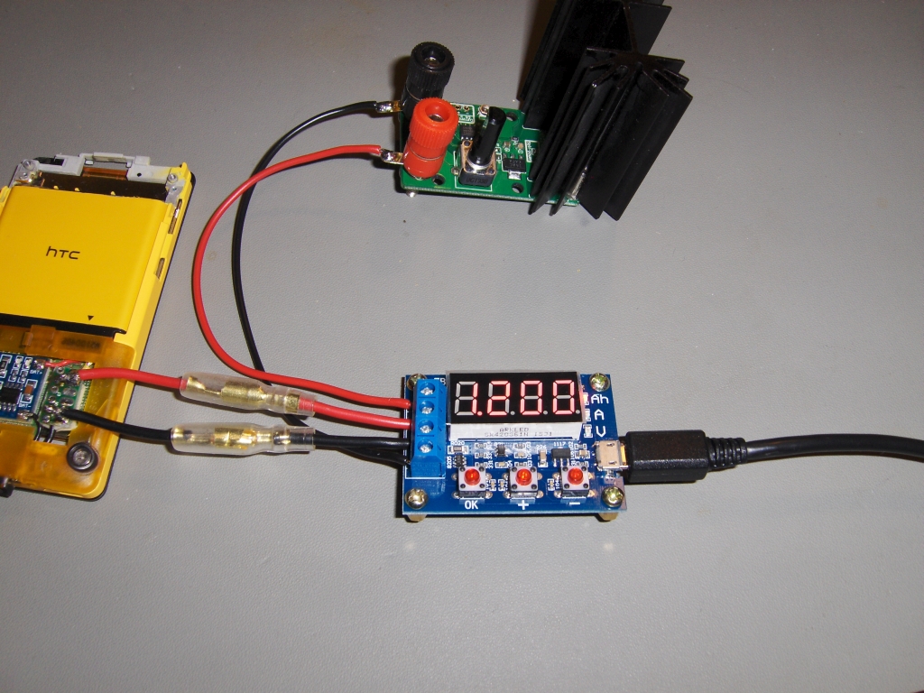

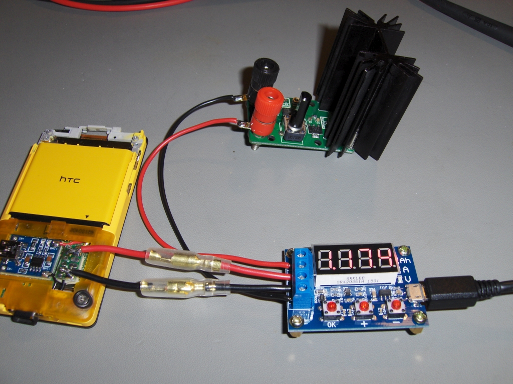

                                        I bought a Re:load 2 and a ZB2L3 v2.1, I have around 30 1200mAh used Htc batteries and I wanted to test a few and keep some of them.
                                        Seems pretty accurate, tested two of them and one battery was 1200mAh and the other one was 1174mAh.
