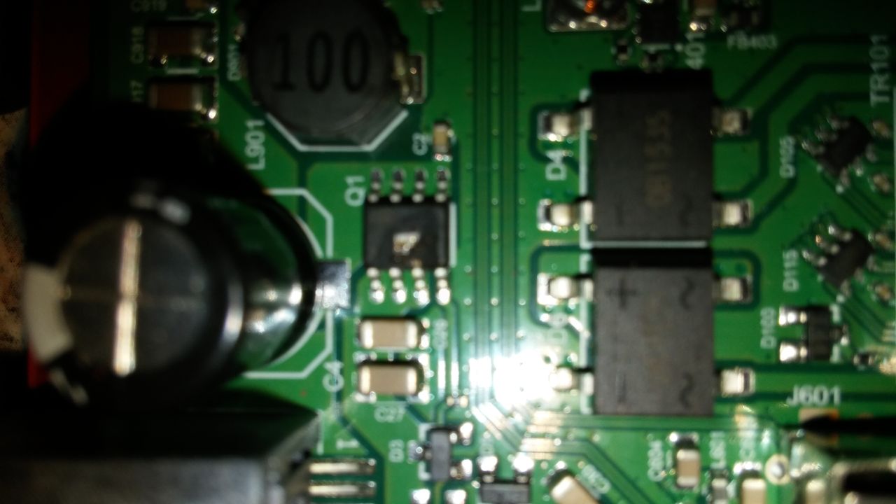

    got a rb2011uas-2hnd-in model router from mikrotik, anyone knows what value is for Q1 (8 pin chip),or does someone have a service shematic ...

    Upload a photo and someone will probably be able to work it out.

      Here is the photo

            it looks to be a mosfet
              +1

                I have got a reply from mikrotik,that i short the upper and lower pins from mosfet,and if it
                turns on it is on him,if not its somthing else ...
                No luck,it will not tur on ...
                thx for trying to help
                greetz
                  Re: mikrotik routerboard
                  The MOSFET was blown up that bad which meas the circuit was heavily over load so you need to check for low resistance of the load to that circuit.
                  Check the 4 pins on the top row against GND, then the 3 pins on the bottom row against GND to see what you get.
                  BTW, how about uploading the pictures of the whole board top side and the bottom side?
                    I agree.
                    However, routers generally come with pretty small power adapters capable of no more than 10-15 Watts output. That's enough to short a MOSFET... but to blow it like that takes a lot more energy, IMO.
                    Do you have any history of why the router failed? Left on during a storm perhaps? (i.e. damaged by lightning strike.) Or maybe the wrong adapter was used?
                    It would also help if you post a picture of the entire router board, both from the top and the bottom. That way, we might be able to figure out what that MOSFET is powering.
