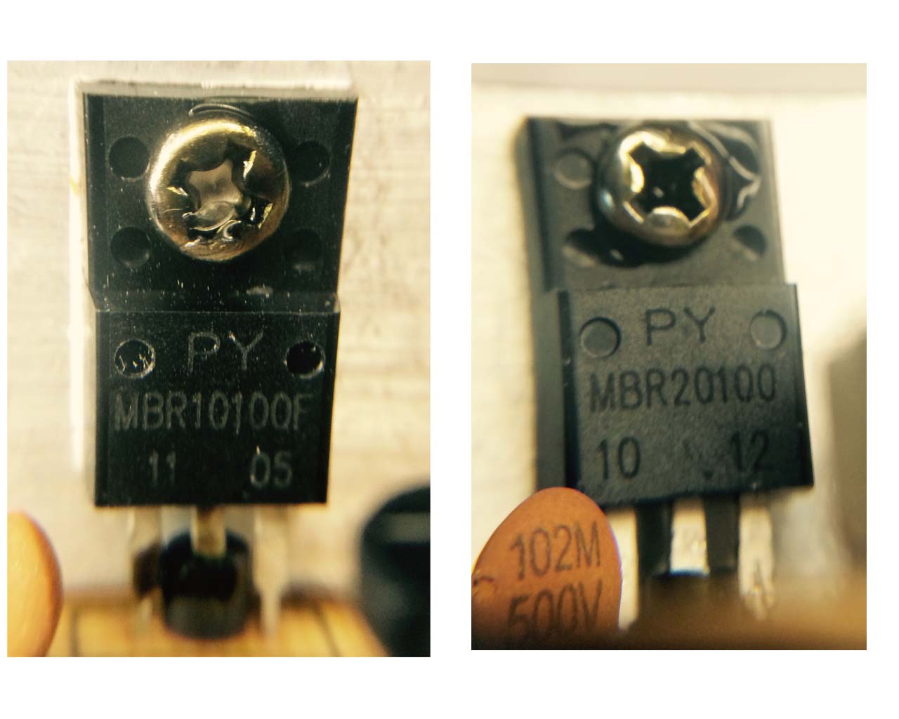

    Please help identify rectifiers
    Hi Gentlemen!!
    I need help to identify the two rectifier in the picture.
    What does the lower left and lower right number mean?
    Please advise, thank you much!!.
  • diif
    • Feb 2014
    • 6978
    • England
    Re: Please help identify rectifiers
    They are date or manufacturer codes and not needed for part identification.
    • SteveNielsen
      Retired Tech
      • Jun 2012
      • 2327
      Respective spec sheets.
        • 30965
        20a 100v schottky rectifier
        MBR = schottky rectifier,
        first 2 digits are the amperage, remaining are the voltage.
        the rest means nothing, it's for factory use to indicate factory, production line, date etc.
