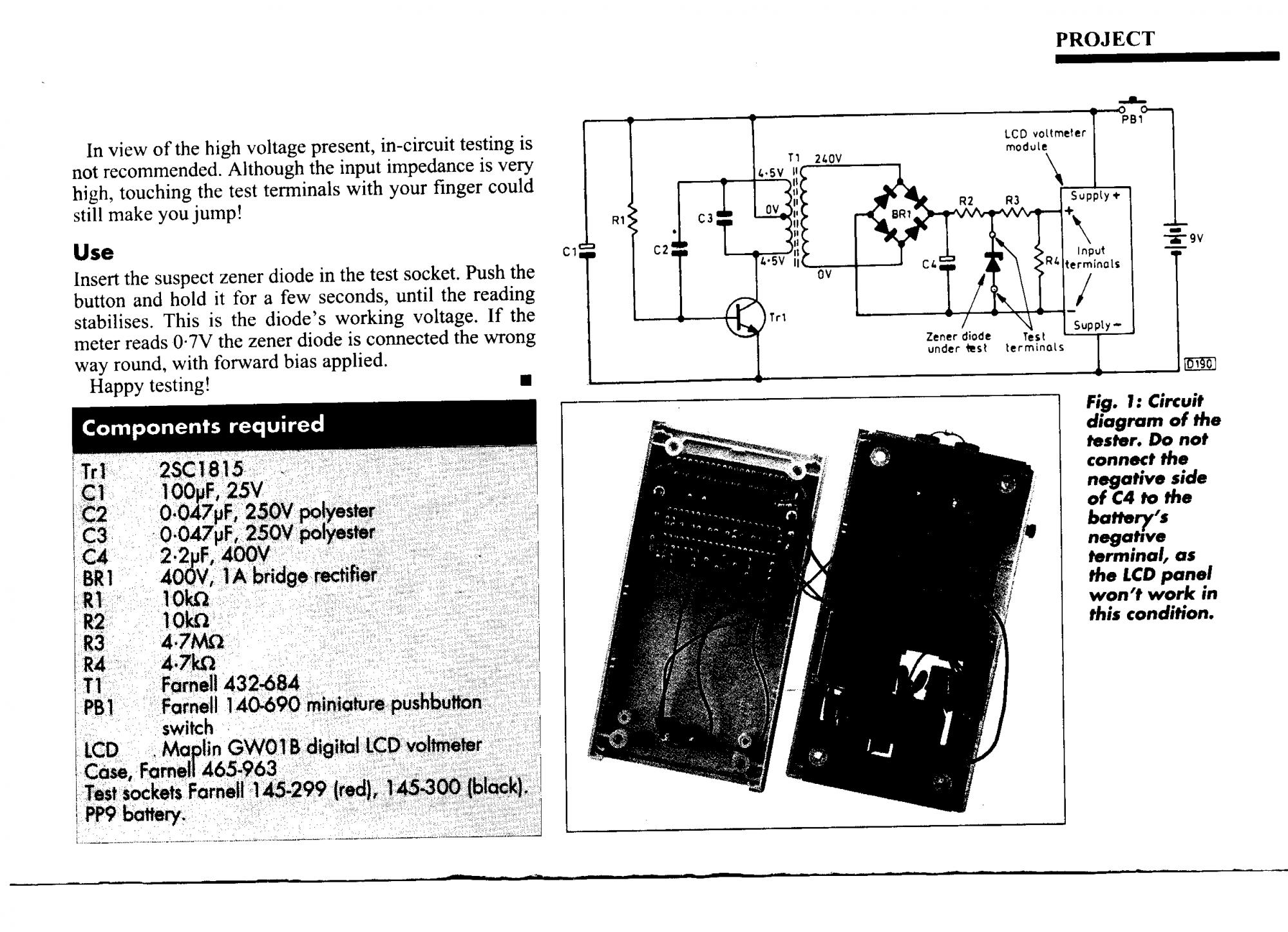

            • 31255
            Re: zener tester
            just to add, if you use your multimeter, you connect it across the zener

                Re: zener tester
                If you already have variable output DC power supply, than all you need is the resistor to limit the current through D.U.T. and the meter hooked up across the D.U.T.
                Or build this portable tester.

                  • 31255
                  Re: zener tester
                  shall i draw a modern schematic of a variant that uses a multimeter and a more common transformer?

                    Re: zener tester
                    I built one years ago using a small surplus 60VAC transformer and a 10mA constant current source. Was quite useful to test zener diodes or to use as a simple 10mA current source. I built it to handle a 80V zener that we used that would fail every so often, but it was also useful to test high voltage rectifier diodes that had a 20V or so forward voltage drop. Reverse voltage testing on those was with a 10kV insulation tester, which would show any gross faults, but which was not much use as the equipment in question ran at 30kV on the anode. At least the 10kV allowed us to trouble shoot without burning up anything else in the test phase. It was way to high for any other use, as it would happily kill any mains rated cabling it was attached to, and would make things like sockets arc over internally.
