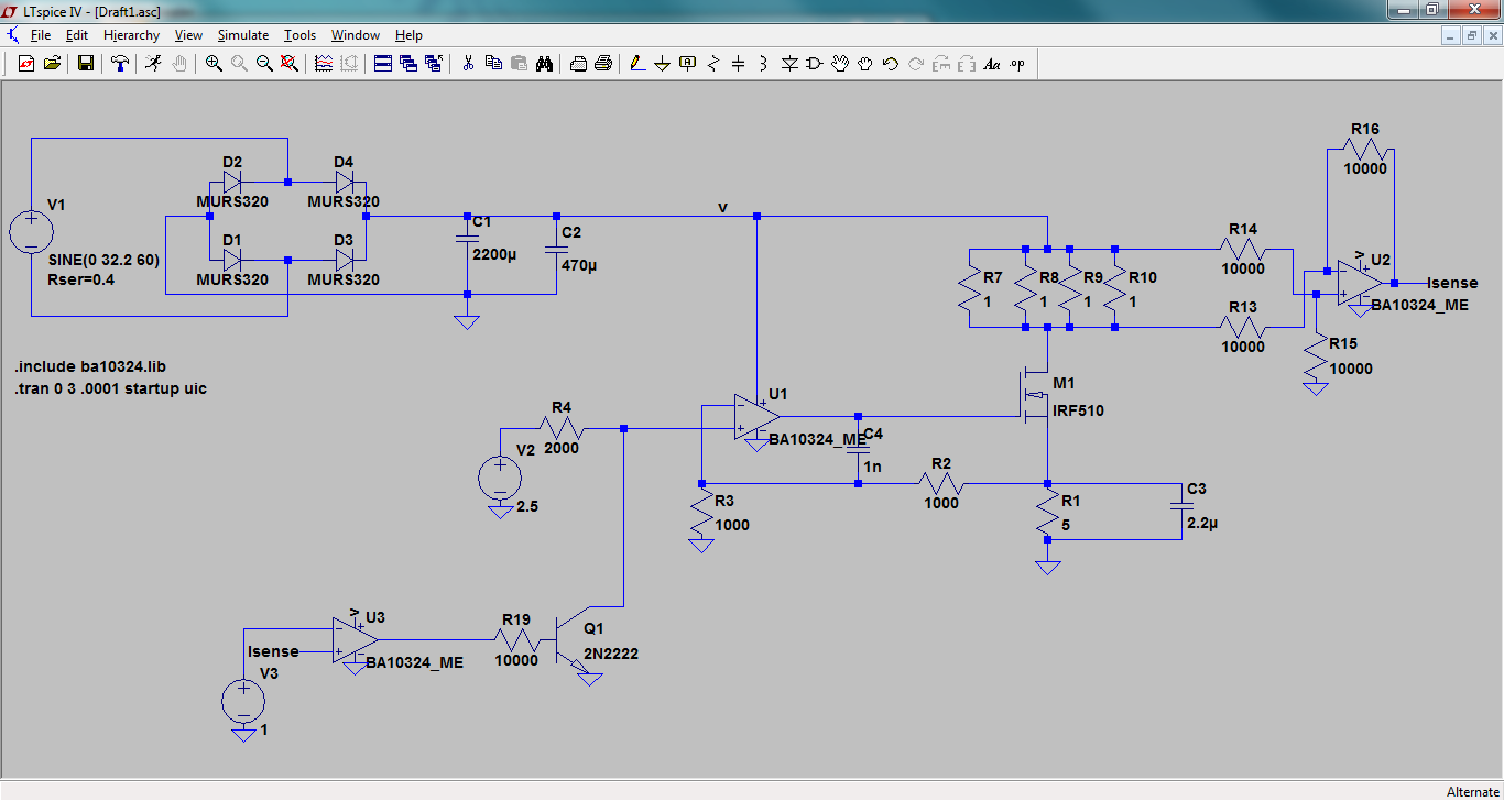

                Here is the schematic. R1 and C3 are the load. The cap is there to make sure it won't oscillate with anything other than a purely resistive load. I have been changing their values to test the circuit at varying loads.
                I would like to get at least 1A out of this power supply, but I don't know how well it will actually work since the op-amp's PSRR isn't simulated. It would be nice to get more current out of it than that.

                  Re: Power supply current limiting
                  So what do you want to happen when the current limit is reached, should it go into latched shutdown so it will not oscillate when the load current goes back down to normal, manually reset when current goes back below the set point?, what is hysteresis threshold if auto reset? You need to figure what the requirements are.

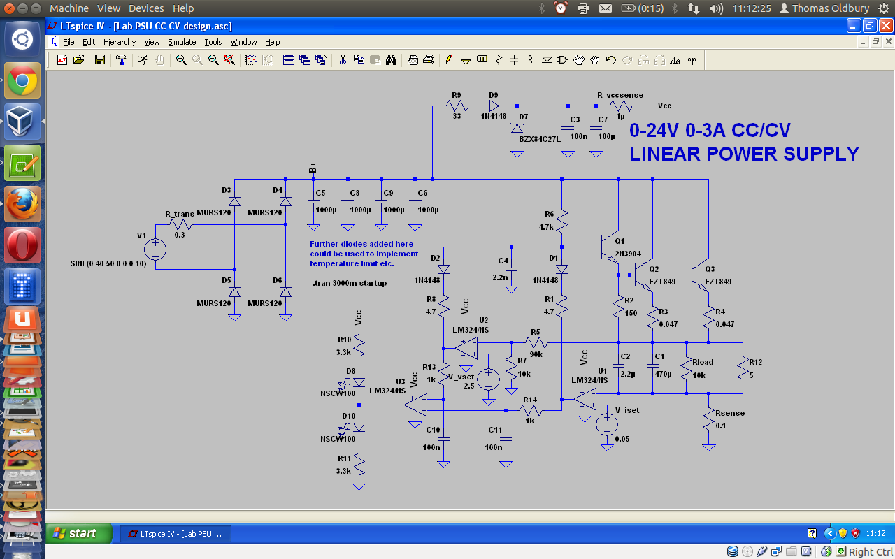

                          Here is a PSU I designed a while ago; I've never built it though since I found one cheap enough. 0-24V 0-3A. Has no tap switching on the transformer, you will want to add that to limit the power dissipated by the pass transistors. Analog control loop stuff is easy! One LM324 for all the logic.

                            I didn't think it would be a very good schematic. R1 is the load, like I said earlier.
                            My PCB layout "skills" definitely suck. I don't know if this thing will work at all when I build it.
                            Currently, I don't like that the op-amp is running so close to its absolute maximum supply voltage. The unregulated power supply could hit 32V (the BA10324's absolute maximum supply voltage) with a light load if it is left powered for a while. I only have a 7805, a 78L09, and some TL431s to use, and I need to power a 12V fan. Also, decreasing the supply voltage will reduce the maximum output voltage.
                            This project is starting to look like a complete failure.

                              Essentially you need to create a "min" function: the power supply selects between the minimum of the two command signals. One signal will try to keep the output voltage at the set point, the other will try to keep the output current at the set point. The design linked is capable of reaching set-point current from direct short within 40us.
                              One way you can acheive this is using diodes, like I did in the above schematic. Another way is to use a transistor OR-ing circuit where transistors would turn on to limit voltage or current appropriately.
                              Try to construct a voltage-controlled supply initially. Then construct a current-controlled supply. Try to consider how to combine the two parts.

                                    I was thinking about this again, and I ended up building the circuit I was simulating. In real life, it's stuck in current limit mode because the difference amplifier (U2 in the crappy schematic) outputs a constant 0.77V, and I don't understand why. Connecting a battery across the inputs instead of the shunt resistor causes it to output the correct voltage. The resistors I'm using have really weird markings, but they measure 6.85K ohms. They appear to be labeled 01b with a line above the 0.
                                    I wonder if low side current sensing (like the circuit in post 6) would work better. I'd have to make a lot of changes to the circuit board, but I'm using a Radio Shack prototyping board right now. It's always going to be a big mess with the components I have.

                                      I guess I should add some actual measurements.
                                      The voltage on each end of the shunt is about 29V (output from the bridge rectifier). There is no voltage dropped across the shunt because the output voltage is zero (the current limit circuit thinks the output current is 3.08A, so it forces the output to 0V). The voltage measured directly at the op-amp's non-inverting input is exactly half of the supply voltage because the two resistors on that input form a voltage divider. The voltage on the inverting input is 0.4V lower, and the output is 0.77V.
                                      Maybe the BA10324 (LM324 clone) isn't a good choice for that circuit, but the only other op-amp I have right now is a TL064.
                                      Placing the shunt in series with ground will cause poor regulation, and I can't think of any good way to compensate for that. I could add the voltage drop back into the set voltage, but that doesn't work very well in the simulation. There is a lot of ripple on the output if I do that, and it would require more op-amps because I would have to add a buffer on the potentiometer output and figure out how to make a non-inverting amplifier with a gain of 0.5 (the potentiometer range is currently 0-9V, so I would have to divide the voltage drop from the shunt by 2) before adding the two signals. I'd probably be better off increasing the reference voltage to 18V instead of trying to divide a signal by 2.
                                      With the current limit disabled, it does work and give 0-18V output with no apparent issues, so it is better than nothing. Unfortunately, I don't have the parts to build a better circuit, and I don't want to buy the parts right now.
