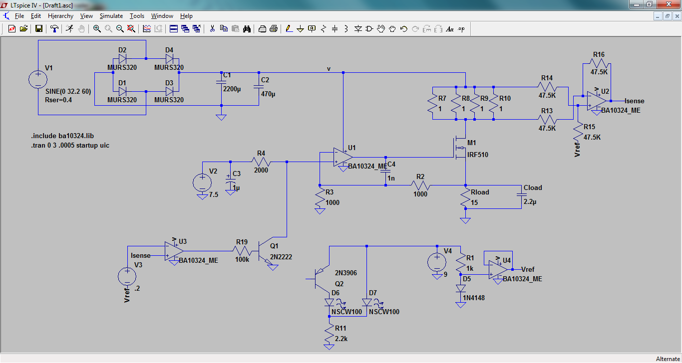

    I measured 0.42V on the base. With the output set to 18V, the base voltage increases to 0.6V, but no voltage is dropped across R4. Before I made post 33, it seemed to work properly and the voltage at the base of Q1 was 0V until the current limit was reached.

      Looking at Video part 2 (@32:37 and on) and part 3 sch @ 00:56 and compared to your circuit (post 8) is not the same, you built your own LT3080 which I am not even sure if it will work like the LT or not.
      As you can see in the SCH, the set pin has two 1K resistor with transistor connected in the junction of the two resistors and operate in linear mode (13:35 part 3, those two resistors are also part of the V set feedback circuit.
      Right now that Q1 is in either on or off as instead of in linear mode to put the circuit into the constant current mode and maintains the set current.
      Your Q1 act like shutdown, see page 17, also see typical application circuits.

              I wasn't trying to copy the circuit of any voltage regulator. I don't see how to get Q1 into linear mode.
              Originally posted by ben7
              Could you make a diagram of the circuit you have now? (Since it has changed ... or has it?)
              It's a even bigger mess than the last circuit.
              V4 is actually the 9V regulator, while V2 and V3 are potentiometers connected to the output of the regulator. I will eventually have something connected to Q2 to turn on that LED. D6 is red and D7 is green.
              If I put the shunt in series with ground, I could get rid of the second reference, but the output voltage would drop slightly as the load increases.

                For some reason, swapping the inputs of U3 and replacing the transistor with a diode causes it to stop oscillating. However, the voltage will only go down to about 1.1V in constant current mode in LTspice, so that isn't a very good solution.
