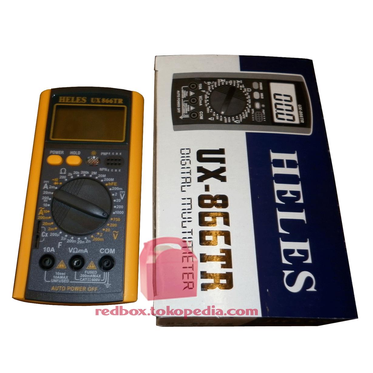

      Re: Different between analog VOM with DVM on testing transistor or mosfet
      my cheap DVM like this. So the conclusion is 3V enough to test transistor and diode except power mosfet? I don't know that diode test mode have a constant current source, got a new knowledge again thanks . The suck thing from this DVM is 10A range probe didn't have any fuse just a thick wire on it..LOL
      on small Ampere probe it just have NTC if i am not wrong reading from manual.
      I have try to open it and it looks like small MOV on PC power supply with some number on it, and the thick SUCK wire.
        The thick wire is the current shunt, it drops about 10mV per amp (0.01 ohm shunt.) Even expensive meters have this. But they are usually fused.
        Be very careful with unfused range. If you accidentally put that across the mains, an explosion is possible. That thick shunt can very quickly become an explosion of molten metal, if the building is not correctly protected against such faults. You would not want to be holding onto the meter if this happened.
        It's crazy really that they don't bother to fuse the 10A range. I have seen UNI-T recently using BS1363 fuses. This is a good idea IMHO, because the 13 amp ones are rated for high interrupt current and are suitable for mains use up to around 250V. Plus they're cheap, like less than £0.10 (~$0.15) each in quantity, so they don't add much to the meter's cost.
        I wouldn't use a BS1363 on a commercial circuit, but I wouldn't feel in danger if I were testing household mains. Luckily my meter uses HRC fuses.. but they cost about £5 each... I have been very careful not to blow any!

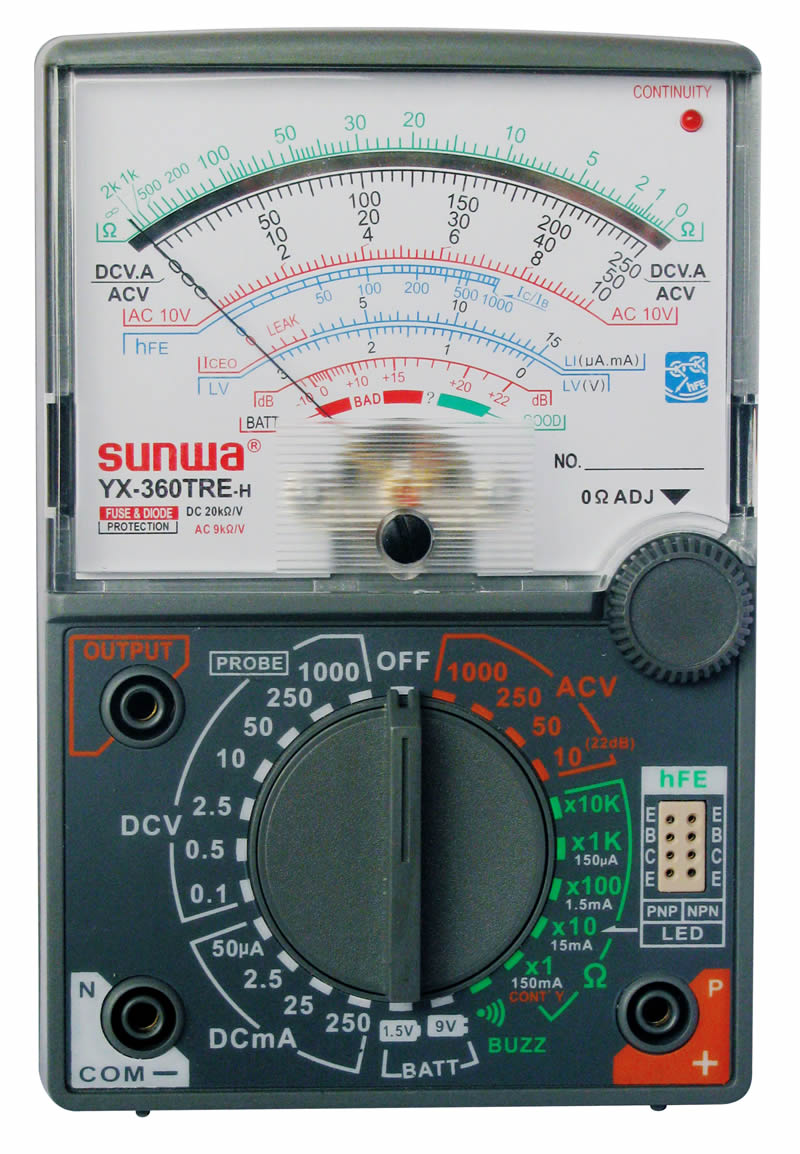

                        • senz_90
                          • Aug 2013
                          Originally posted by eccerr0r
                          Weird... I just measured my analog meter in resistance mode:
                          Rx1 - measuring 0 ohms, it passes about 120mA (uses D-cell only)
                          Rx100- measuring 0 ohms, it passes about 1.2mA (also uses D-cell only)
                          Rx10K - measured around 65 microamperes?!?! (uses D-cell and 4xAA)
                          Trying to measure a 1W LED, only the Rx10K (expectedly) was able to light the LED. And I'm surprised the probes are actually correct (though resistance doesn't matter, measuring diodes it would be nice if the red probe is the current source and black the sink, when measuring resistance, just to know which is which.
                          I've only seen one analog meter so far that was hooked up backwards...
                          As I know, analog VOM is common to have reverse polarity probes. red is negative and black is positive. Rx10k is supply 12VDC as I know, but I never measure the current. From my VOM label, didn't Rx1 have a greater current than Rx10k?
                          Btw anyone ever use this tester?
                          http://www.electronickits.com/kit/co...eas/dt100k.htm
                          is this good?

                          • eccerr0r
                            Solder Sloth
                            • Nov 2012
                            • 8707
                            is this good?
                            Yes, 120mA in Rx1 is three orders of magnitude larger than the 65uA used in Rx10k.
                            I haven't had way too many analog VOMs to check, I remember my dad's VOM was wired in reverse as well as my AW-Sperry miniature analog VOM (that uses a single AA battery for its lone Rx1K mode). The Eico 555 is actually correct for whatever reason.
                            What kind of battery supplies 12VDC in your analog VOM? The Eico uses a D-cell and four AAAs. I suspect the AAA's will die drying out before its energy expended at 65uA.
                            • senz_90
                              • Aug 2013
                              • 328
                              • Indonesia
                              For big VOM is use PP3 9V battery and 2 AA (each 1.5V). Rx1, Rx10, Rx1k produce 3VDC output and Rx10k is 12VDC. Anyone using this analog VOM on my town and it is popural here.
                              For the small one it is just use a single AA battery inside.
                              Maybe I will try to measure the current. I think my VOM couldn't make a motor run when set to Rx10k instead Rx1.
                              "There is no shortcut to be successful. No pain, no gain."
                              Best Regards
                              Rudi
                              Thank You

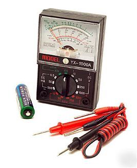

                              • eccerr0r
                                Solder Sloth
                                • Nov 2012
                                • 8707
                                The current pass seems very in line with my 50-year old Eico 555 with only 3 resistance modes. At Rx1 stage I think both of these analog meters should be able to turn a small hobby motor. I was just wondering how it got 12V, but 9V+2x1.5V is pretty normal. Reason why I asked is my dad's VOM had a custom battery in it, and I don't recall what it was. It apparently was also the sole battery in the design for Rx1 to Rx10K unlike the Eico that uses different batteries for different modes.
                                I think my small VOM is probably the same or a clone of the one you have... Not sure who was the OEM though, probably a lot of clones floating around.
                                • SM-Piyes90
                                  • Feb 2014
                                  • 120
                                  • Morocco
                                  The original brand is SANWA ( japanese brand ) , replica is sunwa like senz's one .
                                  • eccerr0r
                                    Solder Sloth
                                    • Nov 2012
                                    • 8707
                                    The small one I have is an AW Sperry brand SP-5A. I never thought of it as a clone of something else but it could be, no clue. Other than its size and limited scales, it works fine... just need better probes...
