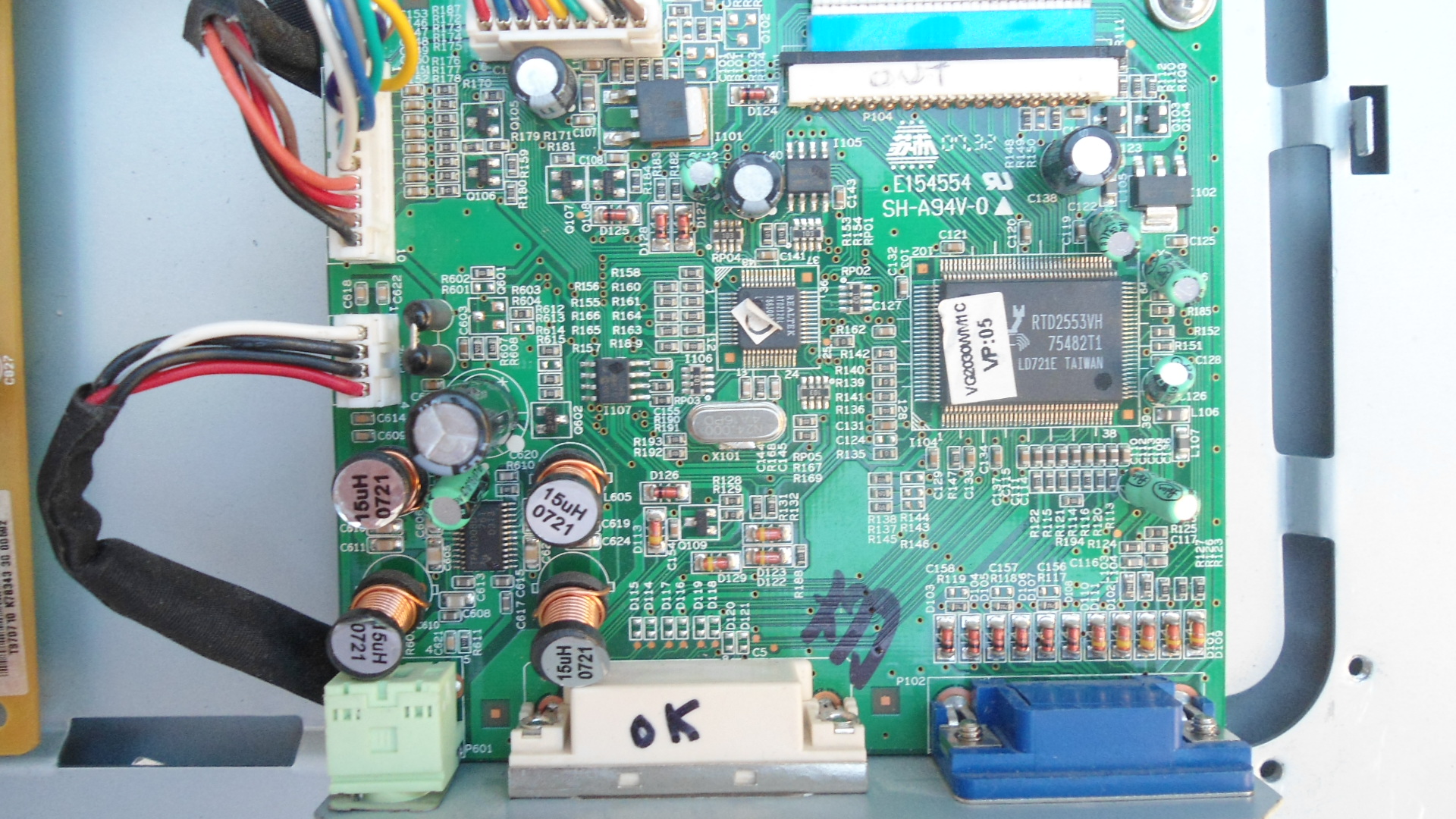

    what is this component? i searched the web and can not find its description.
    its on the logic/main board for a viewsonic 2030wm monitor that goes off at high resolution.
    please help

    Can you post a picture of this component and the board it is on?
    I found a schematic for a VG2030m that may help if it is close to the model you have.

      1.8V LDO regulator?

        Re: 7c9l17-18l regulator?
        its on the main/logic board( thats what i call it)its probably a different name.
        but here are some pictures of it ,bud suggested a 1.8 v regulator.
          here its the picture of the board

            I located and attached the service manual for a ViewSonic VG2030wm monitor.
            The main board has a 1.8 volt LDO regulator which is labeled I102. Is that the component you are looking for? It is located on page 43 of the attached PDF file.
            The schematic labels I102 as AP1117CY_1.8 and I did find voltage regulators by searching "1117CY".
            Edit: The bill of materials list I102 as an AIC1117A-18PY.
              thank you t30m31,
              not wonder i couldnt find it !!
              that 7c9l17 number its what's printed on the component.
              and its totally different from ap1117cy.
              is this what a lot of you guys call the 1117 series?
              i am going to go over the squematic and try to find what and how was this ckt affected by the caps.
              thanks for your help and effort,its well appreciated.
                Yes, 1117 series. See post 6 for calculator and 7, 8 if you need them from Digikey.
