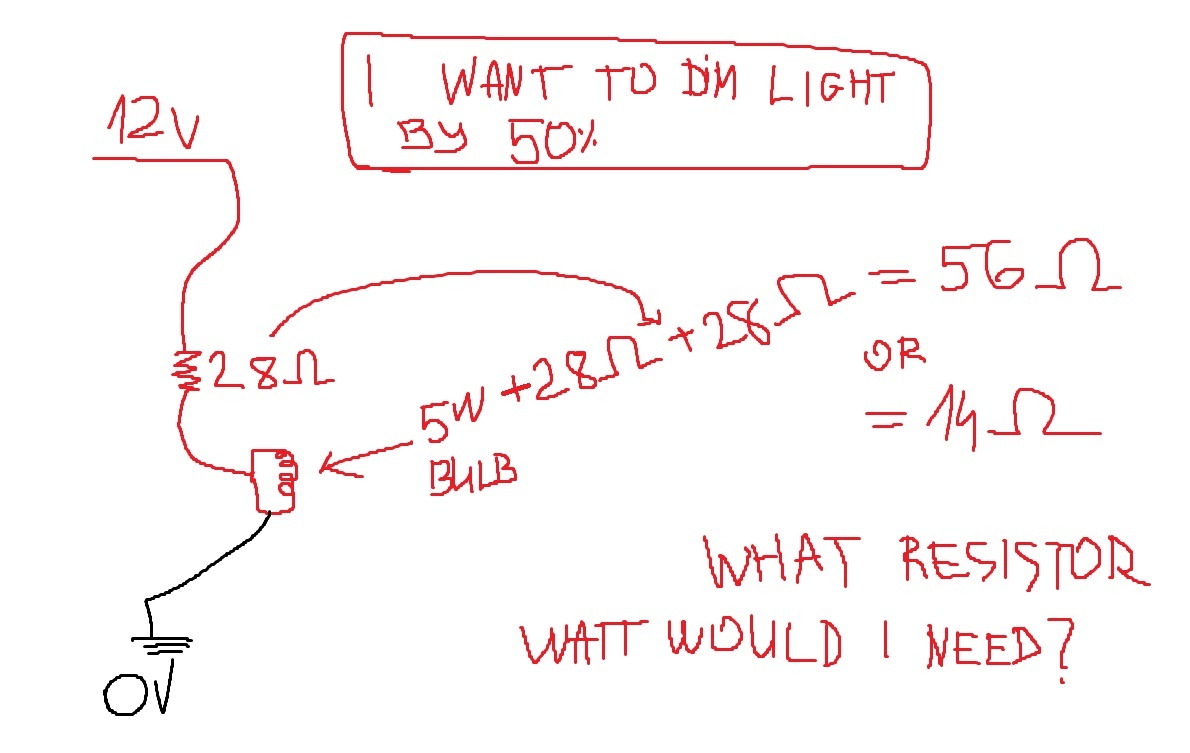

    I want to dim light bulb by 50% I want to learn how to calculate it on my own
    I have a 5W lamp on 12Volts battery, I want it to be half as bright, so I will add a resistor. What resistor should I supply?
    A = W = 5 = 0.416mA
    _ _
    V 12
    R = V = 12 = 28.84 Ohms (R) this is resistance of lamp
    _ _____
    I 0.416
    So I will add one resistor 28.84 Ohms
    I will have 28.84 + 28.84 = 57.6 Ohms
    Or 28.84 + 28.84 = 14.42 Ohms
    I don't know if it will work in series or in parallel
    voltage would be 6V and amp current mA = 0.208mA We divide everything by two
    W= V * I = 6 * 0.208 = 1.248Watts resistor would be needed and 28.84 Ohms
    Is my calculation correct? And I need explanation why its divided by two I'm little confused
    Your calculations are correct...
    The approximate resistance of light bulb will indeed be: P = V^2 / R... or R = V^2 / P = 12^2 / 5 = 144 / 5 = 28.8 Ohms.
    But here is where you got tricked: you probably assumed that if you use a 28.8 Ohm resistor in series with the bulb, the voltage going to the bulb will be divided in half (6V), which is CORRECT. However, the power usage of the bulb will not be divided in half...
    For pure resistive components, dropping the voltage in HALF (1/2) means their power usage will go down to a QUARTER - i.e. 1/4 of what it was.
    What's interesting is that you even found this with your own calculations, which showed that the bulb will be using 1.248 Watts, which is CORRECT again, as 1.25 Watts is 1/4 of 5 Watts.
    Now, to make the bulb use only HALF of its rated power (i.e. 2.5 Watts), you can use this formula P = I^2 * R, where we use 2.5 Watts for P and 28.8 Ohms for R to get the current, I, going through the bulb. So...
    I = sqrt(P / R )... or = (P / R )^0.5 = (2.5 / 28.8)^0.5 = (0.086805555)^0.5 = 0.29463 Amps
    Next, we calculate the voltage across the bulb with this current flowing through it. To do that, we simply use V = I * R = 0.29463 * 28.8 = 8.49 Volts
    Now, we still don't know the value of the resistance of the resistor to use, but we do know it has to pass approximately 0.295 Amps through it and there must be 12 - 8.49 = 3.51 Volts across it.
    So to get the value of the resistor we need, the following equation can be used again: R = V / I = 3.51 / 0.295 = 11.9 Ohms ... If you don't care to be driving the light bulb at *exactly* half of its rated power, then you can go up or down a bit on that resistance, so you can have an easier time finding a standard value resistor. In your case, both a 10 Ohm or a 12 Ohm resistor will give reasonably close results.
    But we are not done yet! There's one more calculation: to see how much power (heat) the resistor will dissipate. If you pick a resistor with too low of a power rating, it will burn out quickly.
    Here's how we calculate the power rating of the resistor: we already know the current going through it and we know its resistance (about 12 Ohms, so let's go with a 12 Ohm standard value).
    P = I^2 * R = 0.295^2 * 12 = 1.04 Watts .... so a 2 or a 3 Watt -rated resistor will be good to go (it will still run a little hot, though.)
    On the other hand, if you use a 10 Ohm resistor, you can't really use the above equation anymore, since the current won't be 0.295 Amps anymore. It will be a bit higher. But that's easy to calculate now:
    I = V / R = 12 / ( 10 + 28.8) = 12 / 38.8 = 0.3093 Amps
    The bulb will then use about P = I^2 * R = 0.3093^2 * 28.8 = 2.76 Watts
    And the 10 Ohm resistor will be dissipating about P = I^2 * R = 0.3093^2 * 10 = 0.95666 Watts... so a 2 or 3-Watt rated resistor will be needed again so it doesn't run as hot.
    Hope that was enough math for you for the day.

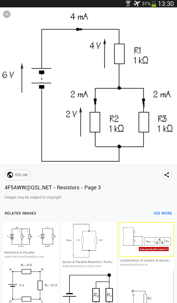

      https://ohmslawcalculator.com/voltag...der-calculator
      https://ohmslawcalculator.com/ohms-law-calculator
      By this calculator it seems like I calculated well and that resistor needs to be put in is indeed 28~ Ohms...Two resistors in parallel in fact so I have 14.4 Ohms~
      And about watts it would be
      Ampers = Watts = 5 = 0.83miliAmps
      _____ _
      Voltage 6
      Watts = Voltage * I (Ampers) = 6 * 0.83 = 4.98 watts
      So my resistors needs to be two resistors in parallel 28.8 Ohms each, which would give me 14.4 Ohms resistance and I need 5 watts resistors to be able to take this current... Need confirmation

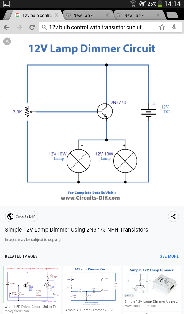

              • 31294
              pwm control
              you can make a circuit with an 8pin chip and a mosfet or just buy a module designed for 12v motor/fan control from aliexpress for a $
              if you want to make one, the chip i would use is a 555 - read the datasheet to see how usefull it is!
              if you use a 555 and a fet you wont be burning lots of energy as heat, the circuit will just be switching the lamp very fast to control the brightness.

                  If the heat of resistors is not a problem, you can build a simple resistor network to experimentaly adjust needed value, and able to set it precisely, example in attachment. Do not use potenciometer if not rated for this aplication, or you are not sure about outcome.
                  The circuit with transistor (on heatsink) allow you to use ordinary low power potenciometer to control brightness, I guess that you want analog solution...

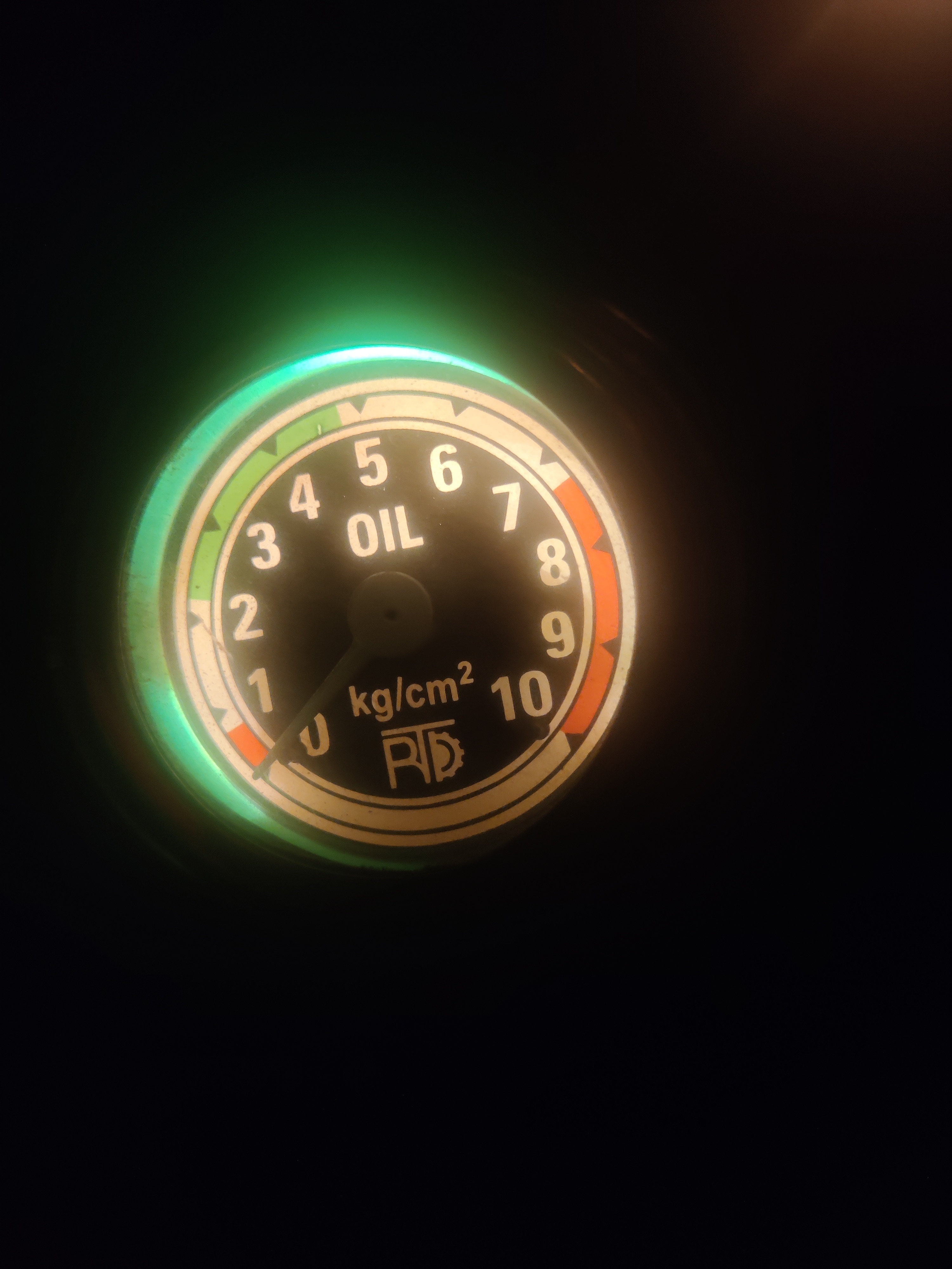

                    Well I actually wanted to make this bulb dimmer, its shining into eyes during night, its on tractor vehicle, I thought that adding some sort of resistor would do the job, since bulb is sealed inside, I didn't wanted to take it apart and to put smaller one inside, but once it dies I will do it
                      • 31294
                      if its for a vehicle, just get a ReoStat
                      go to a scrapyard and you can find them on most old (older than 80's) cars
